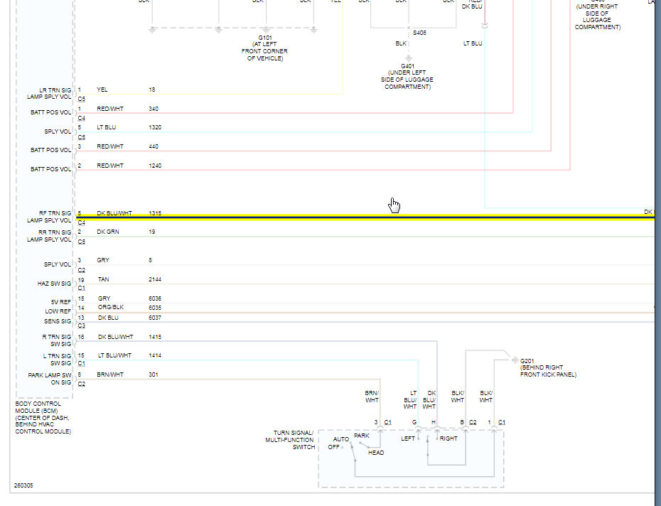

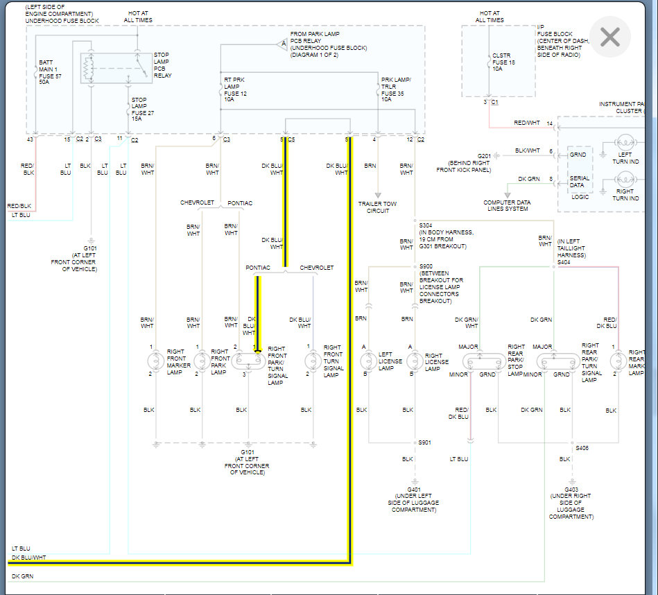

My right turn signal will not work. I have checked all fuses and bulbs. Hazard like all work. I have even tried replacing the complete turn signal switch and it still won’t work. Could the clock spring have something to do with it?
Apr 11, 2021 at 6:00 PM
  • CAR REPAIR CONTRIBUTOR

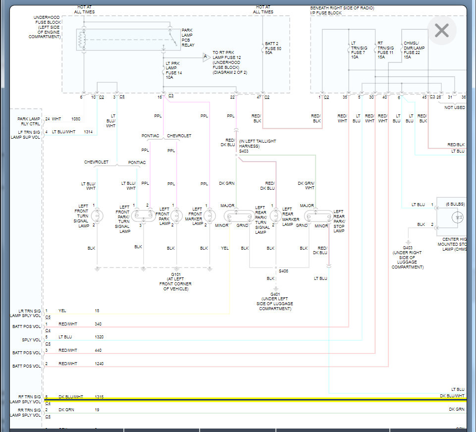

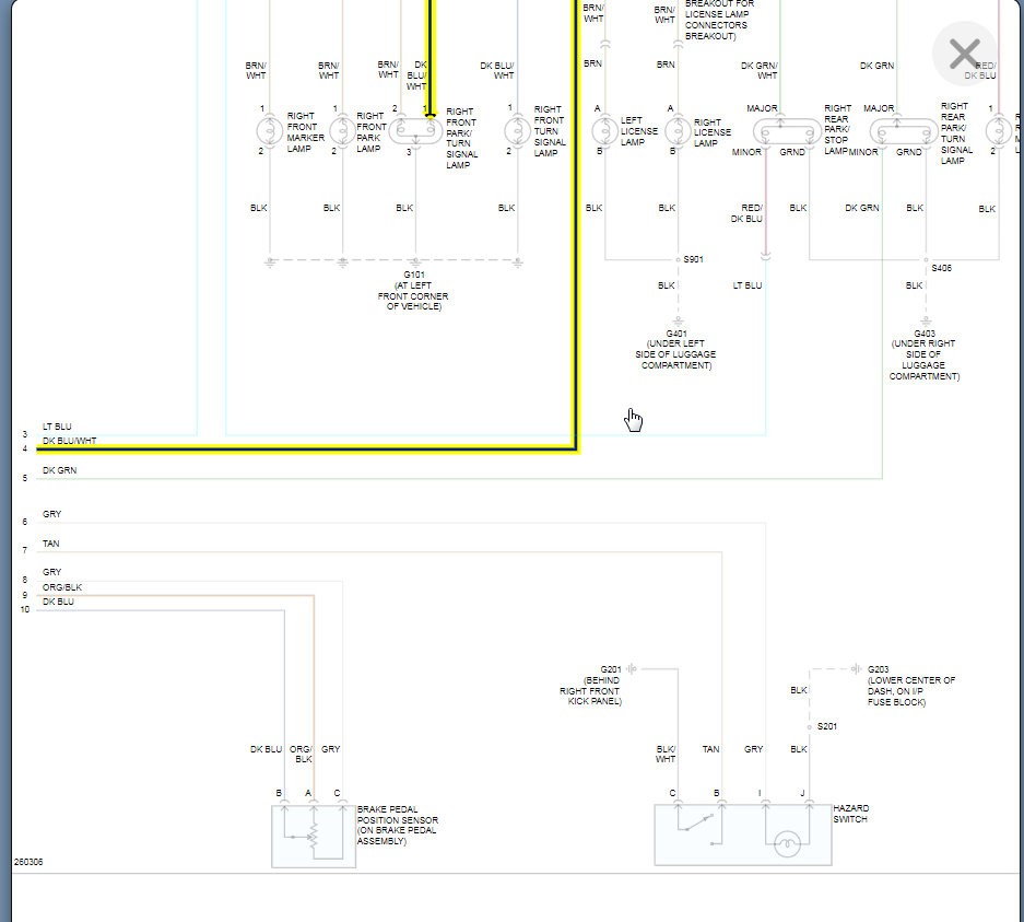

More then likely you have an issue with the BCM. I would suggest checking the voltage coming from the BCM on the wire that is highlighted in the wiring diagram below.

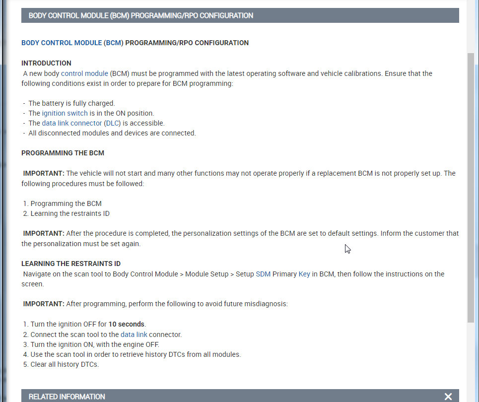

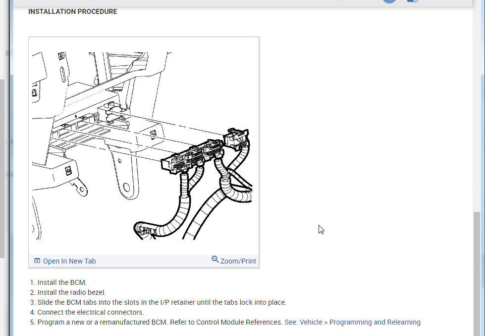

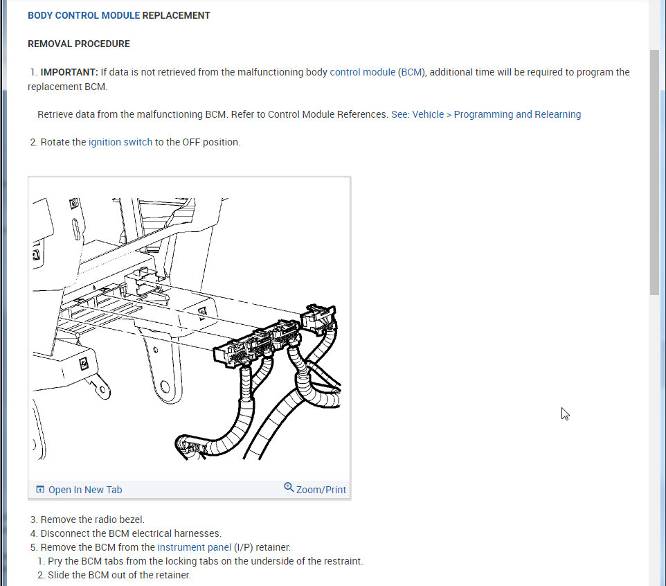

Please let us know what you find with this when the turn signal is on. However, I included the replacement instructions on the BCM if this proves out.
Please let us know what questions you have. Thanks
