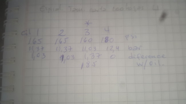

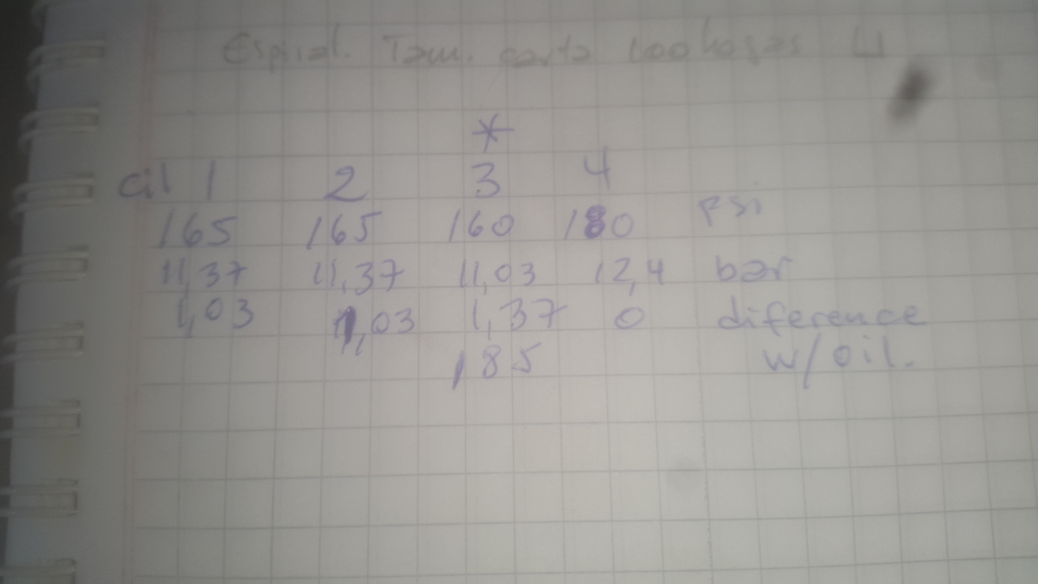

Hi.
These are my results.
In cylinder number three I have the lowest reading so I added a little oil and with this went up.
Tuesday, February 13th, 2018 AT 2:22 PM
KEN L
  • MASTER CERTIFIED MECHANIC
  • 55,469 POSTS
Compression is not the problem I am starting to lean toward a bad fuel injector. I would remove them to do a manual test.

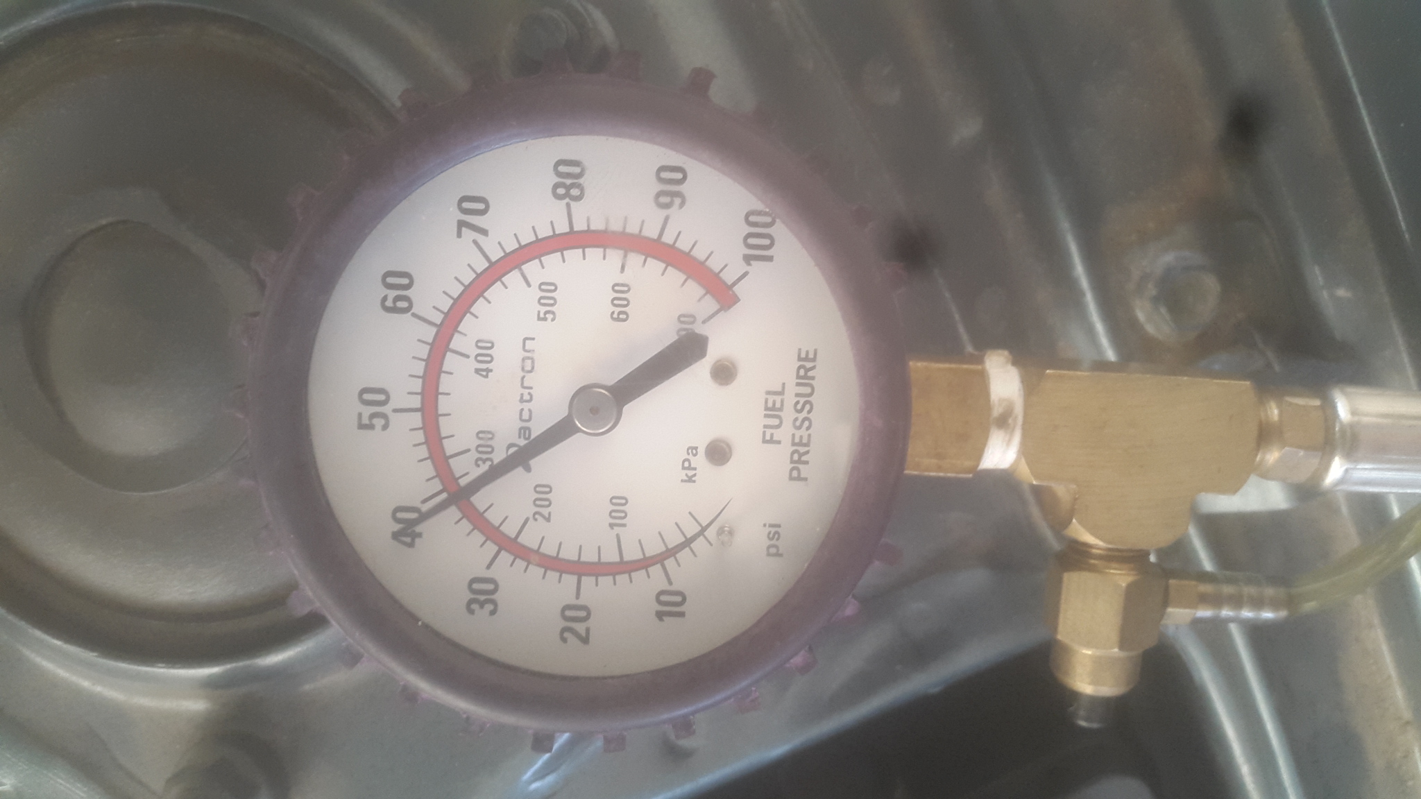

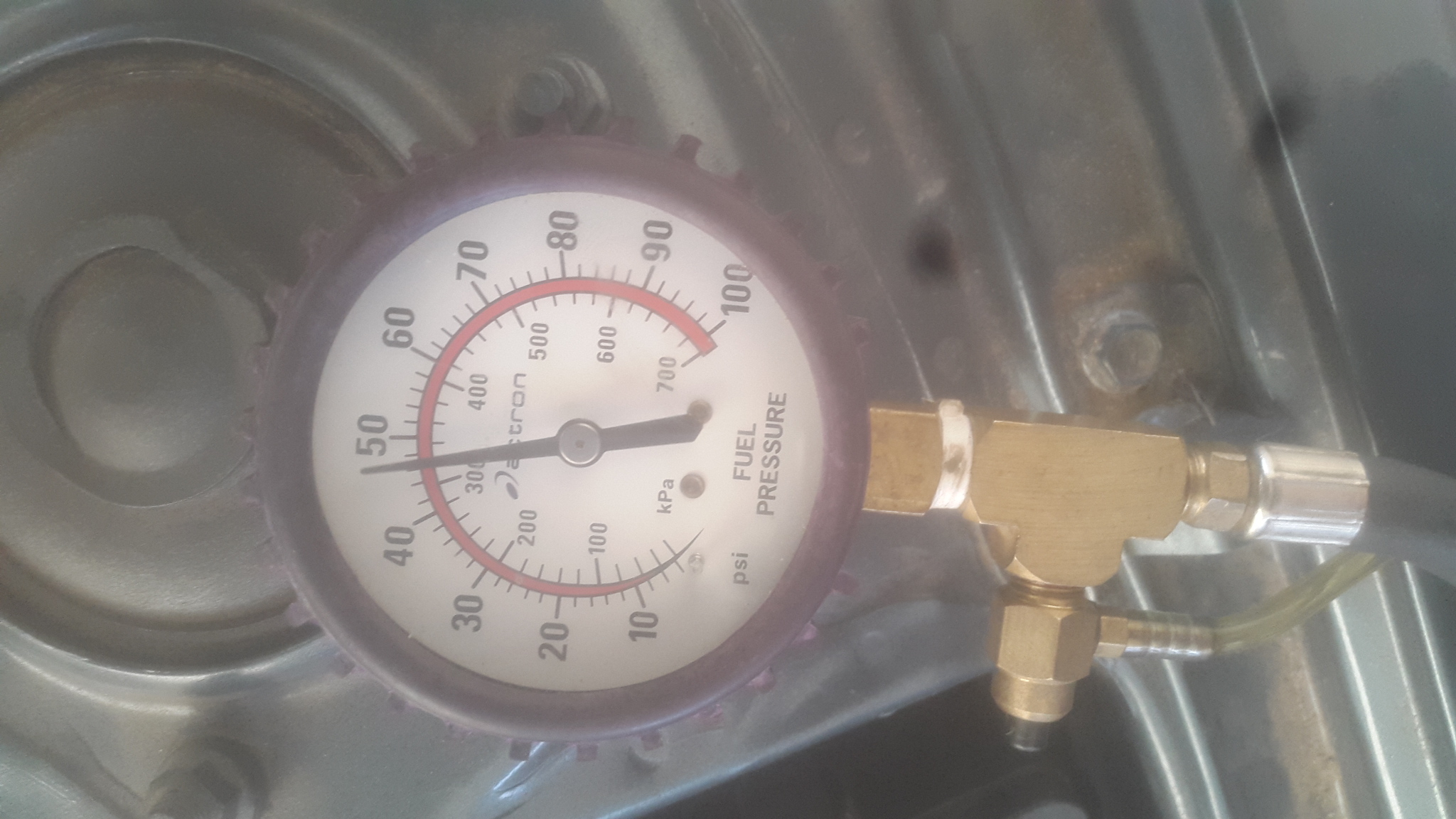

Check the injectors according to the guide. They seem to be working normally. However, perform a pressure test on the injection system, the results are: Pressure w / vacuum 38 to 40 psi (nominal, according to manual 33 to 38 psi); without vacuum 48 psi (nominal, according to manual, around 42 psi). In addition, after turning off the engine, the pressure gradually falls to zero in less than 1 minute, this should be maintained at least 1.5 kg / cm2 after 5 minutes. I tried to throttle the return hose but it still does not maintain the indicated pressure.
Wednesday, February 14th, 2018 AT 4:19 PM
KEN L
  • 55,469 POSTS
The fuel pressure is not the problem. I am starting to elan toward a broken oil control piston ring. How does the engine seem to run?
