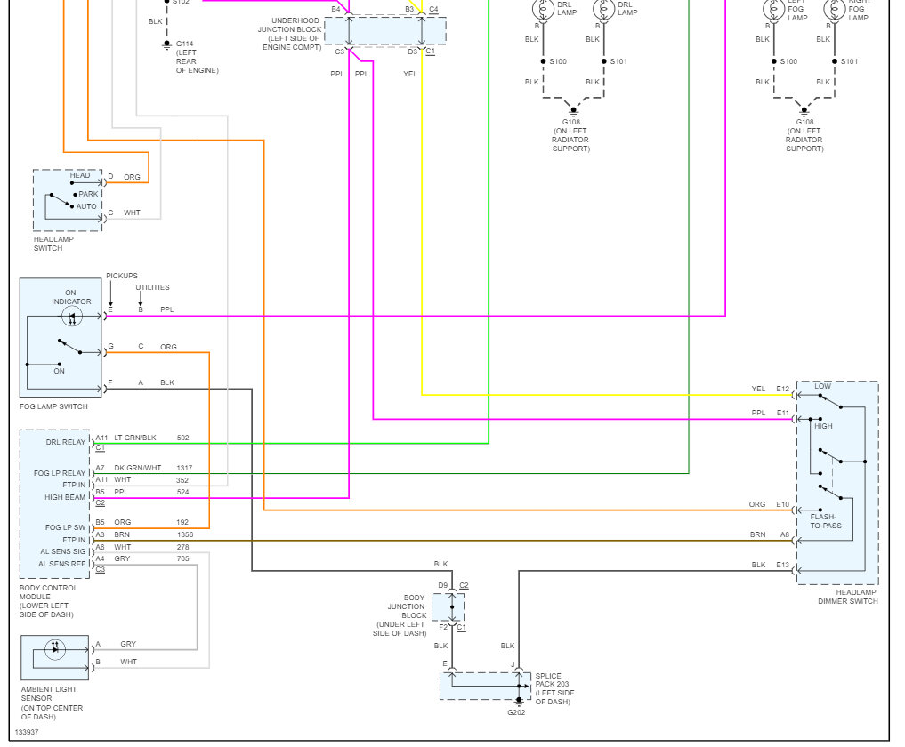

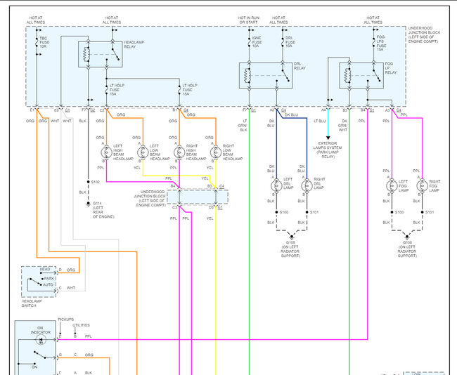

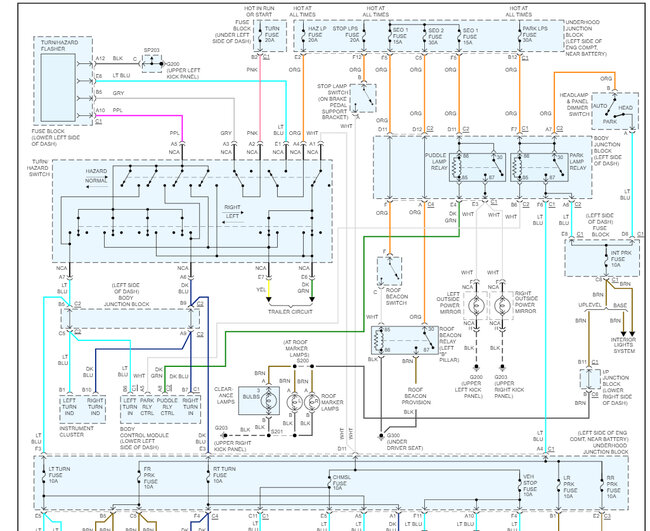

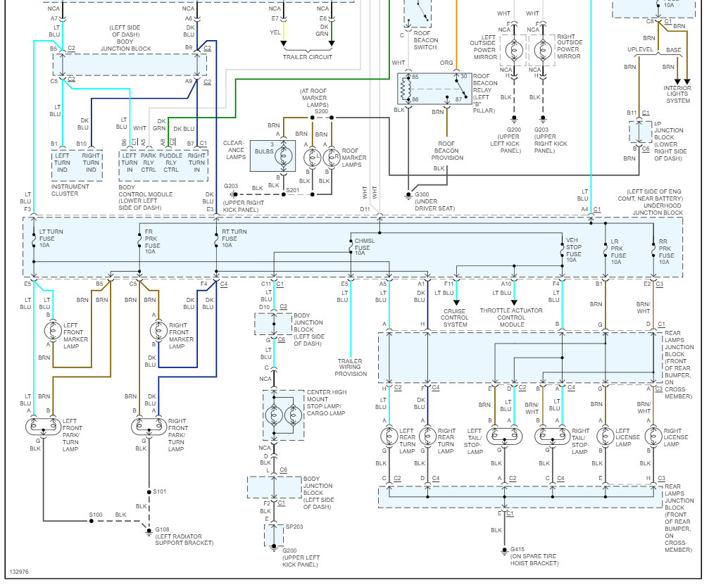

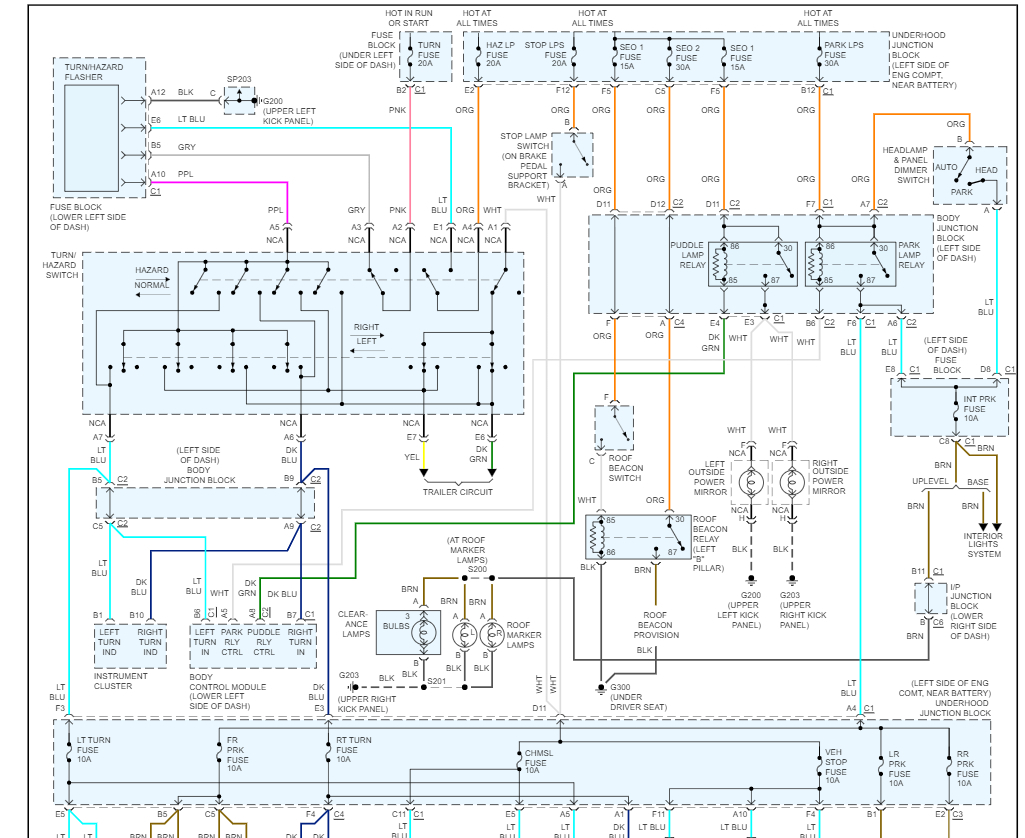

Rewiring a blinker and headlight switches and all exterior lighting.
Tuesday, May 2nd, 2023 AT 9:52 AM
KEN L
MASTER CERTIFIED MECHANIC
55,538 POSTS
Yep, good job, here are the wiring diagrams and a guide to help you with the repair:
The first wiring diagram is for the headlights and the second is for the exterior lights. Check out the images (below). Please let us know what happens.
