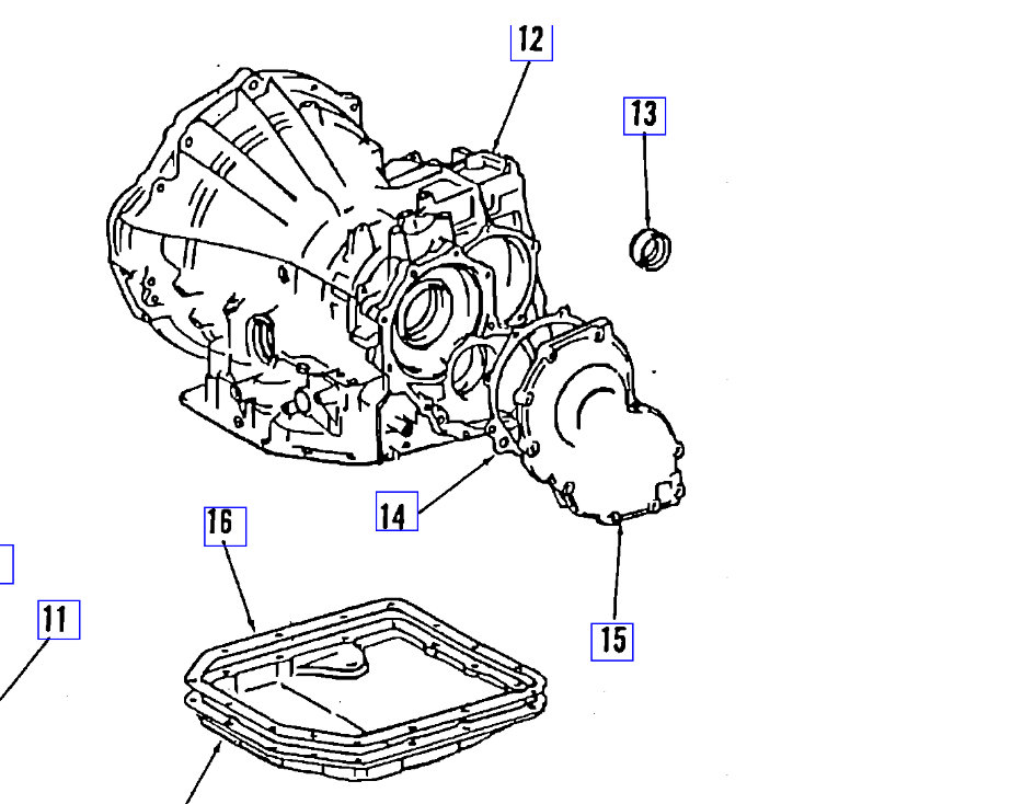

My car it is facing reverse gear problem.In the morning the car goes in reverse gear but if it kept in. Cold about a hour reverse gear don't work.it needs to run in forward about 5 Km then the reverse works again and if reverse works for a time it always work until rest of more than 1 hour.so in cold it doesn't work but in garage morning it works and in hot or running also work. so please help me that what I can do.

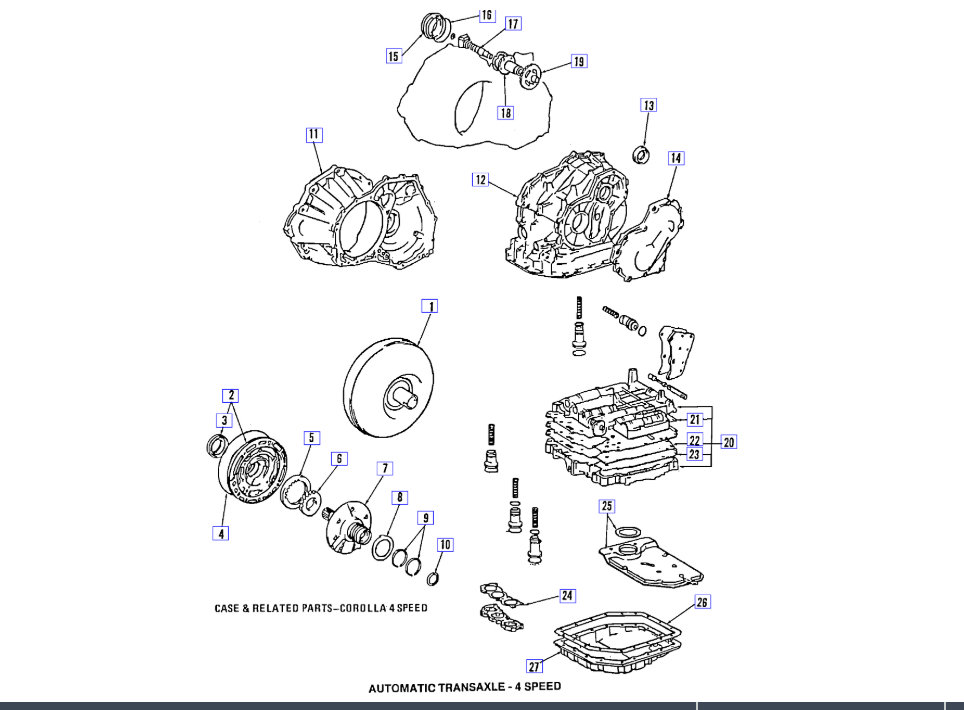

It could be dirty or contaminated transmission fluid. have the transmission serviced and add automatic transmission conditioner additive. Drop the transmission pan and clean the valve body and transmission fluid filter screen with parts cleaner. I am attaching repair guide below for you to refer to. Let us know if you need and more information.
