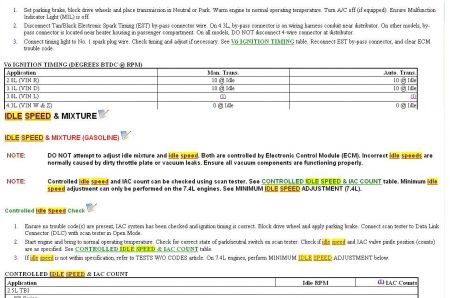

https://www.2carpros.com/forum/automotive_pictures/99387_silverado1_1.jpg
Thursday, February 18th, 2021 AT 1:04 PM (Merged)
JOSH71411
  • 15 POSTS
I appreciate the pic but I kinda cant see it all is there anyway for me to see the other half thanks
-1
