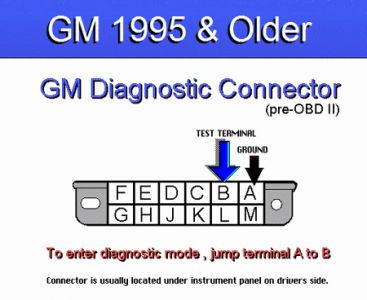

Is the SES light on? If yes pull the codes, but check the EGR for sticking open, and the Idle air control, it's bolted to the side of the throttlebody. A badly clogged filter might cause it...
https://images.2carpros.com/forum/automotive_pictures/62217_95_OlderGM_2.jpg
Check codes this way, jump these two connections at the ADL, turn the key to "ON" then count the flashes. a 22 will count as 2 flashes a short pause the 2 flashes, if more than one code is stored, the pause is noticably longer between codes! The codes will flash 3 times! Write them down and post them here...

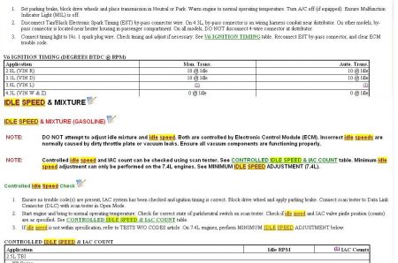

ok well i see i need to get a different iac i bought an idle air control valve from oreillys that has only been in the truck a few weeks but right after i put it in there were still no improvements what name brand iac should i get and again tell me how to set it once i get one also i want to tell u exactly what its doing. In the morning or after the truck has been sitting a while i go to crank it up and it does not idle rough as long as the motors cool even if the air is on and its in gear and you turn the wheels there is no stuble and no rough idle once the motor heats up to normal operating temp the truck starts to idle rough sitting still at a light and if u slightly turn the wheel the idle drops and the truck trys to stall and shakes real bad then after the idle drops it will surge up and then back down to a rough idle it also makes the motor feel like it is missing but its not a miss because i have changed all of the igniton components so thats exactly what it does its the most aggrivating problem i have ever run across please reply back
Feb 18, 2021 at 1:04 PM (Merged)
BMRFIXIT
  • CAR REPAIR CONTRIBUTOR
  • 19,053 POSTS
https://images.2carpros.com/forum/automotive_pictures/99387_silverado1_1.jpg
JOSH71411
  • 15 POSTS
i appreciate the pic but i kinda cant see it all is there anyway for me to see the other half thanks
JOSH71411
  • 15 POSTS
good news i fixed the missing problem and most of the stalling problem when the wheel is turned i took the iac out which was factory preset and screwed the valve in which immediately fixed the problem when i started it back up and let it warm up but i still have the steering problem but i think it is in the actual power steering here is what it does if your in park with air on and u turn the wheel without foot on the brake its usually fine if its in gear its usually also fine but if the brake is applied and u turn the wheel the wheel wants to lock and u have to let off of the brake for it to unlock but the power steering is NOT in full lock position therefore i have reason to believe it might be the power steering pump getting weak or the steering gear locking up when the wheel is turned but i dont see what that has to do with the brakes thanks for helping fix one problem just one more left =)
