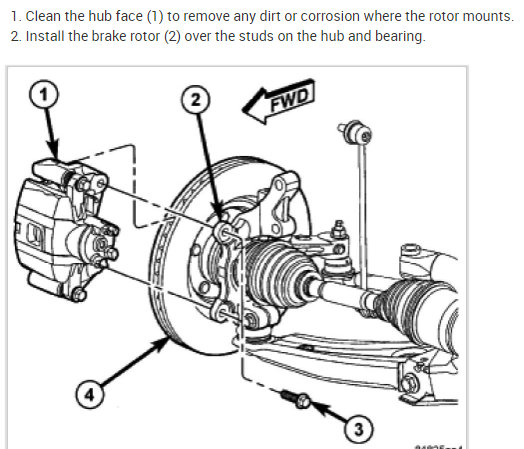

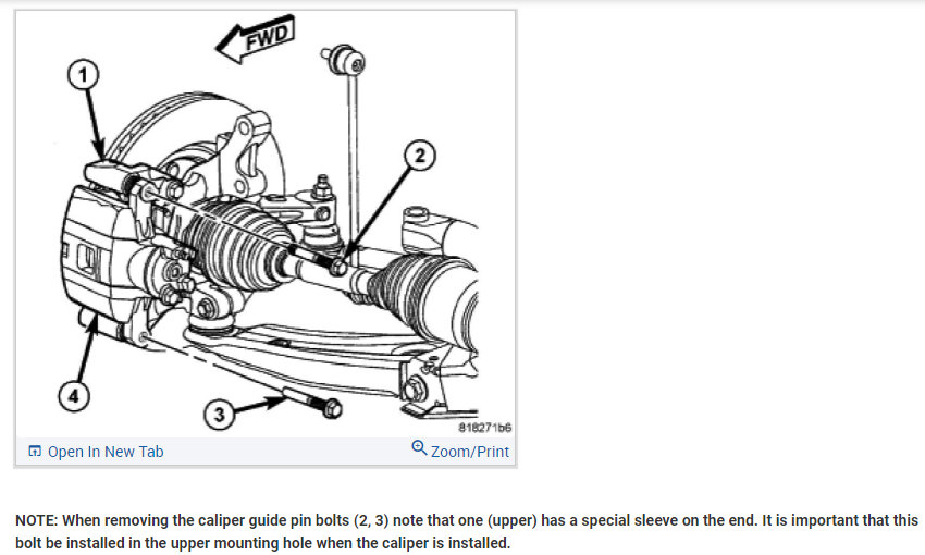

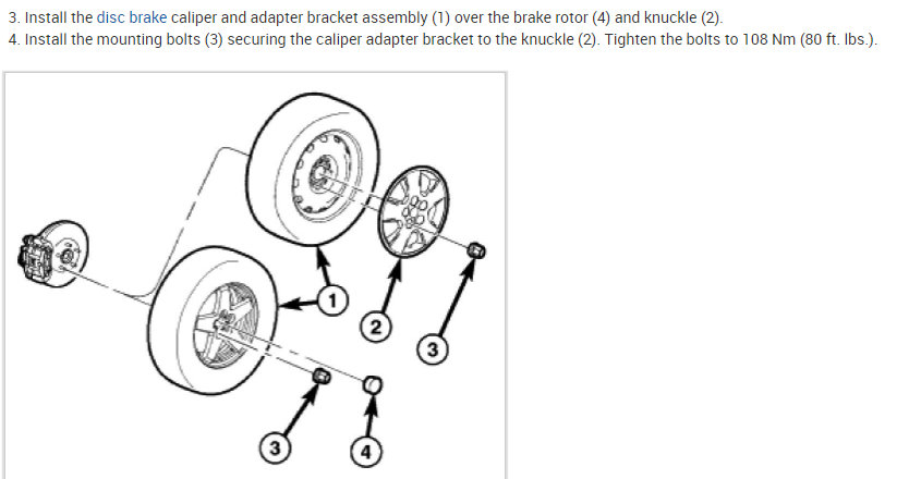

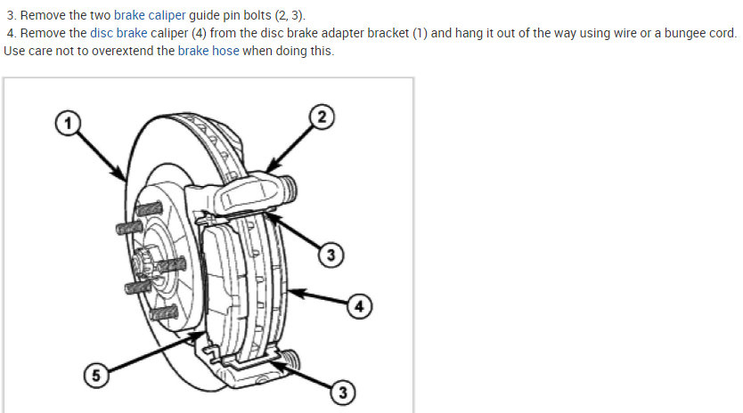

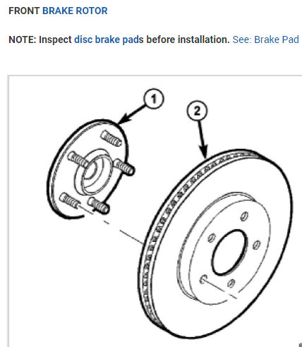

After a few days my front end started pulsating when I was stopping. So I need new rotors and pads. I want to know how tight the center nut will have to be torqued after I install the new rotor?
Thank you, Gary
Sep 26, 2014 at 2:22 PM
DANNY L
  • CAR REPAIR CONTRIBUTOR
  • 5,648 POSTS
Hello, I'm Danny.

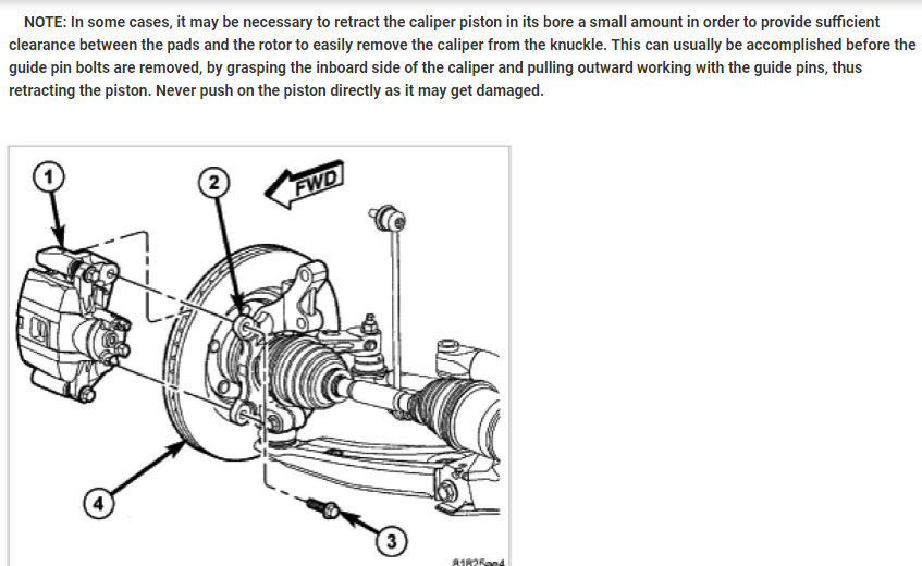

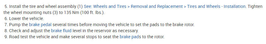

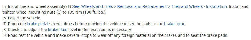

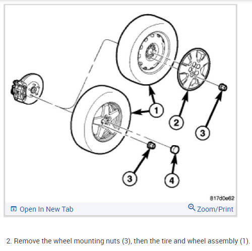

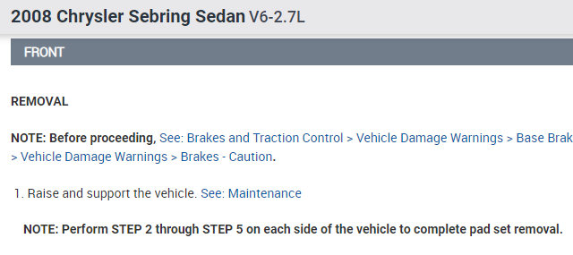

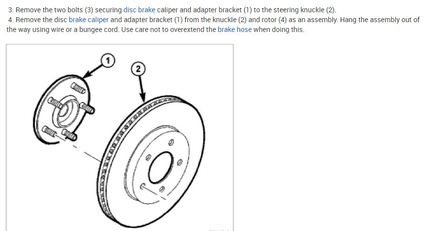

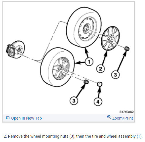

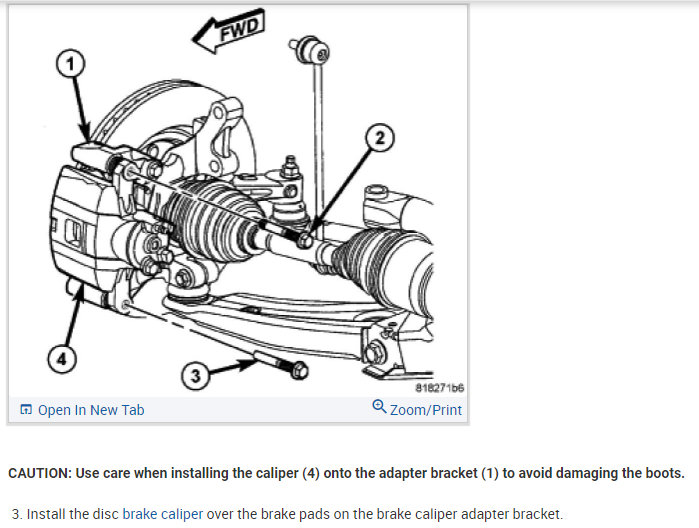

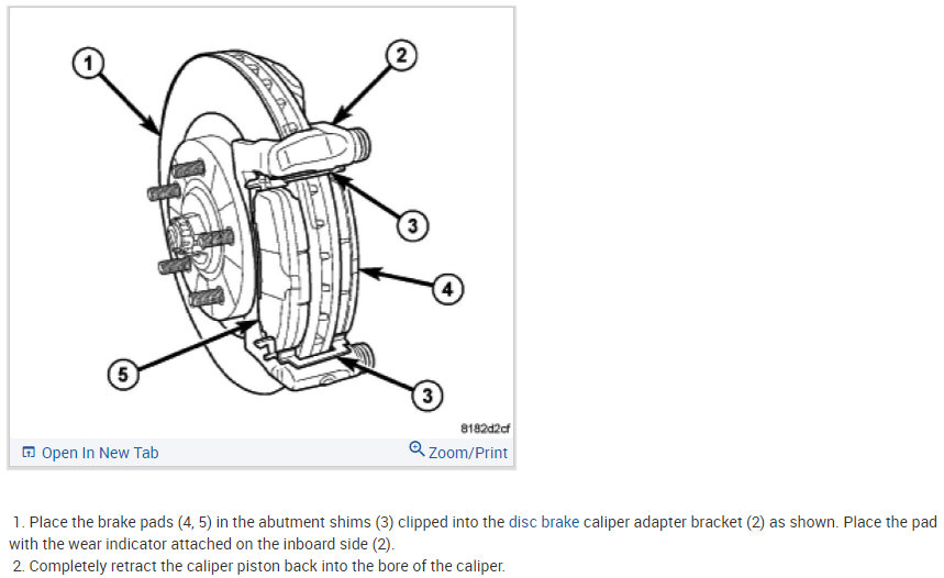

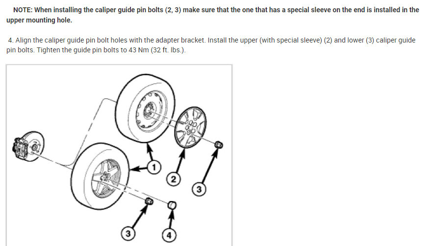

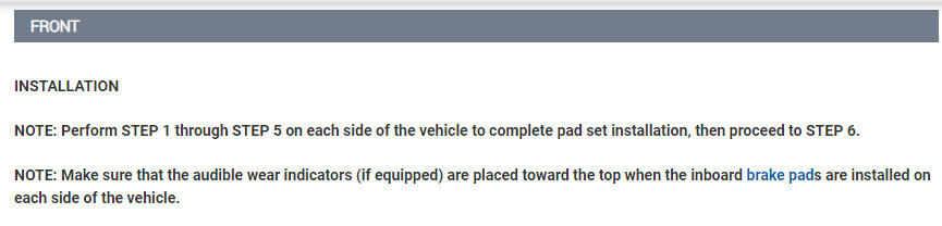

Here is the information you requested. The installation steps also include the torque specifications. This is a tutorial showing what is involved on how to change front brake pads and brake rotors:
I've attached picture steps below on how to change the front brake pads and rotors on your car. Hope this helps and thanks for using 2CarPros.
