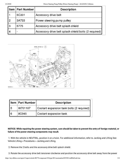

The top pulley or sprocket in the serpentine belt system is wobbly and moves loosely in and out. It needs to be replaced. How do take it off?

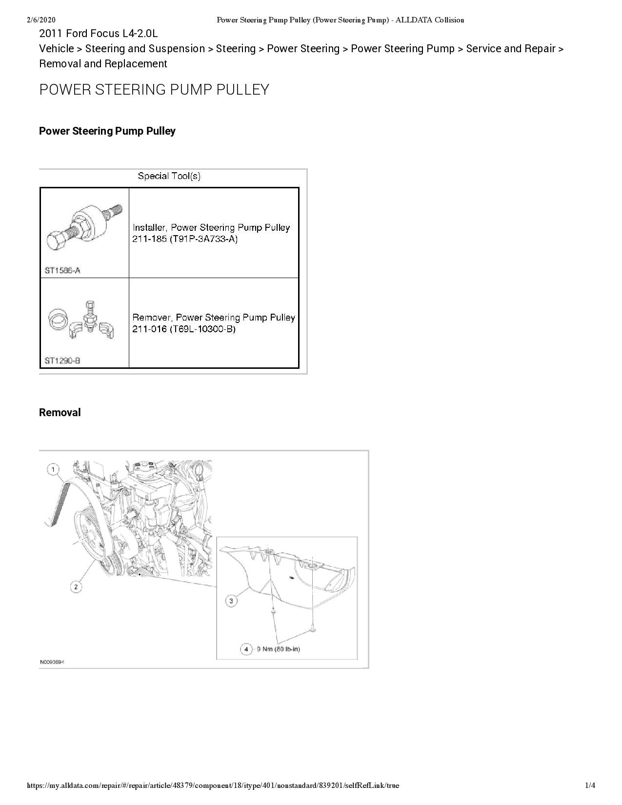

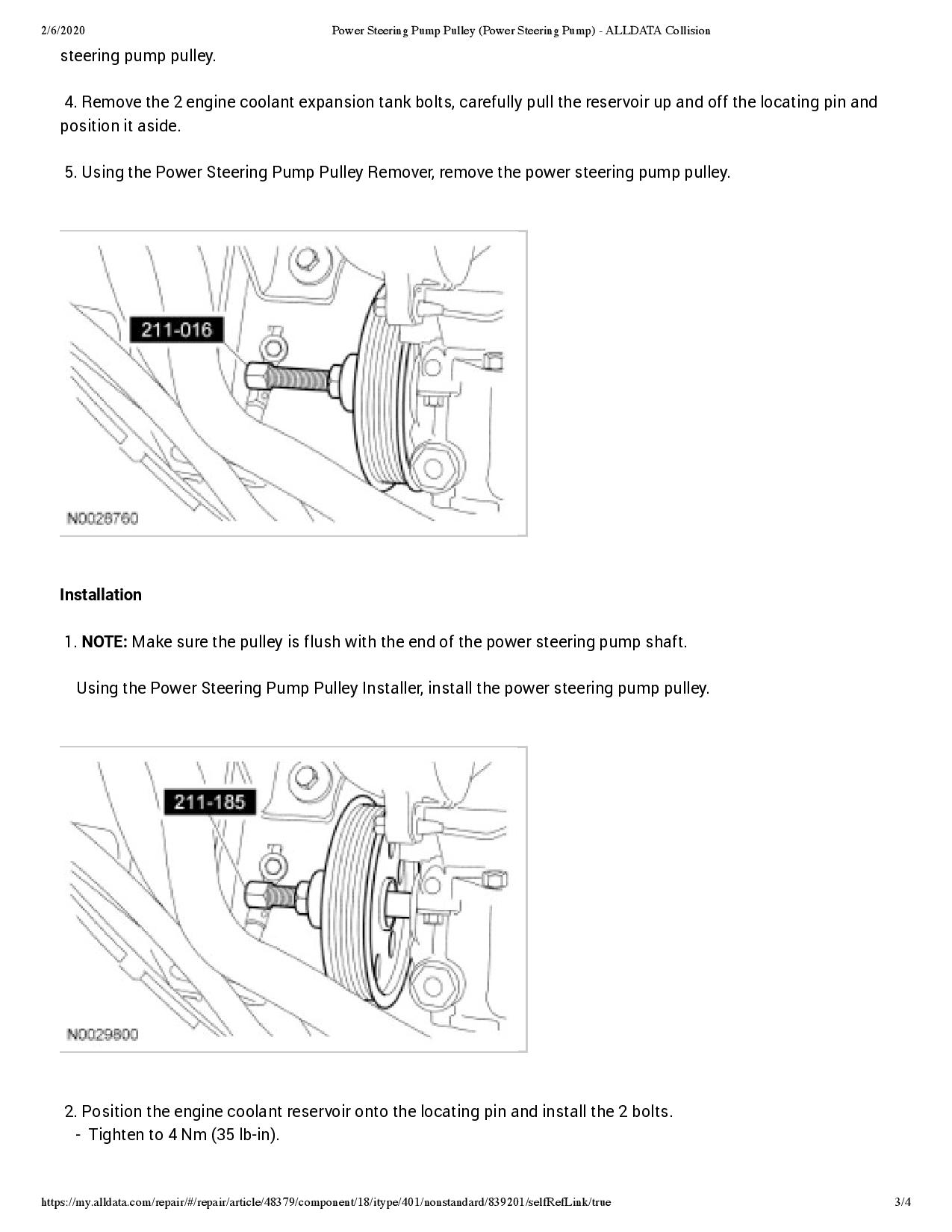

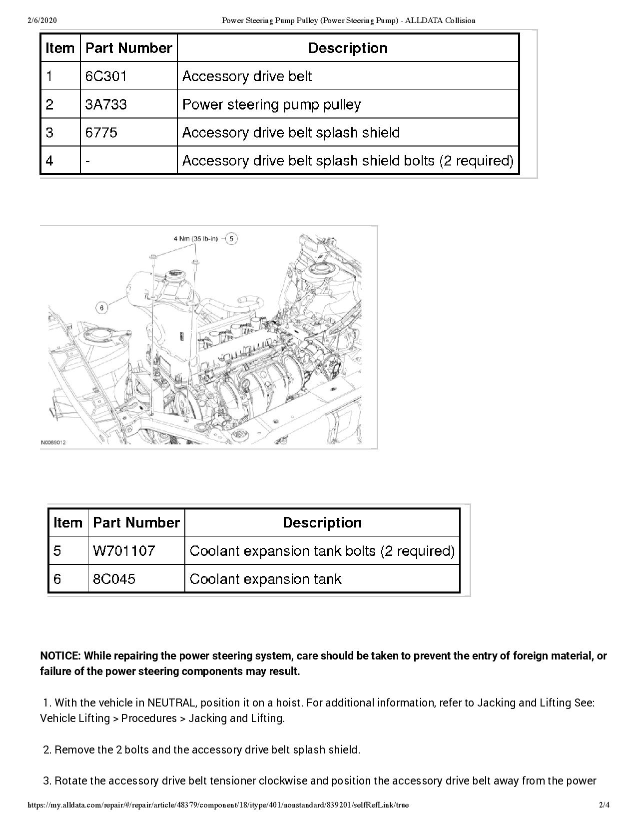

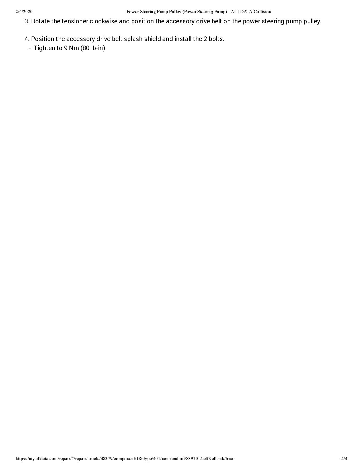

Hey GARYJA8,
I have attached the instructions for replacing the power steering pulley on your vehicle below.
Before replacing I would advise checking if the play is in the pulley, ie the pulley is loose on the shaft/the pulley is out of shape, or that the power steering pump shaft has play and is causing the wobble you are experiencing. It may be that you require a new PAS pump and not a new pulley.
Let me know if you have any further questions.
Regards, Joe

I agree! I think you are having pump issues!
