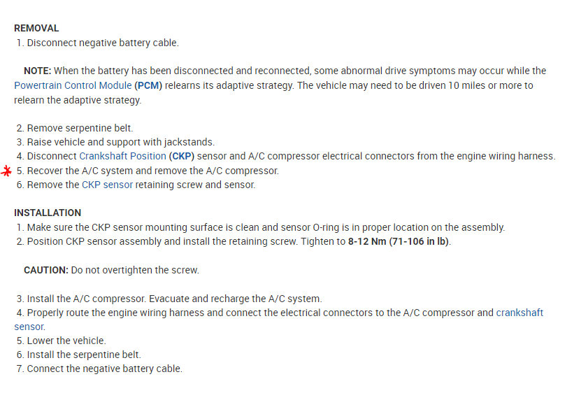

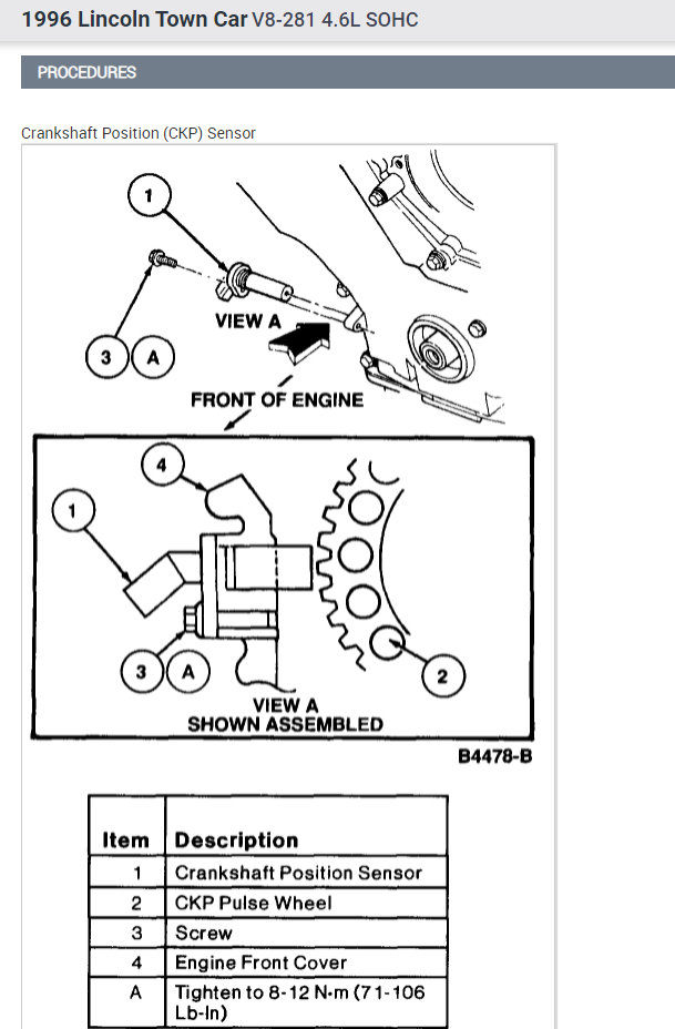

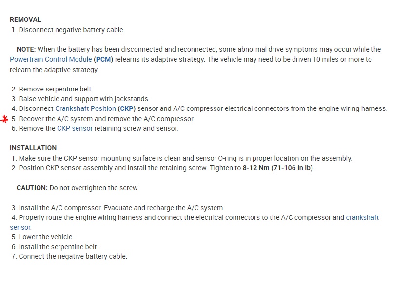

Do I remove the A/C to replace crankshaft position sensor
on the car listed above (1995)?

Yes, on this vehicle, in order to replace the crankshaft position sensor, you will have to remove the ac compressor.
I have attached the replacement procedure for your reference.
