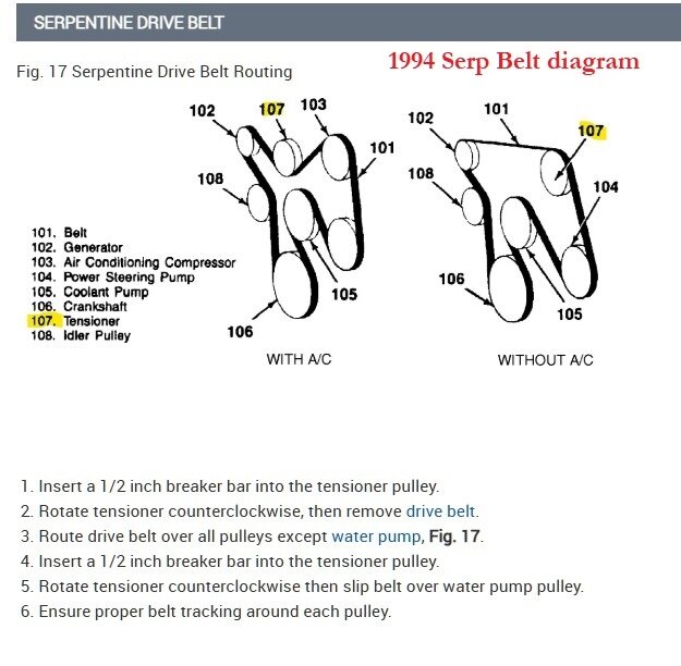

What size is the socket i need to use with my socket wrench to move the belt tensioner do i can get my serpentine belt back on?
Mar 12, 2025 at 5:46 PM
AL514
  • 5,541 POSTS

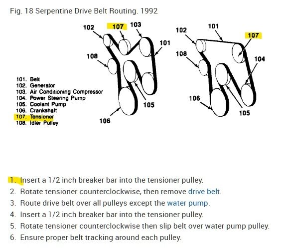

Hello, this is what service info is showing for the 1993 and also for a 1994. It lists using a 1/2in bar inserted into the tensioner to remove/install the Serpentine Belt.
Here is a guide to help:
