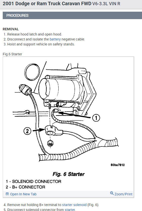

what length and thread pattern do I need for the bolts that mount the starter to the engine block
Sep 7, 2021 at 3:14 PM
SQM
  • 6,383 POSTS

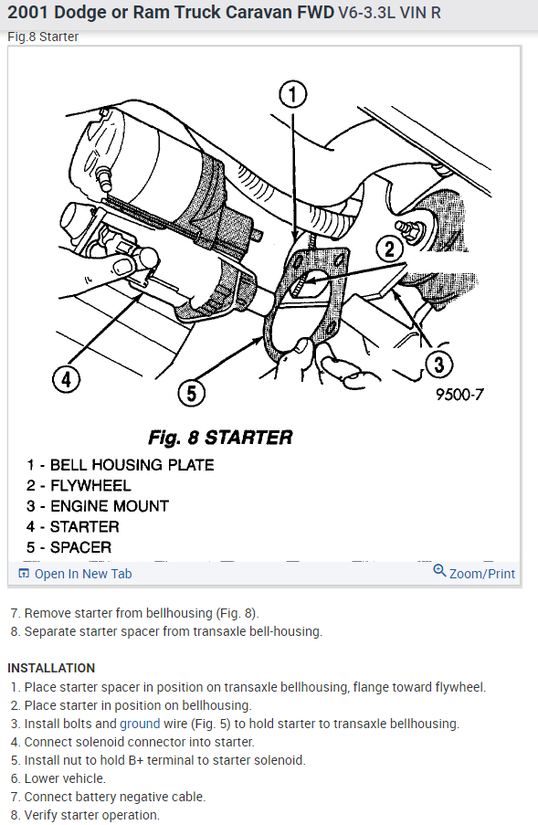

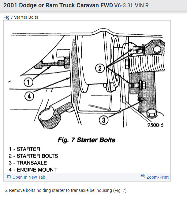

These vehicles uses M10 x 1.5 in 50 mm length. Depending on the replacement starter it may or may not need shims.
Typically you will be able to get the replacement bolts your local auto parts store. Most place will be able to look it up by the make and model.
