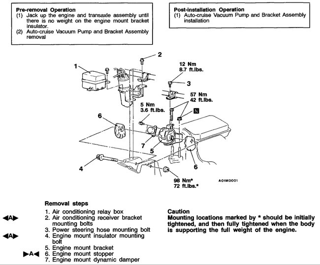

My car is front wheel drive. Could you please provide me with the step-by-step instructions for removing and replacing the motor mount for my car listed above? Thank you

Two door coupe or four door sedan? Which mount(s) are you changing, the front mount, rear mount or the side mount? The front and rear mounts are really simple. You need a way to support the engine while you do the work. I normally use a top side support as it is a lot easier. Once you have it secured you just remove the bolt that goes through the mount and the two bolts that secure the mount to the chassis. The end mounts are almost as easy.
