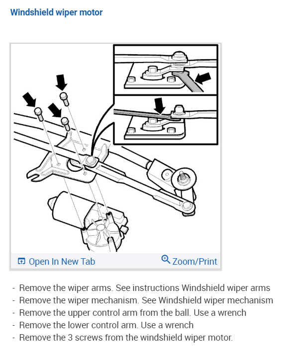

Front wiper does not work. Need instructions on how to replace wiper motor.
Jan 7, 2018 at 12:35 PM
STEVE W.
  • 15,172 POSTS

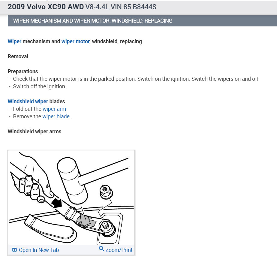

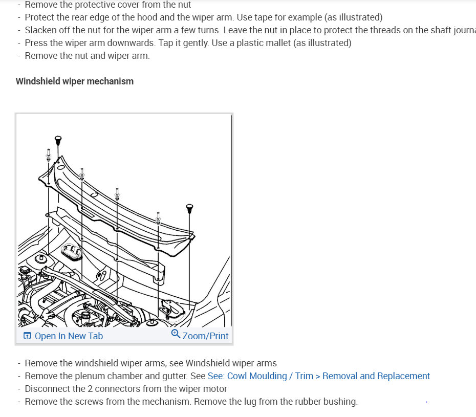

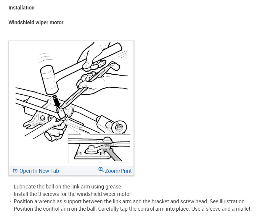

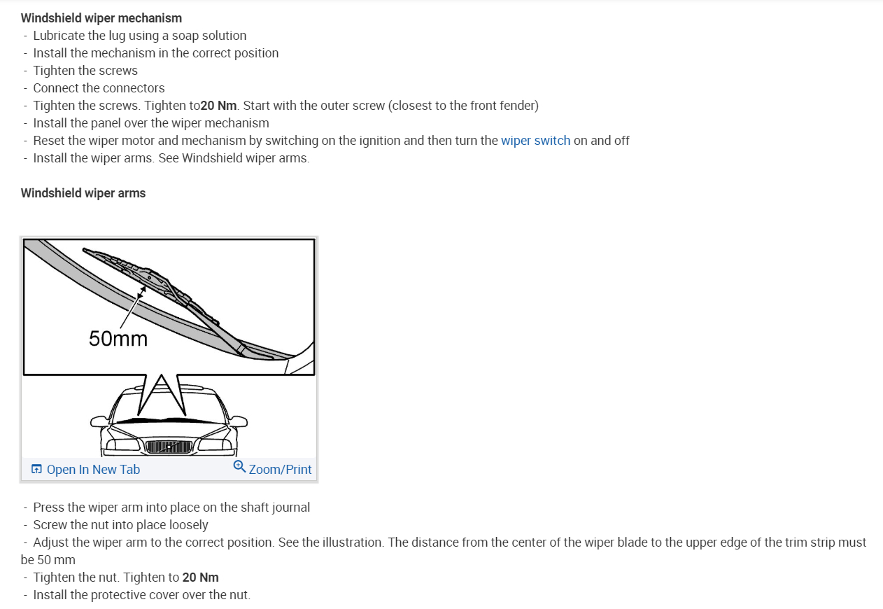

Have you checked the fuses and switch to be sure they are not the problem? Here are the wiper motor replacement instructions in the diagrams below. Check out the diagrams (Below). Please let us know if you need anything else to get the problem fixed.
