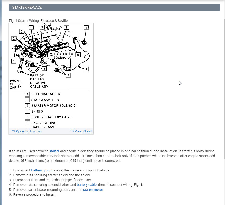

I am just having difficulty on how I should go about removing the starter to my car. it is in a very tight area and I'm wondering if there's an easier way to get to it instead of removing the exhaust from the engine.
May 3, 2020 at 5:57 PM
  • CAR REPAIR CONTRIBUTOR

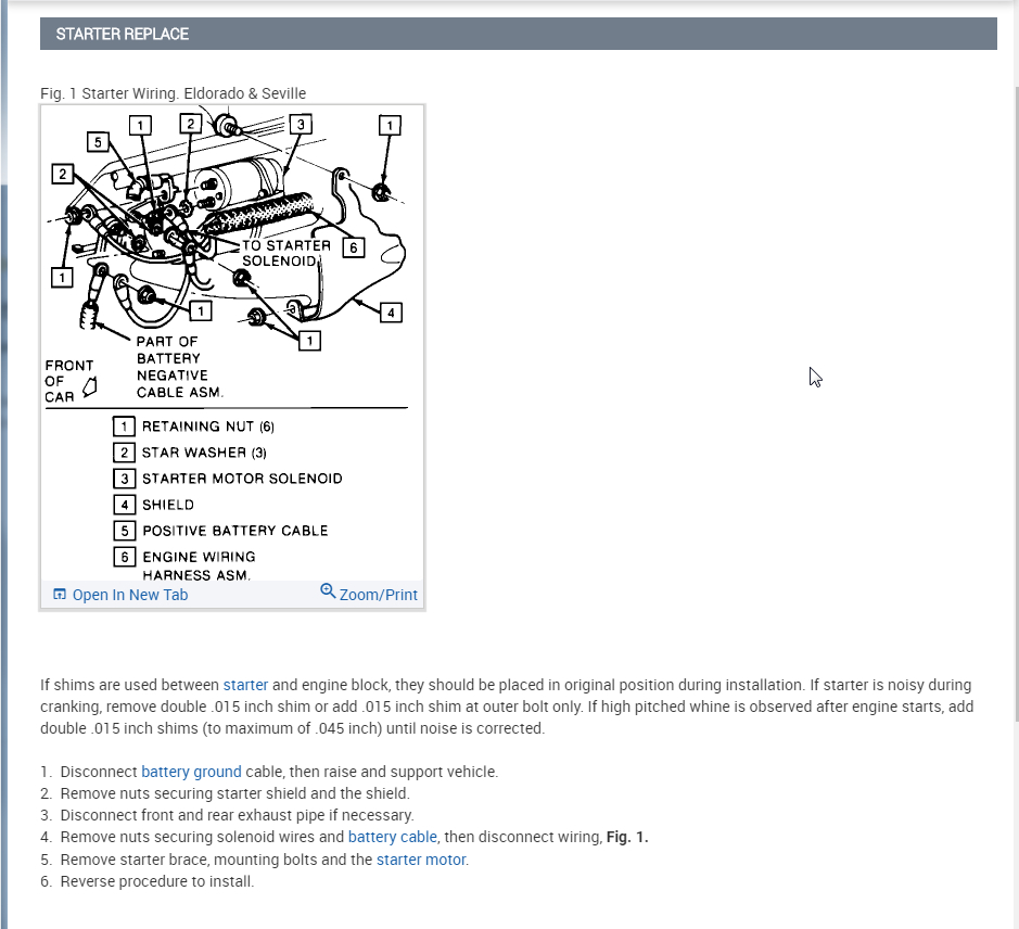

I attached the service manual info. They are not very detailed but they do mention removing the front and rear exhaust pipes which will give room. I looked online for short cuts because I have not done a starter on this vehicle but did not find anything. So unless you see an easier way when looking at, I suspect the exhaust needs to come out.
This guide can help walk you through the steps:
Sorry I didn't have a better answer for you. Let us know if you find a better way then what is laid out here. Thanks

No you are fine. I kind of figured the exhaust needed to come out, it was worth a try. Thanks!
