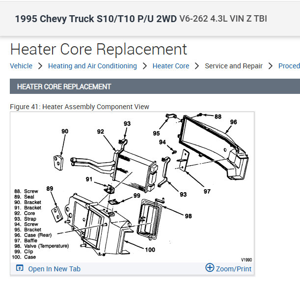

Did coolant flush changed the thermostat at no heat lukewarm truck gets to 160 to 170. On cold days 195 after driving for a while but when heat goes on it drops down to 170 again hoses are warm but not hot heat going to change water pump and heater core need step by step on heater core.

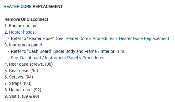

The idea that the engine temp lowers with the heater on and the hoses only get warm is odd. Based on the hose temperature, it sounds like there is a restriction slowing the flow down. I'm not sure why that would cause the engine to cool.
I attached the directions below from my manual. Additionally, here is a link that explains the general process. I'm adding this because the manual is somewhat vague.
https://www.2carpros.com/articles/replace-heater-core
When you flushed the heater core, did the water go through it easily or did it seem to be restricted?
Let me know and let me know if this helps.

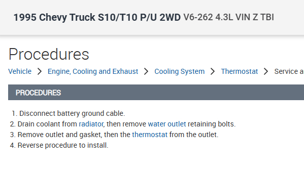

If that is the case, the core isn't the problem. It sounds like the coolant thermostat is opening too soon and delaying the warm-up time.
Have you replaced the thermostat? If not, that is absolutely where I would start.
Here is a link that explains how in general it is replaced:
Note, it appears that the thermostat used is different between TBI fuel Injection and CPI. Make sure you get the correct one.
Here are the OEM part numbers based on the fuel system used.
TBI === 10190925
CPI === 24505924
Taka care,
See pic below.
