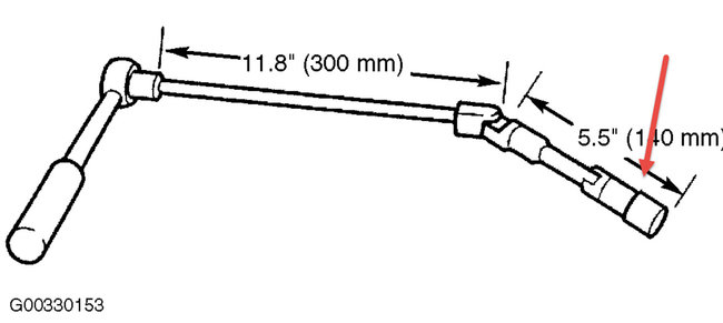

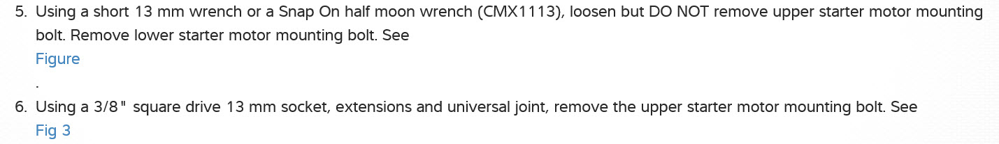

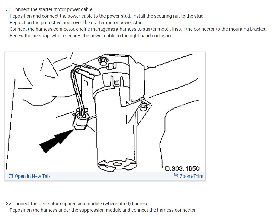

I can't get to top bolt. I took off bottom bolt

See pics for explanation if you have a worn 3/8" flex head socket may help instead. Check out the diagrams (Below). Let us know what happens and please upload pictures or videos of the problem.

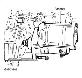

Where is the starter located

Located on right side of engine block
https://www.2carpros.com/forum/automotive_pictures/266999_jag_67.jpg
