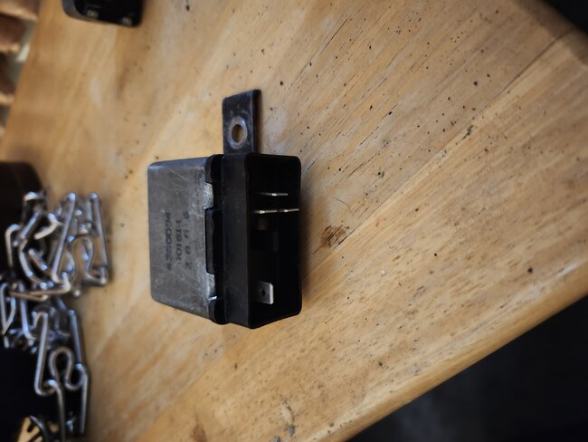

I had to bad relays a starter relay in a relay that I can't find a part number for but it's a four-terminal rectangle from left to right its 1 sideways terminal and then a set of 3 terminals. The motor clicks with no start I replaced the two bad relays with an Sr 118 and a ar-152 relay from Napa the motor still just has a clicking sound no change in diagnostic. I can't find a wiring diagram that includes starter relay and the 4 terminal relays included if there's any way that you could help that be great attached are the two original relays that were removed.

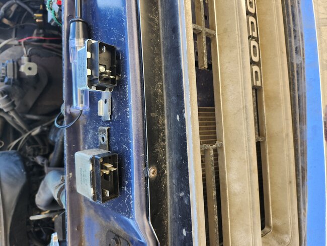

That's is my relay.

I saw that, but it isn't the starter relay. Are you hearing a light click of a relay or a loud clunk from the starter?
The other relay, (the one on the left), is the starter relay.

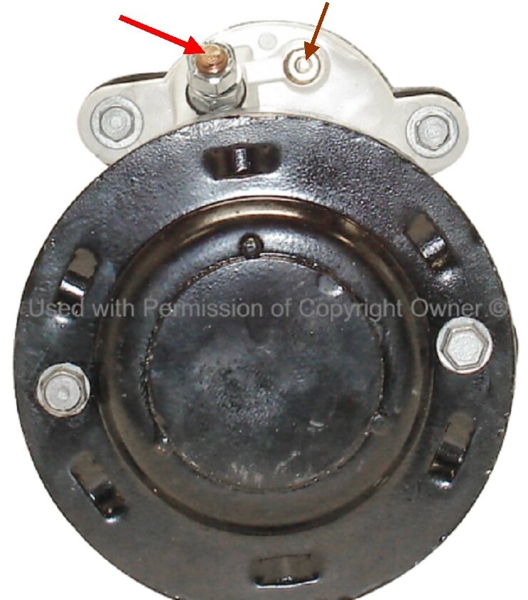

The photo below shows the rear view of the starter. We're after the smaller terminal to the right, with the brown wire attached to it. That's the brown arrow in the photo.
Remember, I want the clip lead for the test light on the engine, not on the battery or body. Doing it this way will prevent possibly mistakenly overlooking a bad ground cable. Testing that will come later, if necessary.
If you find it's too hard to hold the test light on that terminal, you can switch the ends. Attach the clip lead to the terminal, then fish the test light up to where it's easier to touch it to a paint-free point on the engine. Have your helper turn the ignition switch to "crank". Does the test light turn on?

I get a positive read on the large terminal of the starter I hear a loud click of the starter getting energy and that's where the clicking noise is coming from.

Dandy. A loud clunk from the starter means we're done with all the rest of the circuitry. To be sure we're seeing the same thing, if you had put the test light on the smaller terminal, the test light should have lit up full brightness when the ignition switch was turned to "crank".
Remember, these tests are only valid if the test light is grounded to the engine, not to the battery.
From here on, it is okay to ground the test light to the battery's negative post if that is more convenient. Go back to the larger terminal on the starter and place the test light's probe on it. It's going to light up right away. What's important is what happens when the ignition switch is turned to "crank". During normal operation it will dim a little. If it goes out or very dim to where you can barely see it, that positive battery cable has a problem. To determine which end is loose or corroded, turn the head lights on and watch their brightness. If they stay bright in "crank" mode, the problem is at the end by the starter. If they go out, the positive battery cable clamp is suspect.
If the test light stays bright at that larger starter terminal, now we must have its ground clip on the battery's negative post, if you haven't moved it there already. Move the probe to the starter's aluminum front nose anywhere adjacent to the terminals. The light will be off. Now watch what happens when the ignition switch is turned to "crank". It should remain off. If it lights up even just a little, enough to see, there is a problem with the black battery cable. Watch the head light brightness. Here again, if they get dim, suspect the battery cable at the post. If they stay bright, the better suspect is the end that's bolted to the engine.

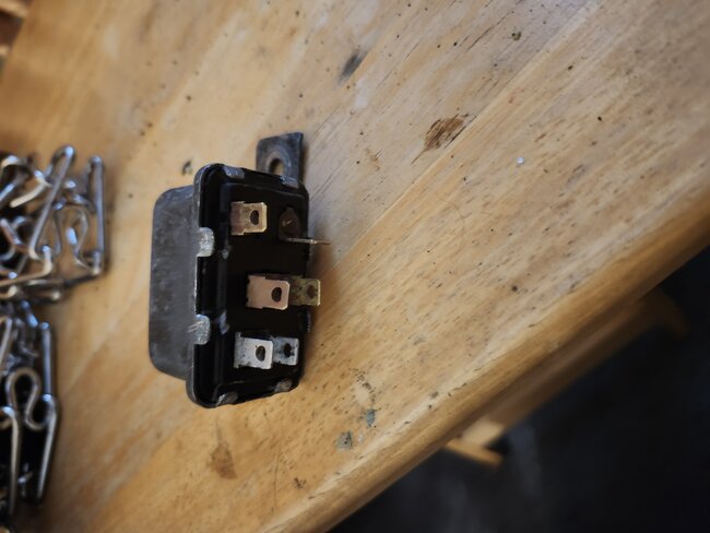

All light tests check out I'm starting to think i bought the wrong relay the left is what i pulled off the right is the replacement. Any help?

We've already determined everything other than the starter is working, so there's no point in going back to the relay. You have an ignition switch, a neutral safety switch, the starter relay, and all the wiring and connectors in between. All of those have to be working to get the loud clunk from the starter. That clunk is the plunger in the solenoid pulling the starter's drive gear into engagement with the ring gear on the torque converter. As that happens, at the end of its travel, the copper disc makes the connection for the starter motor to run. That's what's not happening. The solution is to repair or replace the starter.
The relays in your photo are the same. Just the mounting bracket is different, so one is likely for a different application. Either one will work by just turning the connector around. Chrysler has always been known for very good parts interchangeability between models and years. This is a good example. While it might mount differently, the terminal layout being the same is what says the relay is the same.
