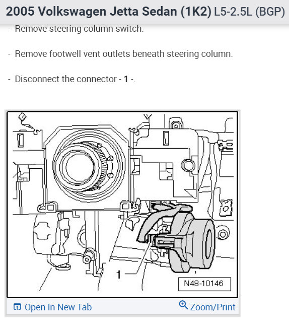

Yes, the red wheel means you have a problem with the steering system. probably the angle sensor or steering motor going out. to be sure you need to scan the system this video will show you how:
https://youtu.be/InIlnsjOVFA

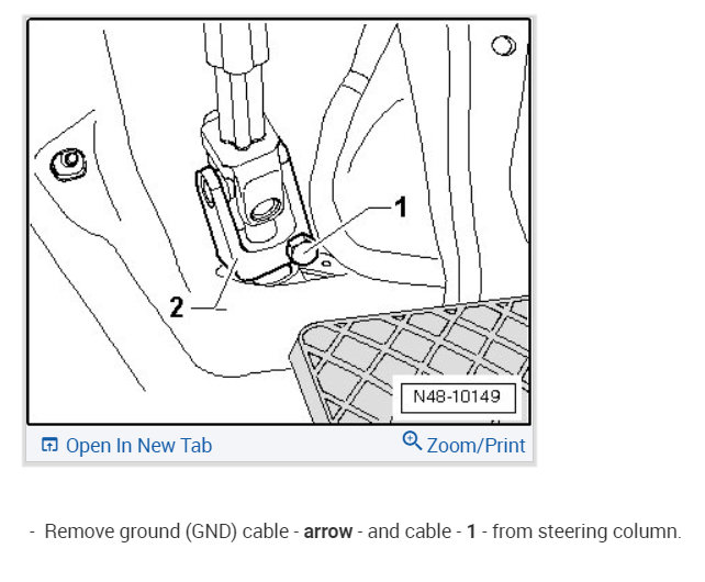

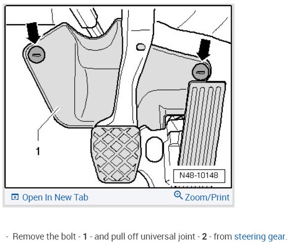

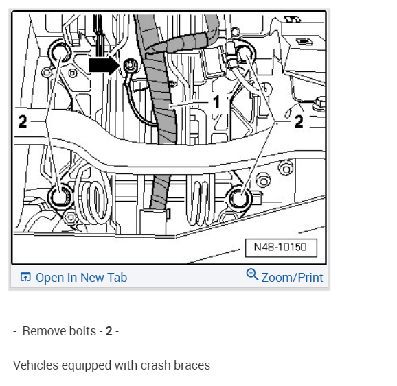

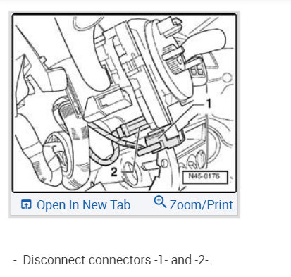

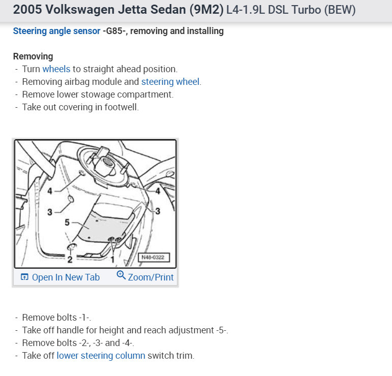

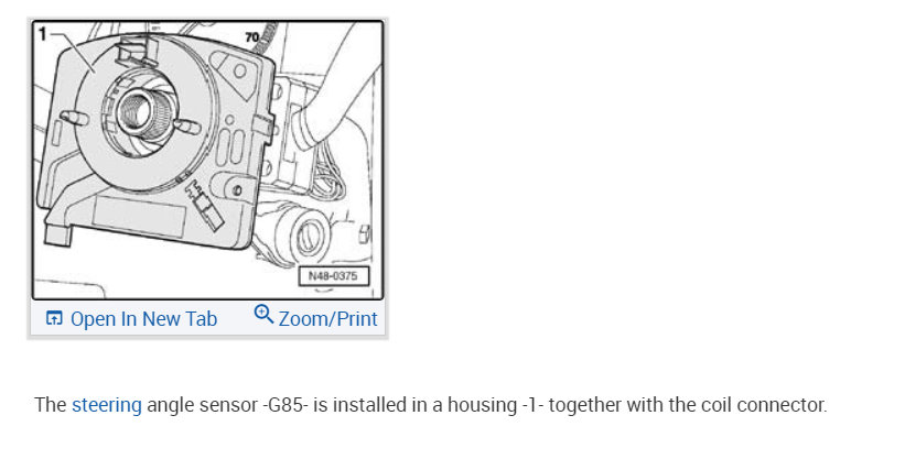

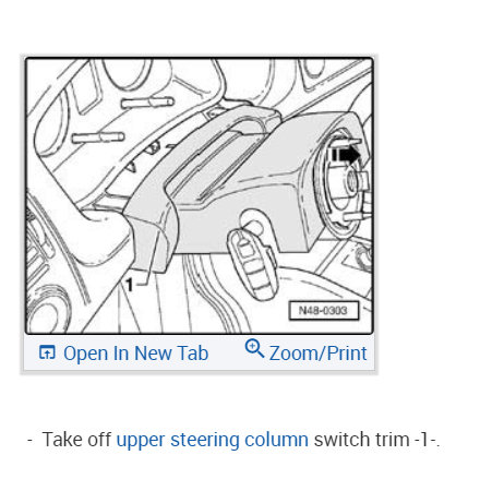

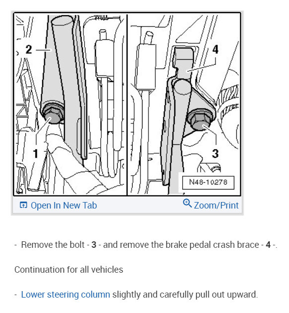

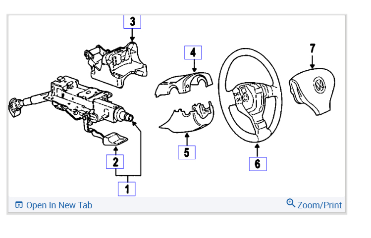

Here are diagrams and instructions on how to change out the module and steering sensor

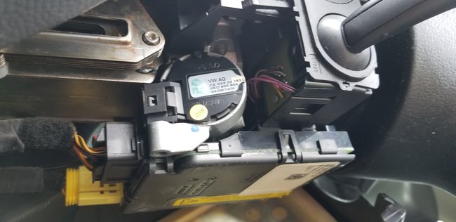

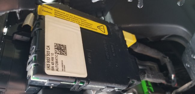

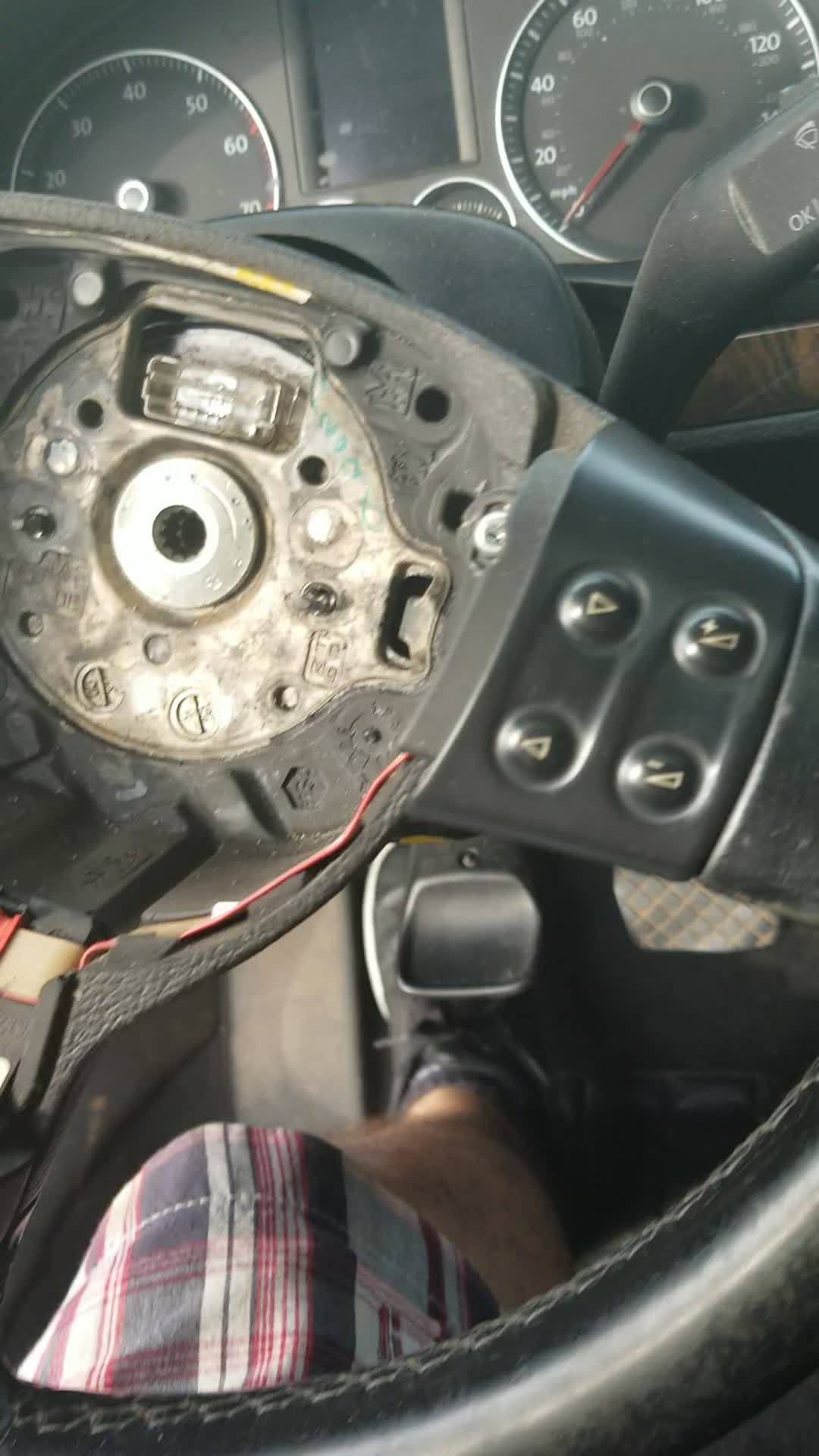

I was messing with the steering wheel cover and it's actually broken. So I was able to pry it open and I can see what I believe is the angle sensor.
Saturday, June 1st, 2019 AT 10:22 AM
IVAN AZCUE
  • 25 POSTS
Pictures.
Saturday, June 1st, 2019 AT 10:27 AM
KEN L
  • MASTER CERTIFIED MECHANIC
  • 55,488 POSTS
The sensor is under the steering wheel which needs to be removed to replace the sensor but you should be able to turn the wheel. I am wondering if the steering motor is lock up? Can you please shoot a quick video with your phone so we can see what's going on, that would be great. You can upload it here with your response. Let me see you trying to turn the wheel please.

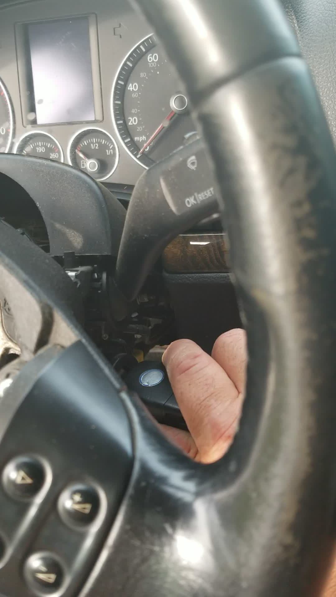

With the cover off I was able to remove the airbag. I stopped there since I didn't have the tool to remove the steering wheel bolt.
If the motor can lock up I think it did. What does that mean? Can the angle sensor still fix that?

Yep, the steering motor looks like it is locked up. Let keep taking it apart to see what you find. Do you need any other diagrams or?

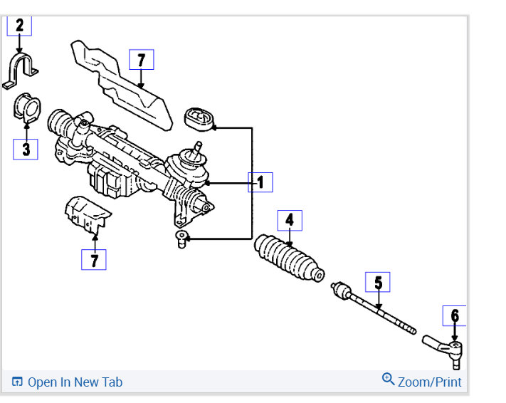

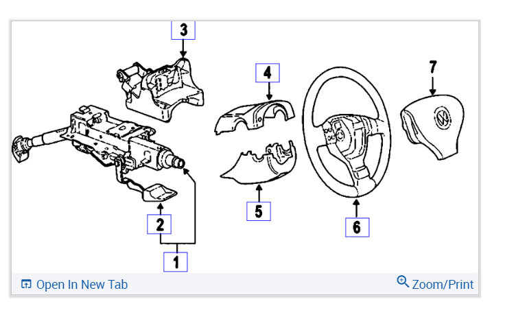

Could it be the steering wheel lock gas gone bad? Any diagrams for it?
Tuesday, June 4th, 2019 AT 11:04 AM
KEN L
  • 55,488 POSTS

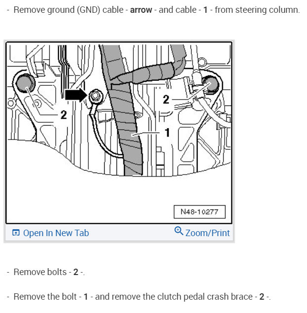

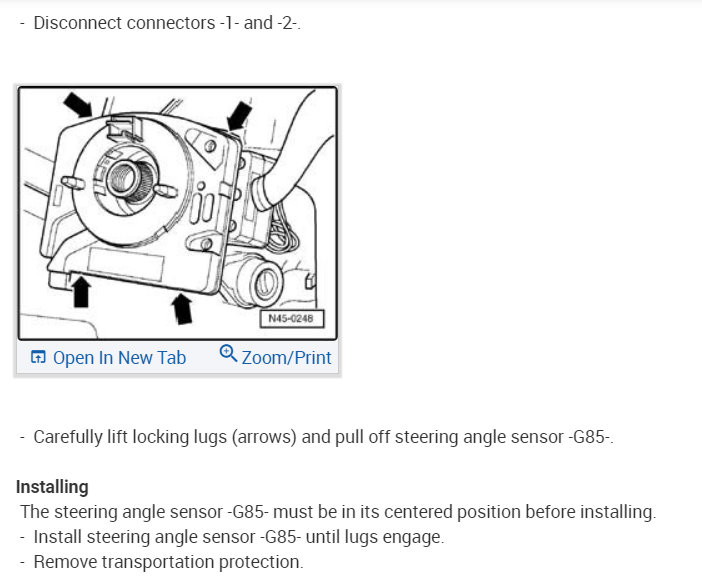

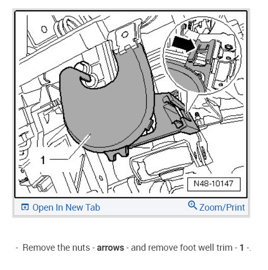

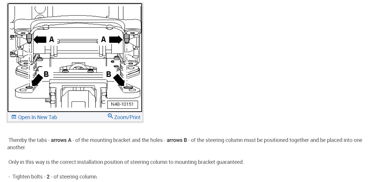

Here is what I found let me know if you need more. Check out the diagrams (below). Please let us know what happens.

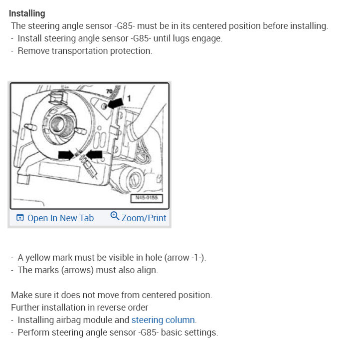

Tuesday, June 4th, 2019 AT 12:02 PM

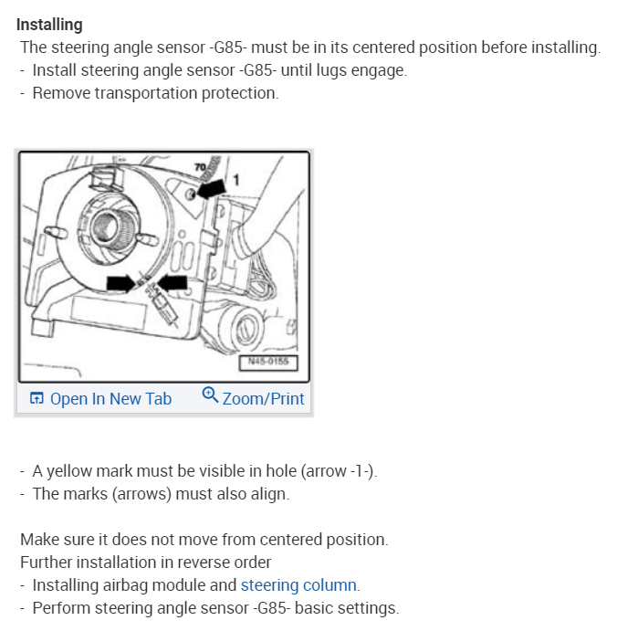

Hi Ken, I got the steering wheel off and when I remove the clock spring I realize the clock Spring does not rotate and fact it only moves slightly left and slightly right. Does that mean my clock spring is bad and could that be the issue? With the clock spring removed could I put the steering wheel back in turn the key on and see if the steering wheel works or is that a no no?
+1
Friday, June 14th, 2019 AT 3:32 PM
KEN L
  • 55,488 POSTS
Yep, it sounds like it is bad. I would get a new unit and install it. You can try installing the steering wheel to see what happens but you will have warning lights on for the airbag, horn wont work etc.
Monday, June 17th, 2019 AT 10:56 AM
IVAN AZCUE
  • 25 POSTS
Hi Ken, recall when I asked if clock springs are supposed to spin freely? Just received a clock spring. It only rotates slightly, just like the current line I have now.
So are clock spring free spinning?
Basically wondering if I bought another part for no reason.
I thought you said if they don't spin its bad and to replace.
Please explain.
Sunday, August 4th, 2019 AT 2:36 AM
KEN L
  • 55,488 POSTS
The clock spring will not turn freely unless installed it has safety clip that will not let it turn. Once installed it will work correctly.

  • 25 POSTS
Hey Joe, thanks for the follow up. The rack n pinion actually went out and had to be replaced all the sensors were good
