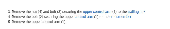

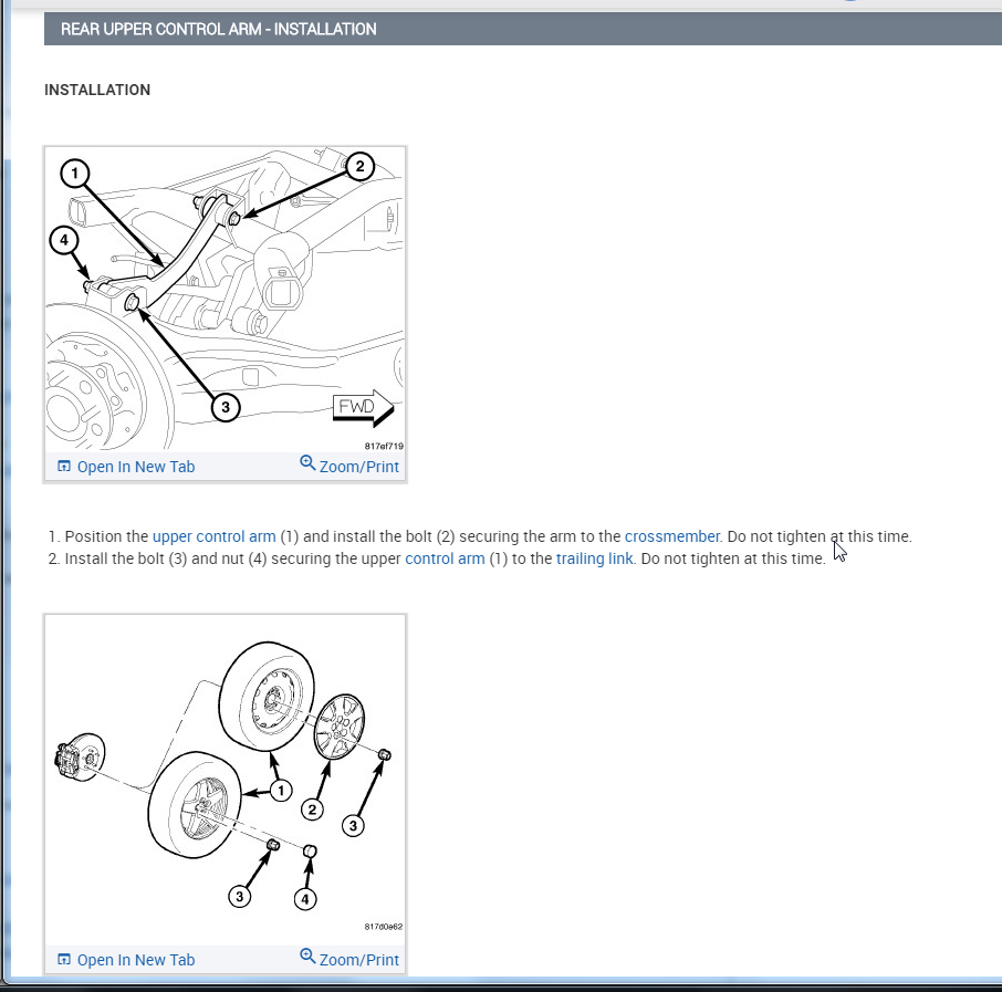

Hey, It's me again. Can't seem to find a tutorial video (vehicle specific) showing what I need to do in changing these boomerang shaped rear upper control arms. Can you give me any ideas as to how extensive it is?
Thursday, July 23rd, 2020 AT 4:58 PM
7 Replies

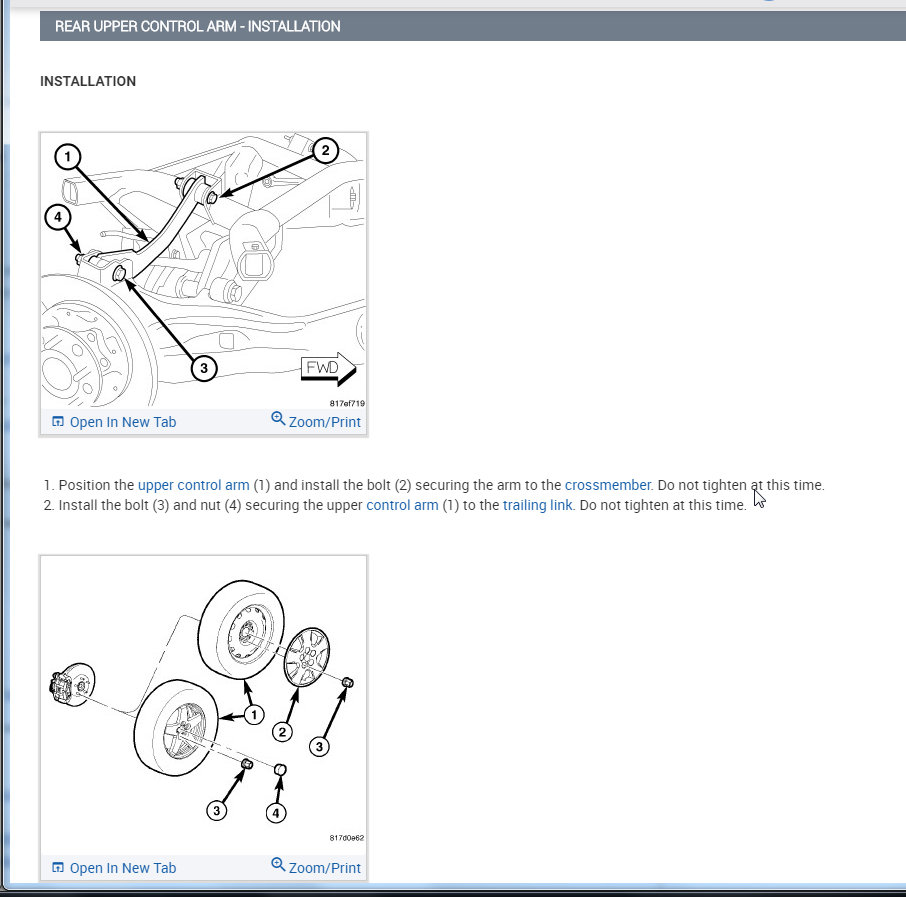

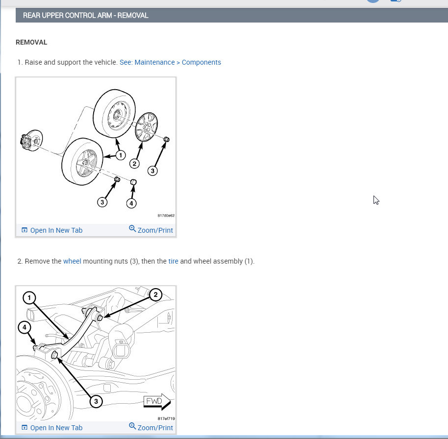

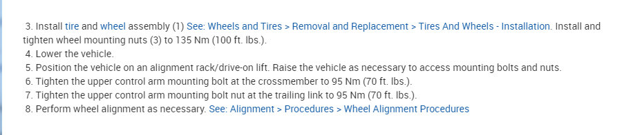

Unfortunately we don't have a video for this specific vehicle but here are the instructions from the manual. Hopefully this gives you the detail that you need.
Please let us know if you need other info and we can dig deeper. Thanks
Thursday, July 23rd, 2020 AT 5:04 PM
HKFROMNY.
  • 112 POSTS

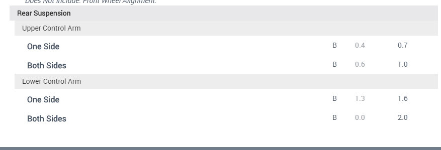

Okay, thanks. I'm assuming I don't need to worry about any alignment issues?
Thursday, July 23rd, 2020 AT 5:10 PM
Sorry. I meant to state that. You do need an alignment after this. The rear has adjustable control arms so step 8 says to perform an alignment.
+1
Thursday, July 23rd, 2020 AT 5:13 PM
HKFROMNY.
  • 112 POSTS
Darn it, was hoping didn't need it.
Thursday, July 23rd, 2020 AT 5:17 PM
Sorry. I know how you feel. Unfortunately any time we mess with a suspension component that is not on a solid axle it most always needs an alignment.
