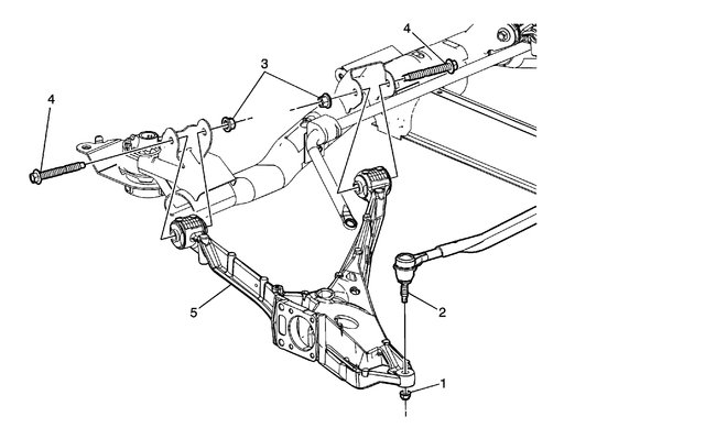

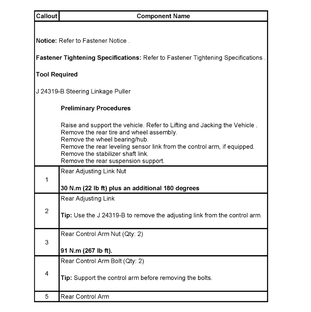

How to replace rear control arm?
Tuesday, April 2nd, 2019 AT 3:39 PM
JOETECHPRO
MECHANIC
705 POSTS
Hey l_l_munz@yahoo. Com,
I have attached a description of the process below.
Let me know if you need any further instruction on how to remove wheel bearing etc.
Regards, Joe
