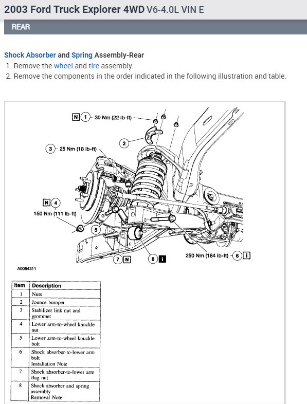

Will rear struts from a 2006 Explorer fit in my 2003 Explorer?

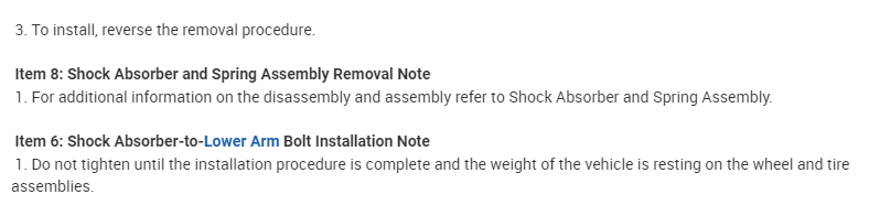

Those 2003 and 2006 Explorers uses different struts and are not interchangeable.
Here is a helpful guide of how to replace struts:
https://www.2carpros.com/articles/how-to-replace-a-suspension-strut-and-spring
