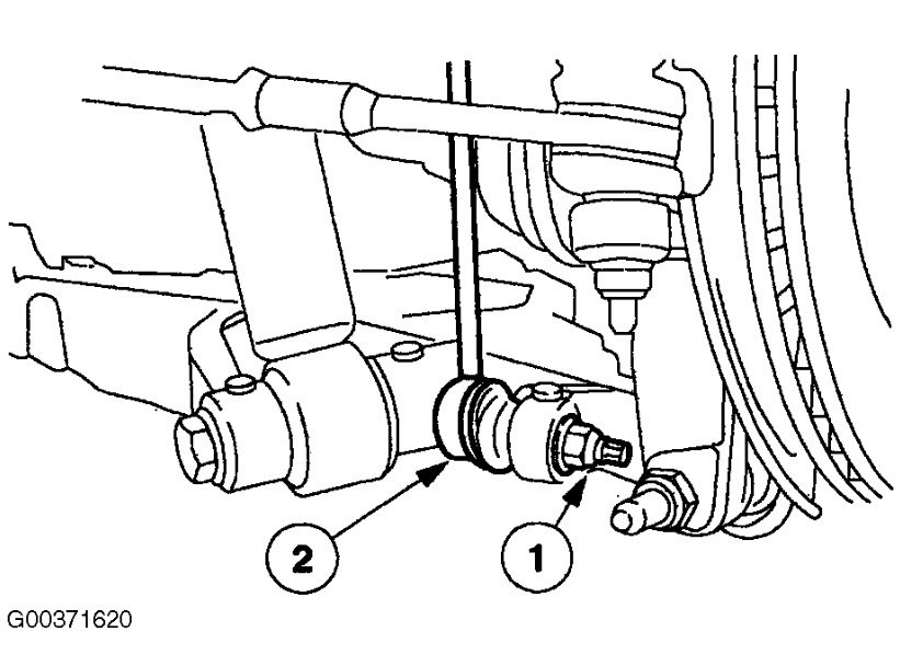

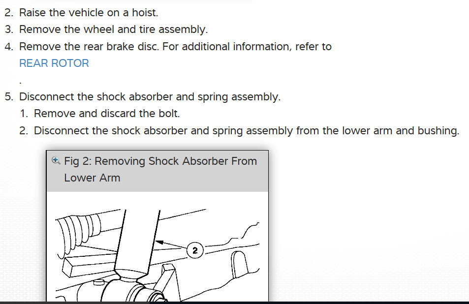

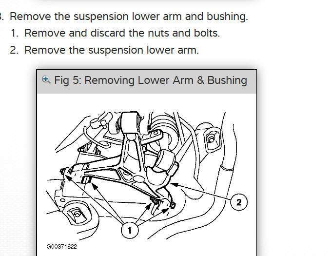

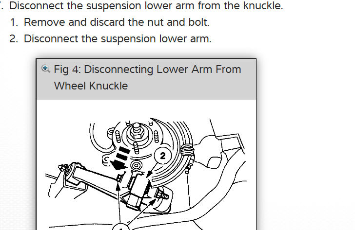

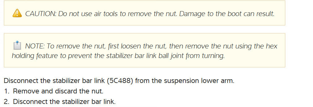

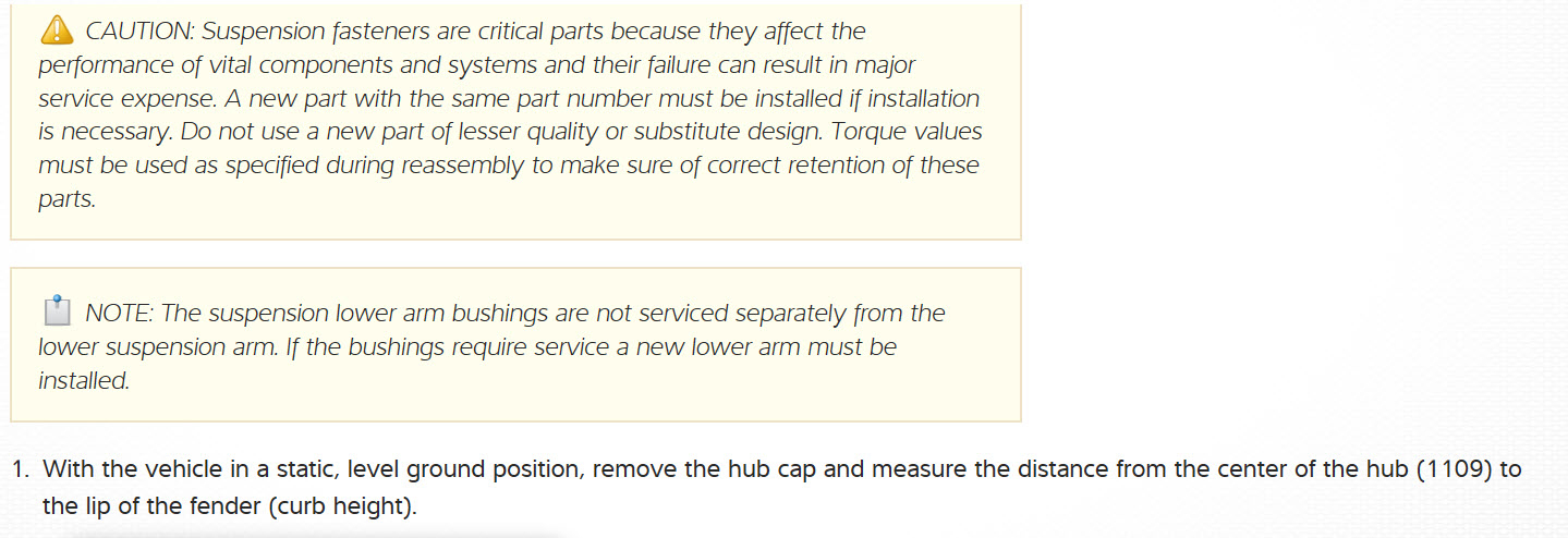

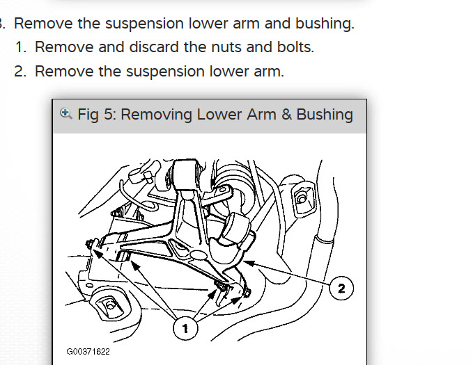

How do you remove rear lower control arm?
Tuesday, May 23rd, 2017 AT 5:32 PM
HMAC300
MECHANIC
48,601 POSTS
See pictures, various nuts must be replaced when reassembling. Follow package instructions.
