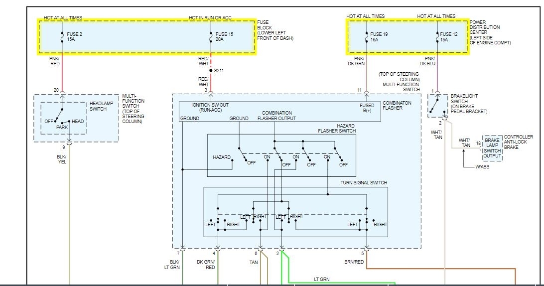

None of the rear lights are working
CATHERINE SUAREZ
MEMBER
2003 CHRYSLER PT CRUISER
80,000 MILES
Check fuses all are okay.

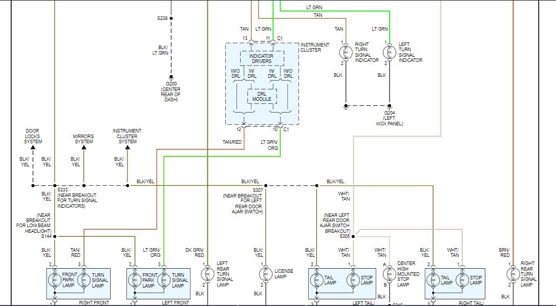

Good morning,
I attached a diagram for you of the circuit.
You need to check the fuses for voltage to be sure power is available to the multifunction switch for turning on the lights.
Use a test light to check for voltage.
