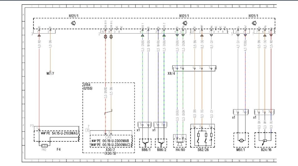

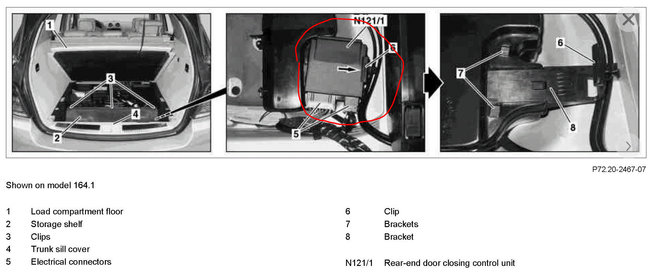

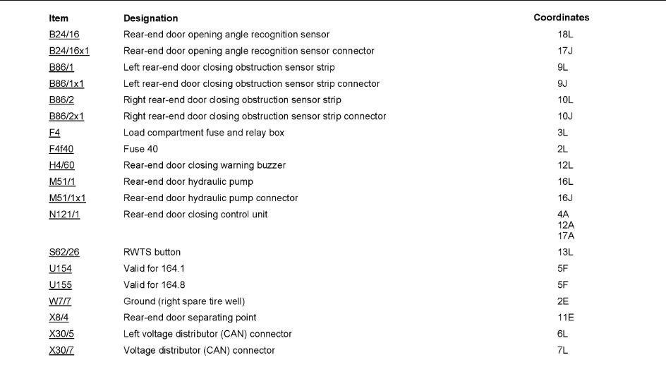

It sounds like the problem could be the rear door control module. I have attached a picture of it. First, locate the component and see if that is where the noise is coming from.
Let me know what you find.
Monday, April 6th, 2020 AT 8:09 AM

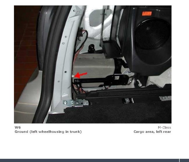

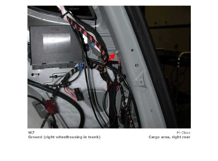

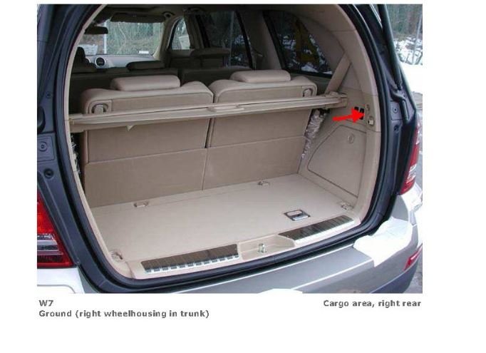

Good afternoon,
I would start by checking and cleaning up grounds. There are 3 grounds for this system. I attached pictures of them. Clean them with a wire brush and make sure they are tight.
Monday, April 6th, 2020 AT 11:47 AM

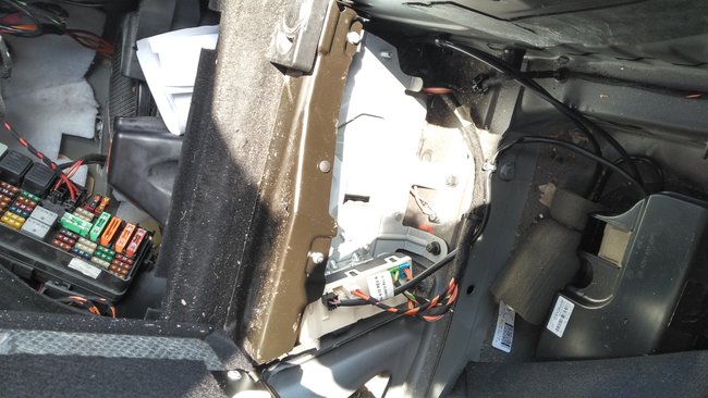

For some reason I have yet to hear it while ripping out the wheel. Hear is a picture of what is by the wheel is that the controller in the middle (white box):
Monday, April 6th, 2020 AT 12:35 PM
Yes, that matches the picture Joe posted earlier.

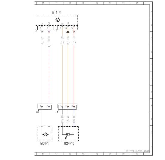

Would just like to go over all the info before I change out another SAM in the car (witch is not wet and looks good).
1- changed out lift gate actuator twice (just incase one was faulty. Aftermarket)
2-When car tries to go into sleep mode something sends a signal to the rear SAM that the lift gate is not locked. So every minute the rear actuator tries to lock again (even though it is already locked tight) thus rear SAM is awake and drains the battery
3-This does not happen when car is on. The dash tailgate light does not go on and the overhead lights go out as normal after car is started
4-The SAM goes to sleep if I leave the lift gate "ajar" (no battery drain)
5- Can the pinch sensor be responsible? Is the pinch sensor the same as the aliment sensor?
6-does the software need to updated with a aftermarket actuator?
Any ideas? Thank you much.
Tuesday, April 14th, 2020 AT 4:09 AM
Yes to the pinch sensor.
Yes to the actuator. It needs to be programmed.
Sounds like you have covered all the bases.
Tuesday, April 14th, 2020 AT 4:21 AM
