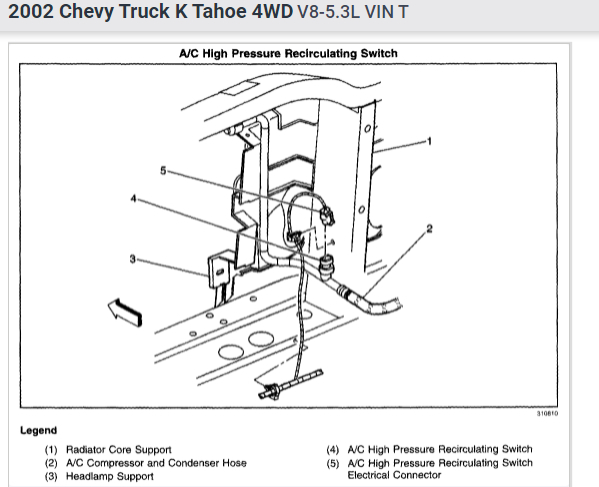

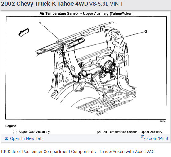

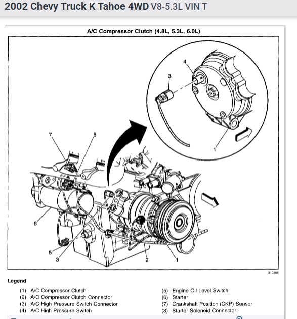

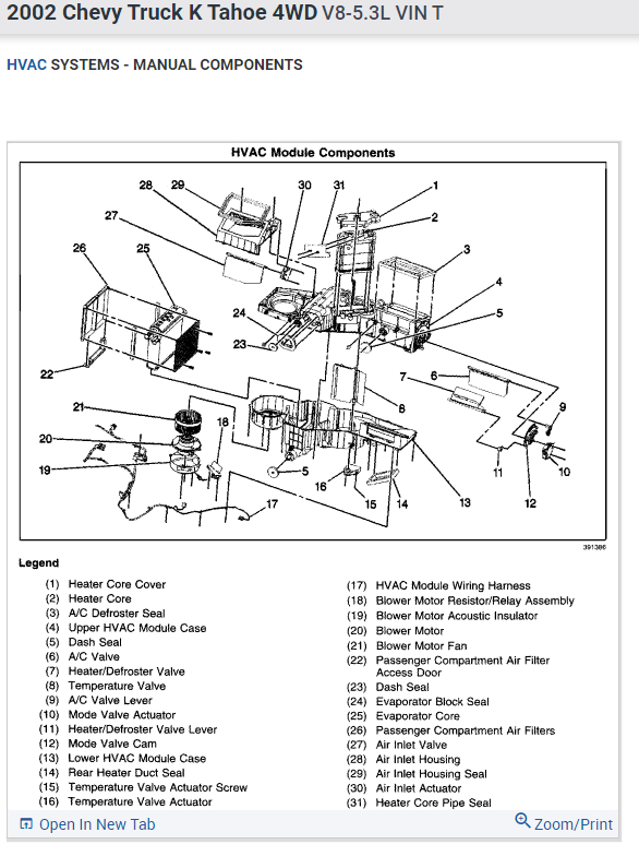

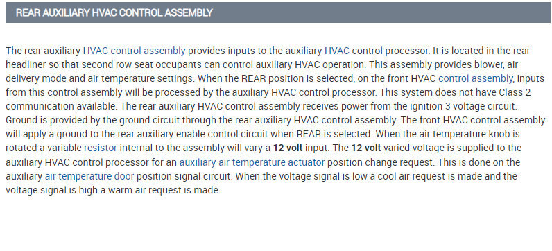

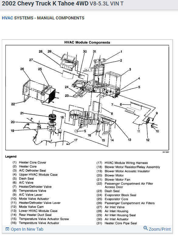

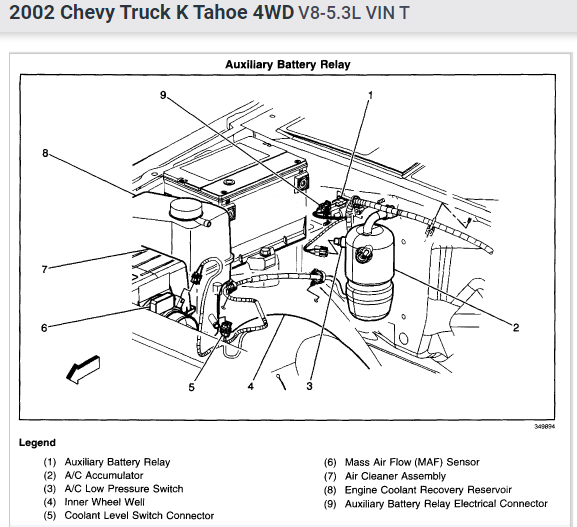

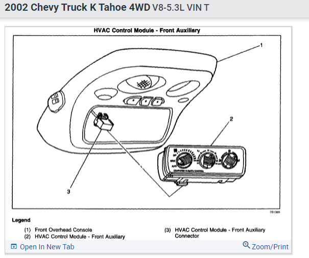

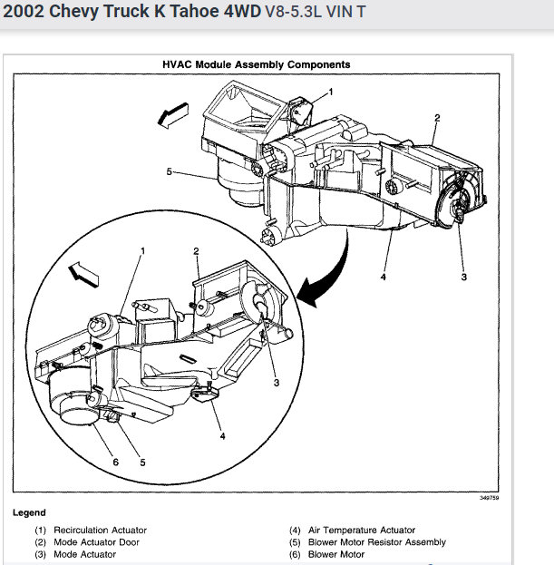

Very seldom works. If it works (maybe once or twice a year), produces hot and cold air well. Just doesn’t work very often.
Where do I start troubleshooting this?
Friday, July 16th, 2021 AT 5:42 AM
3 Replies
SQM
MECHANIC
6,383 POSTS

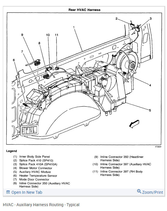

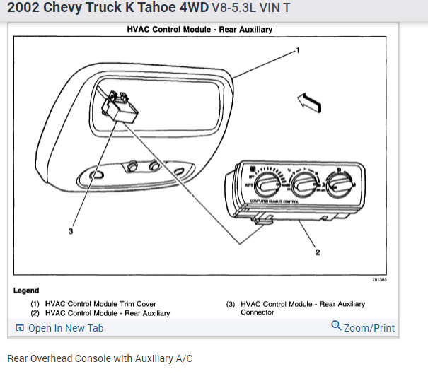

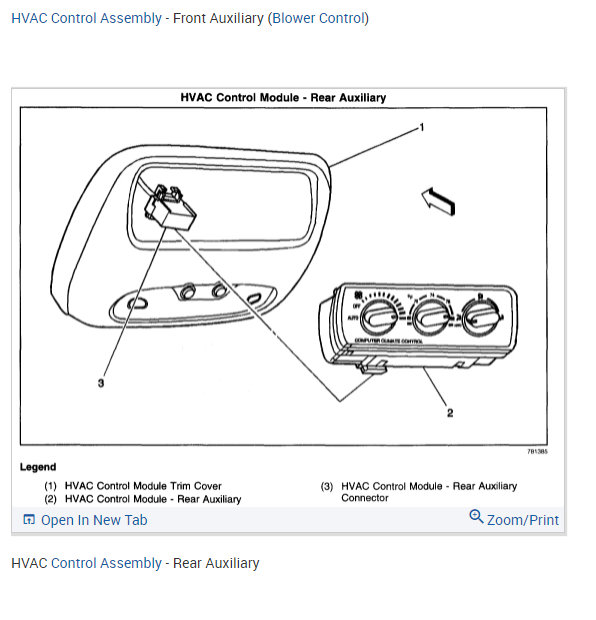

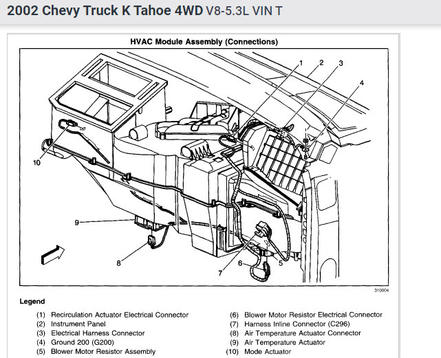

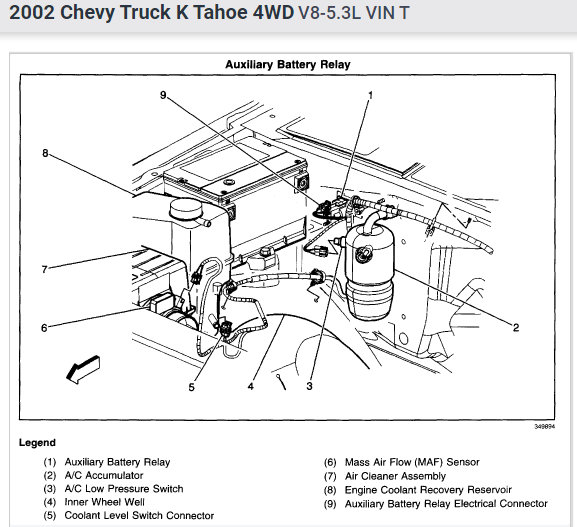

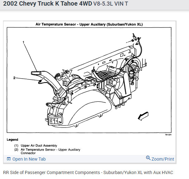

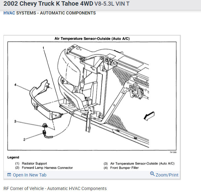

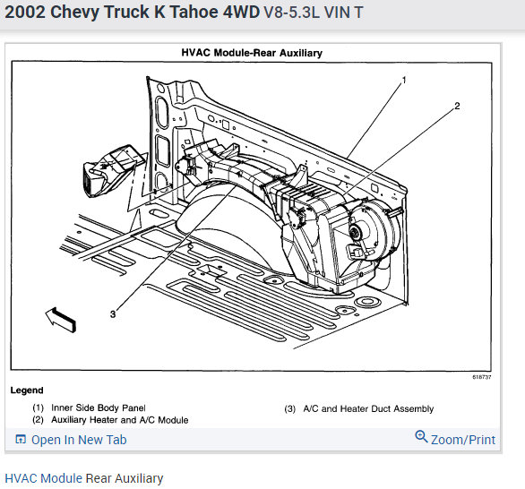

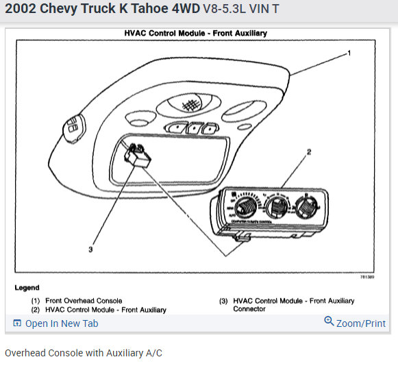

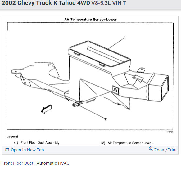

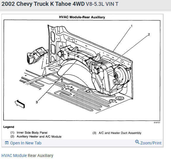

Please have a look at this article, it has a lot of good info. Should help you guid to the right direction.
https://www.2carpros.com/questions/2003-chevrolet-tahoe-rear-ac
https://youtu.be/Z2h3ewDYB2o
I have also attached complete rear A/C system diagrams.

Based on this - I’m going to change the rear blower motor.
Thanks guys!
