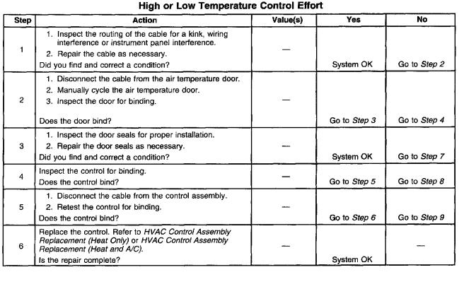

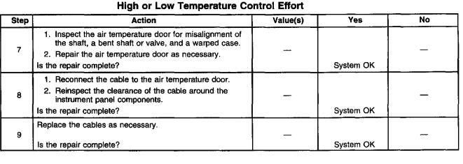

RANDY SHARP
  • 165 POSTS
My problem is that I have a 2001 Chevy Tahoe.I just put some refrigerate in it because it was blowing warm air.Well now I have discovered that no matter what direction I place my temp gauge on hot or cold.It blows the same temp air that is outside if it is 40 degrees it blows that if it is 100 degrees it blows that.What do you think maybe cable off or selector is not engaging temp from cold to hot?
Apr 24, 2019 at 7:12 PM (Merged)
SEANGRANT00
  • EXPERT
  • 334 POSTS
Is the clutch engaging on the compressor? It could be the temperature selector but they rarely go out. Was it doing the same before the problem?
RANDY SHARP
  • 165 POSTS
Yes the clutch is engaging,like I say on the temperature selector inside the truck no matter where you select it to it just blows out the temperature of the air it is that day or night.
SEANGRANT00
  • EXPERT
  • 334 POSTS
It sounds like it could be the air temperature door, I have added a image that is a diagnostic procedure for this. It could also be some other things but lets try this out first.
Let me know

The images I added to the post earlier is the diagnostic for the knob.
