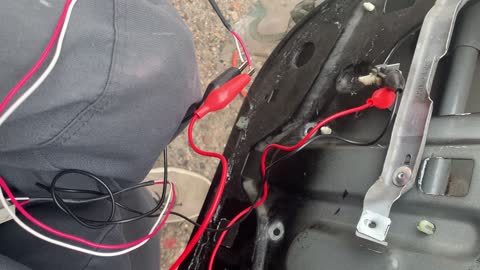

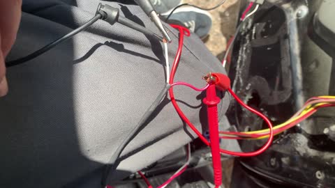

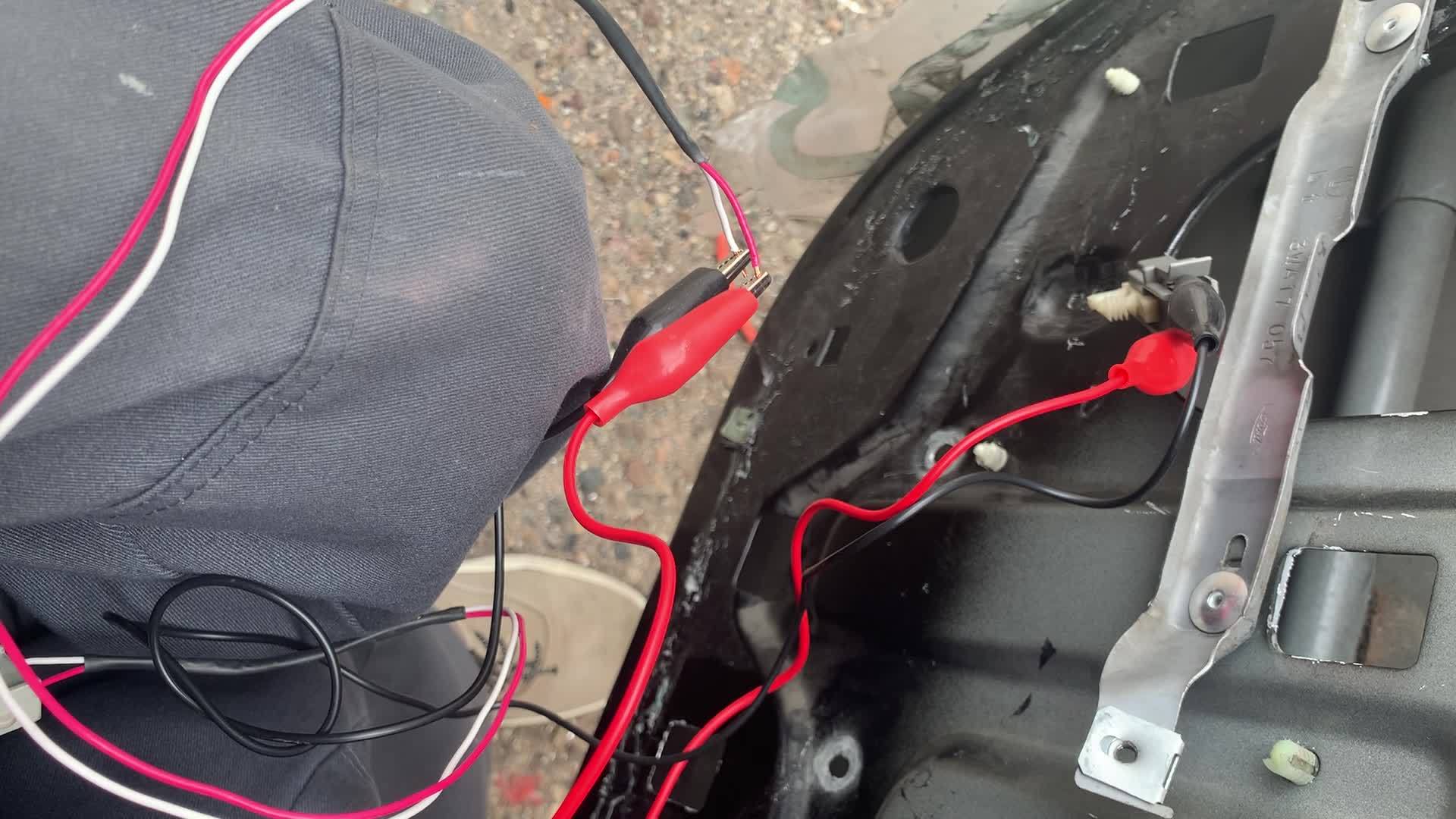

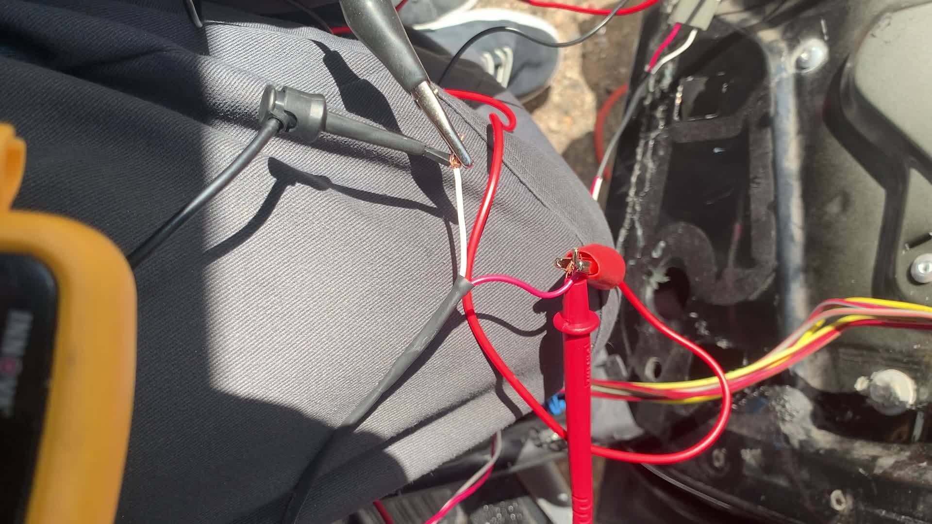

My window wouldn't roll up so cut the regulator cable so i could manually push up the window until I could get the motor replaced. I then replaced the window regulator and motor yesterday with brand new parts only to discover that the new motor does not roll up either. Pulled a switch from the passenger side to see if the switch was the problem but that switch also did not roll window up, only down. Motor attaches to a 2 prong pigtail connector so I tested voltage with multimeter. 11.7 one direction -11.8 other. If I reverse the wires the motor will reverse. So that voltage is without motor attached in circuit. If I measure with motor attached I get 7.62 volts one direction and -.02V the other direction. i should add multimeter was hooked up with red prong to one wire on pigtail and black prong to other wire on pigtail.

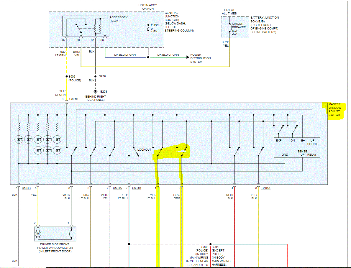

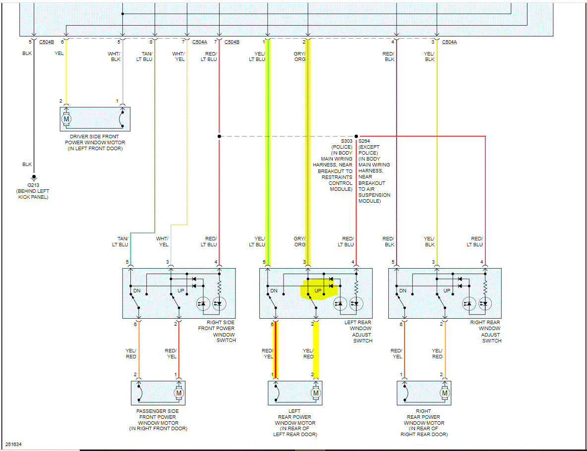

Take a look at the pics below. That is the entire wiring schematic for the windows on this vehicle. I highlighted the power supply from the main switch to the rear one.
Since the window won't go up, First, I need you to check the yellow wire with a red tracer. Place the positive of the multimeter in the wire and the opposite to the motor. If there is nothing between the switch and the motor, check the gray wire with an orange tracer that comes from the main switch.

Okay, the yellow wire with red tracer is at the switch and also at the connector to the motor. If I put the red probe to that wire where it connects to the motor and then the black probe to the other wire which is red with a yellow tracer I get 9.25 volts when it is rolling down and then -.02 volts when I attempt to roll it up.

When you reverse the direction, you also need to reverse the leads on the DMM. Otherwise, you won't get an accurate reading. If you do reverse them and get a +.02v reading, go back before the switch and see if you get a higher voltage. If you do, the switch is bad in the rear door.

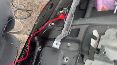

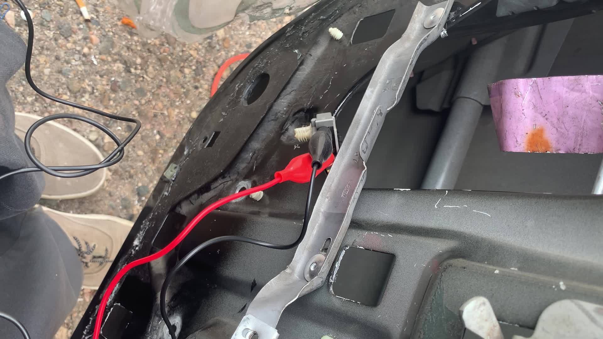

This might illustrate what I did earlier. Not sure if it's relevant at this point but I didn't think it could hurt. The first videos are readings without the motor attached and the last is with the motor attached. I did these before i posted here.

Yellow/blue and orange/gray are the power supply from the main switch. Since you can switch the wires on the motor and it works in both directions, the motor is good. Since it won't go up when connected correctly, the red/yellow isn't getting power.
Do me a favor. Check the red/blue wire at the switch to see if there is power. I'm questioning something and that will tell me if I am looking at this wrong.

That seems to be the power supply then and the other wires at the switch provide a ground path to complete the circuit. I'm sorry I didn't realize that at first. It's more difficult when the vehicle isn't in front of me.
If that is power, then the other two should show continuity to ground when the switch is actuated. Since it does it with a different switch, then the problem is before that. Check the gray/orange wire to the main switch.
Disconnect the rear door switch and check that wire for continuity when you have the main switch for that door in the up position. If there is none, then check for continuity right at the main switch itself. If there is none, replace the main switch. If there is, then there is a break at some point in that wire.
