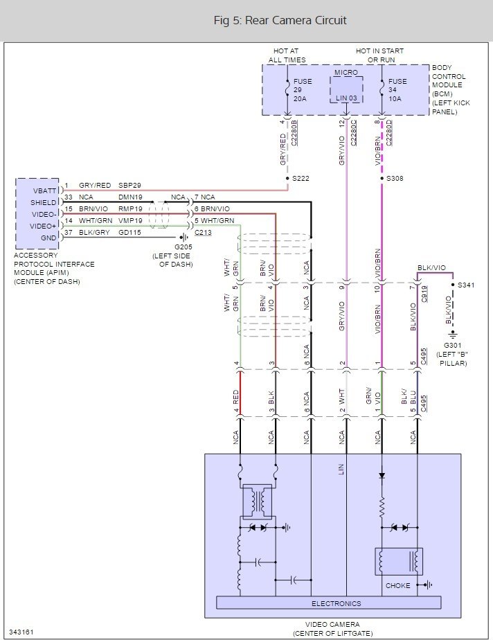

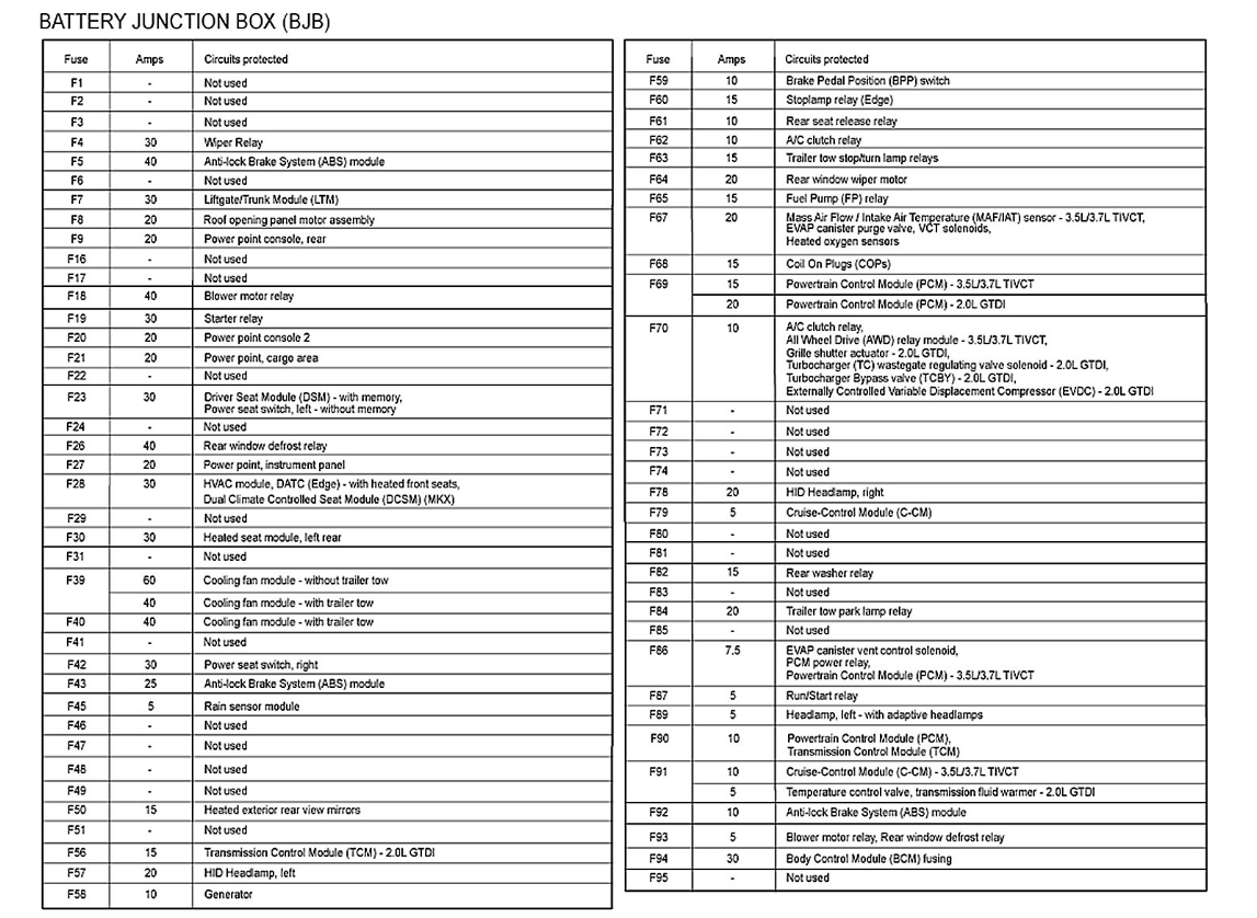

Rear view camera is unavailable. please contact your dealership. What to do? I want to make sure it is the camera before buying it. And find it just a fuse.
Feb 18, 2017 at 4:22 AM
  • 55,006 POSTS
Hey NAIF83,

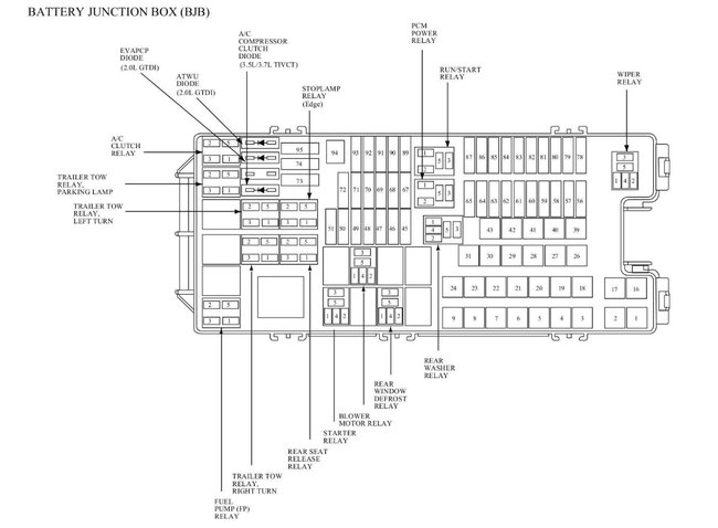

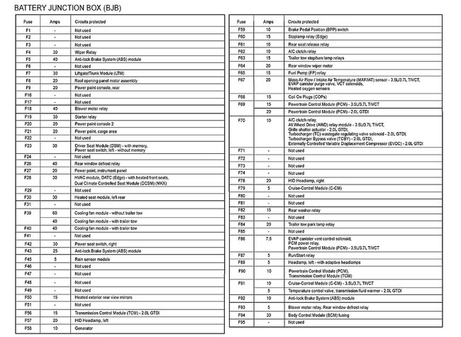

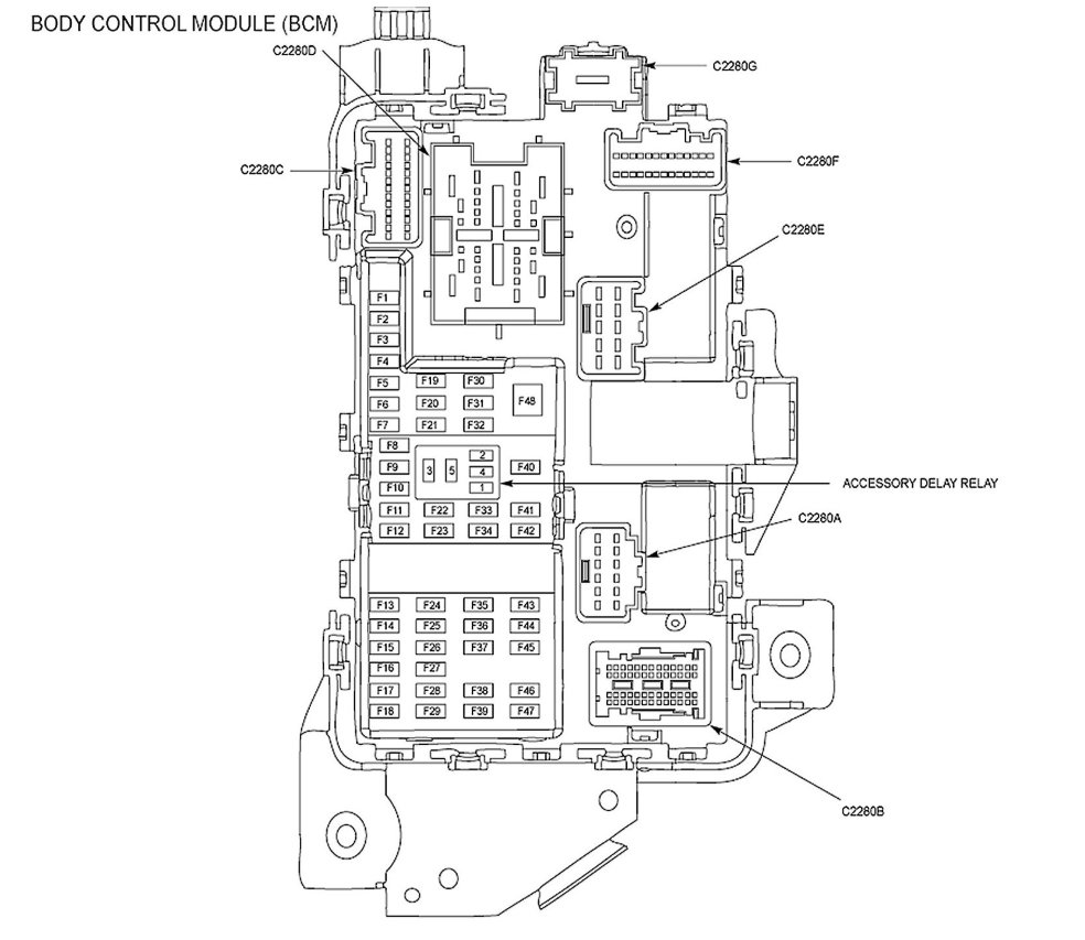

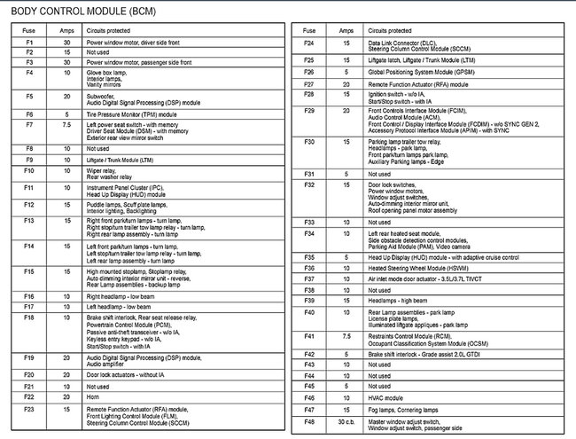

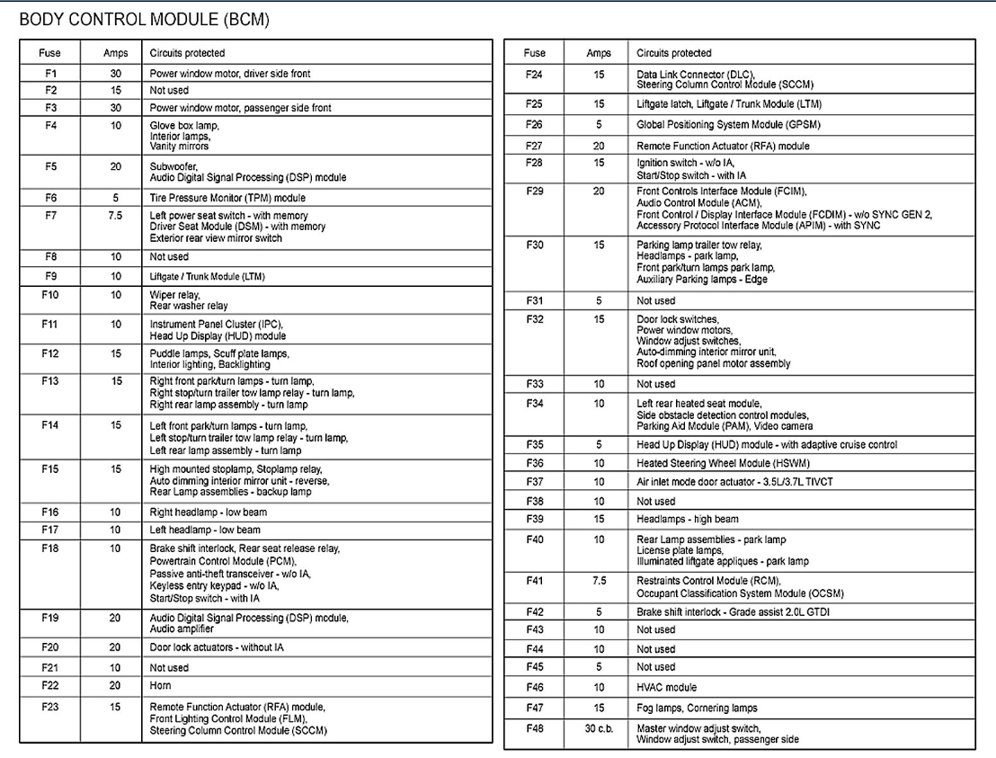

Yes there are two fuses that control the system (29 and 34) . Here is a guide and a wiring diagram to help you get the problem fixed with the fuse location below.
Check out the diagrams (Below). Please let us know what you find. We are interested to see what it is.
