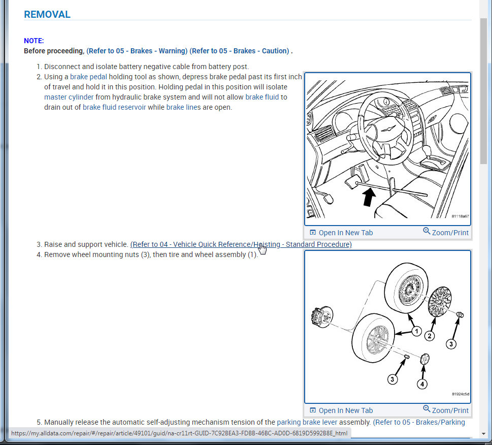

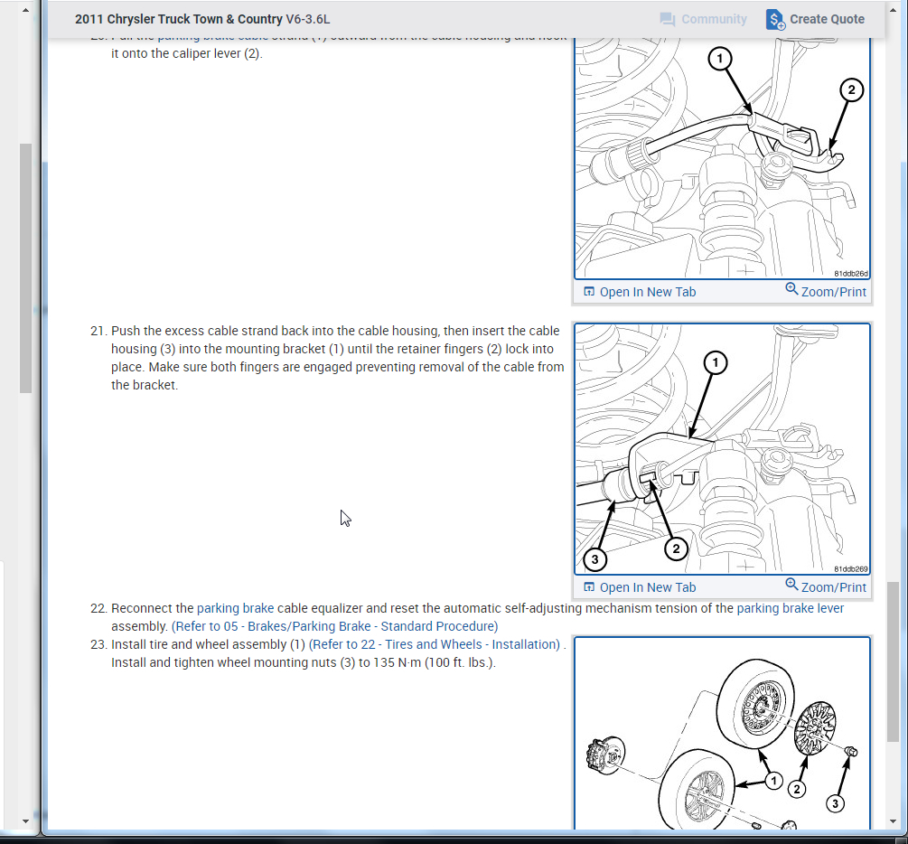

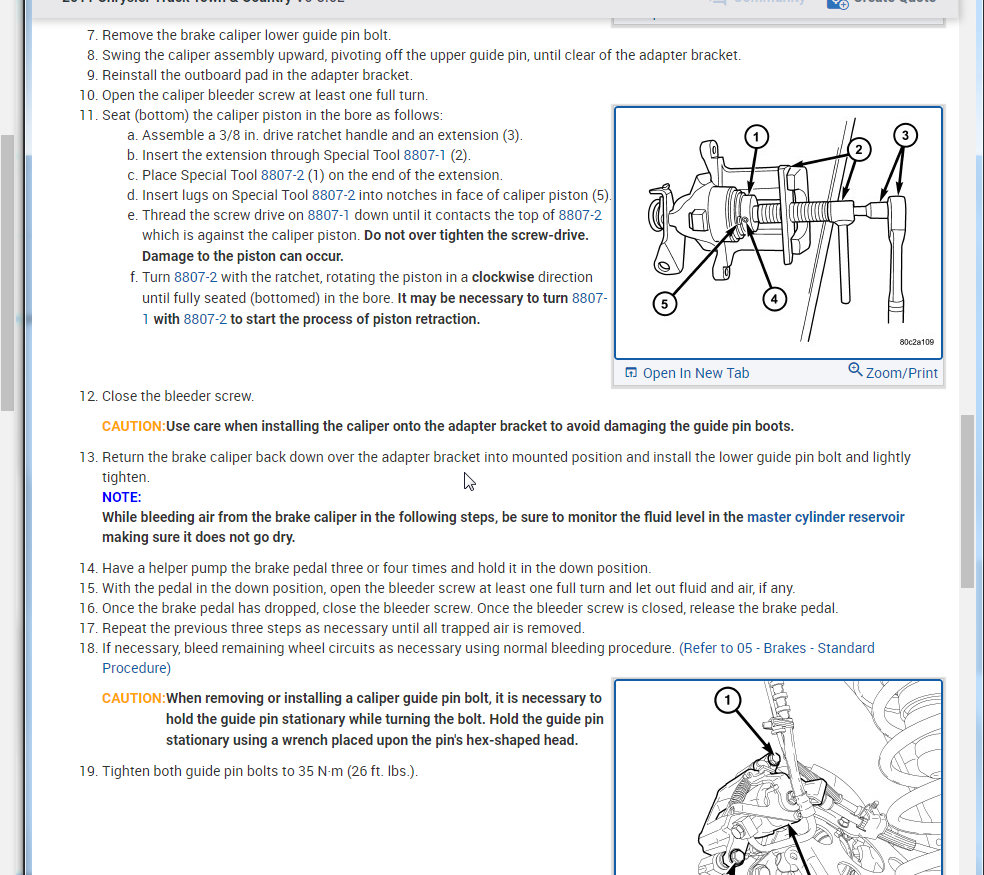

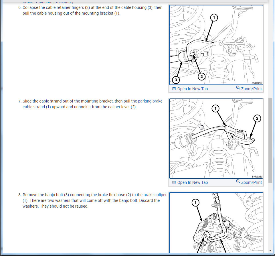

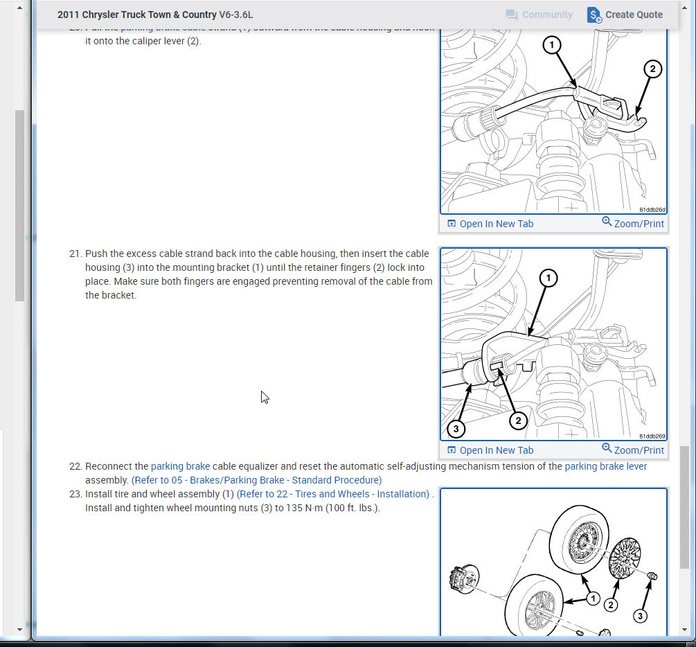

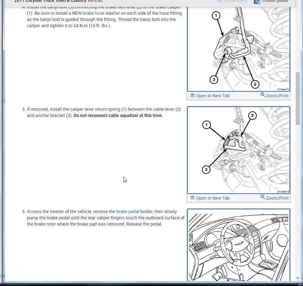

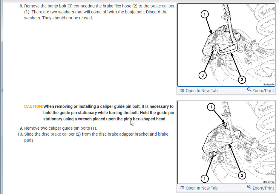

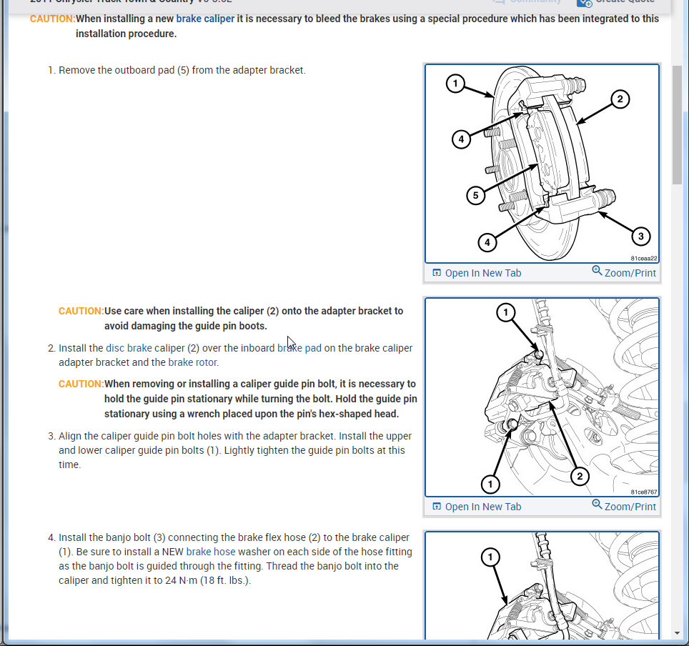

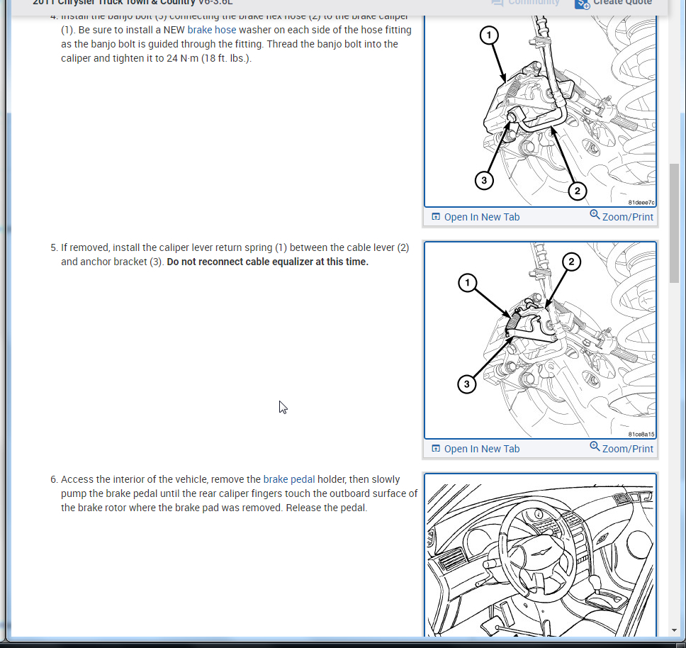

Rear brake caliper piston will not re-track.
Thursday, June 8th, 2017 AT 3:11 PM
MECHANIC
18,907 POSTS
Here is a video that will help with this:
https://youtu.be/hPzxdnLJbhc
and
https://youtu.be/j8YwfSKEzZo
If it will not retract then you are going to have to replace it as it is seized or the fluid is not being allowed to return.
Here is a guide that will help replace the brakes and caliper as you will most likely need to replace both while you are there:
https://www.2carpros.com/articles/how-to-replace-rear-brake-pads-and-rotors
and
https://www.2carpros.com/articles/brake-caliper-replacement
Below is the process for this as well from the manual. Let us know if you have other questions. Thanks
