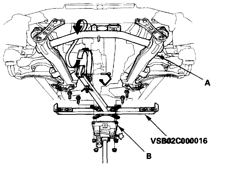

Rattling noise when going over bumps, front driver tire only.
Aug 1, 2018 at 5:33 AM
  • CAR REPAIR CONTRIBUTOR
  • 110,190 POSTS
There are many things which can create a rattle when hitting bumps. Components such as sway bar links, strut mounts, bushings, the list goes on. What I suggest is this. Read through this link. It describes in general what you have described. Additionally, it explains how to check the different components.
https://www.2carpros.com/articles/popping-noise

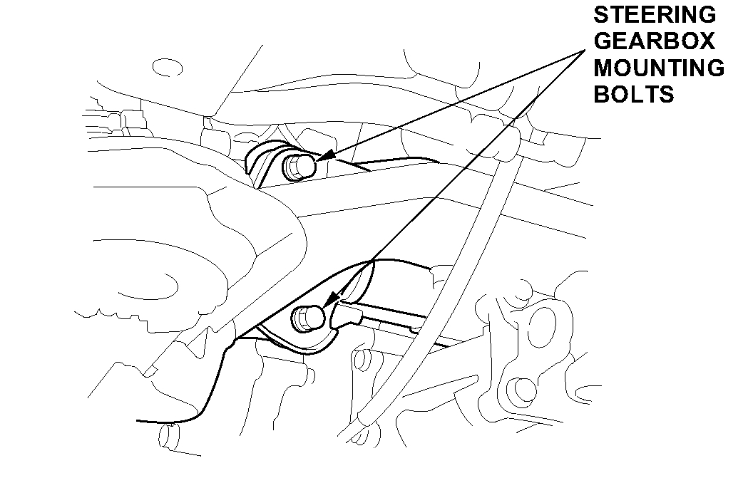

Next, I would like to add that there is a technical service bulletin (TSB) from some years back that defined a pop, clunk when turning. It was related to the steering box bolts. If they are loose enough, you may be hearing them. Pictures 1 and 2 correlate with this TSB. Additionally, at the end it explains how to diagnose if this is the problem. I listed this because the steering box is on the front driver's side of the vehicle.

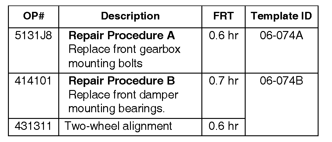

^ Replace the two driver's side gearbox mounting bolts: see REPAIR PROCEDURE A, or
^ Replace both front damper mounting bearings: see REPAIR PROCEDURE B.

3. Have an assistant turn the steering wheel quickly from the left to the right while you inspect the steering gearbox pinion area. Look for the gearbox moving from side-to-side on the subframe, causing it to thump or pop.
4. Raise the vehicle on a lift.
5. Inspect the two bolts holding the gearbox to the subframe in the pinion shaft area on the driver's side.
^ If the bolts are loose, go to REPAIR PROCEDURE A.
^ If the bolts are tight, go to step 6.
6. Lower the vehicle.
7. Turn the steering wheel lock to lock, and check the right and left damper springs for noise. If the noise is coming from the damper spring(s), go to REPAIR PROCEDURE B.
REPAIR PROCEDURE A
Replace the two steering gearbox mounting bolts in the pinion shaft area. Torque the new bolts to 58 N.m (43 ft-lb).
REPAIR PROCEDURE B
Replace both front damper mounting bearings (even if only one is noisy).

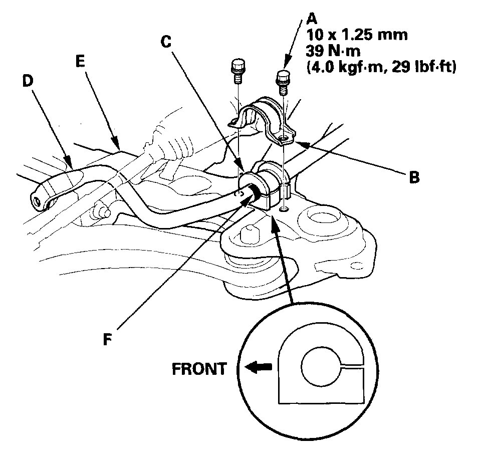

I added pictures 3 and 4 to show you what the sway bar and bushings look like. For you to actually seem them from under the front of the vehicle, you will have to remove the plastic splash shield.
I hope this information is helpful. Let me know if you have other questions or need additional help.
