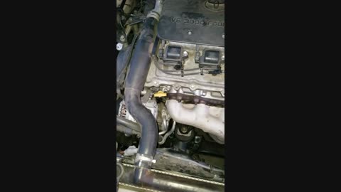

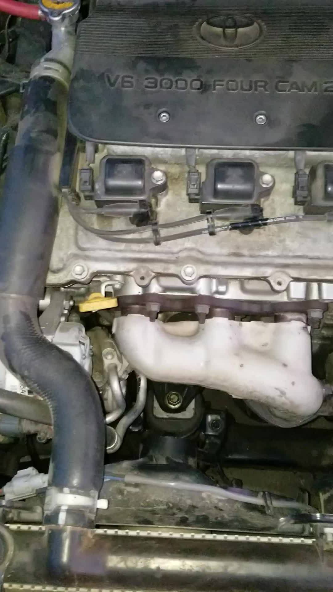

Also, I replaced the motor mounts but could not get to the one located down in the back. But attached is the video.
+1
Monday, June 18th, 2018 AT 9:24 PM
STEVE W.
  • 15,613 POSTS
That sounds like a cracked flex plate. To eliminate anything on the front end you could remove the accessory drive belt on a cold engine and start it. If the noise is still there it is not the accessories. You might be able to slip a camera up into the bell housing and look at it directly. Or use a mechanics stethoscope to listen to the parts of the engine and track it down.

Still wondering about that back motor-mount by the firewall. But I am not certain I can do that one myself. I know you have to remove the CV axle to do it on this car.

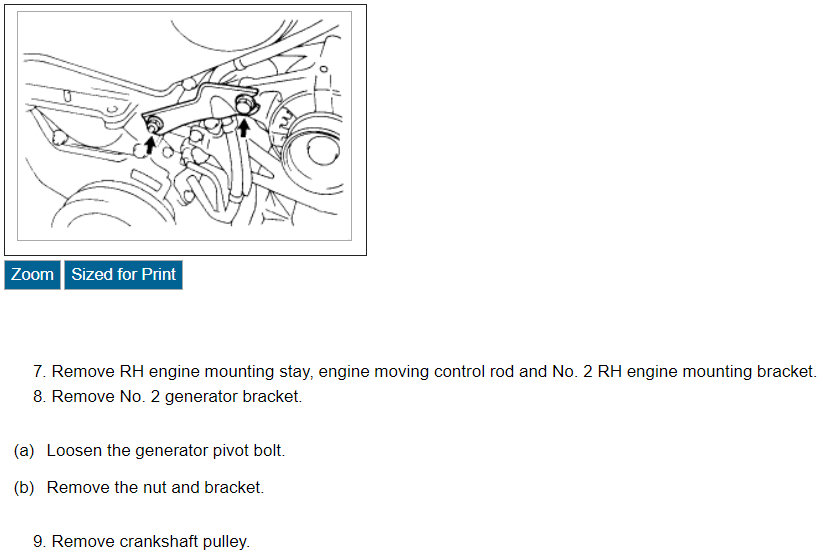

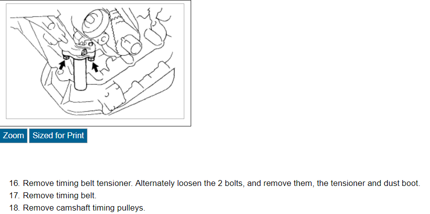

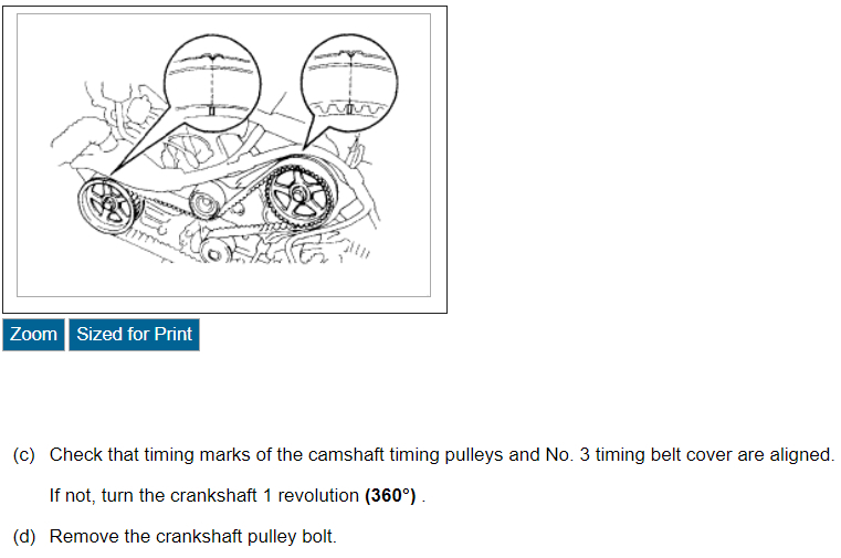

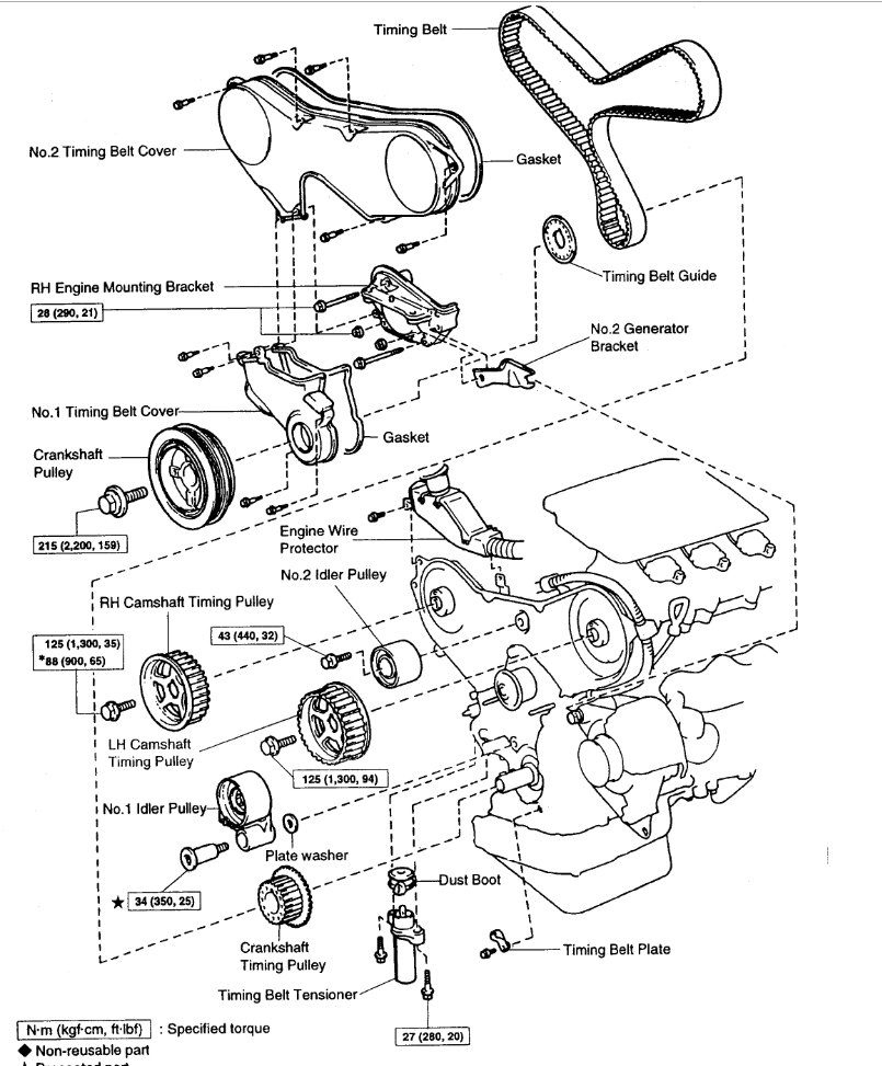

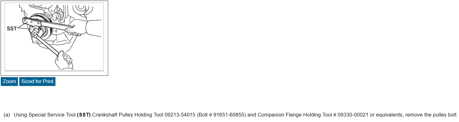

I would remove the serpentine belt and start the engine. If the noise is still there it will be the timing belt and tensioner problem. Thanks for the video really helps.

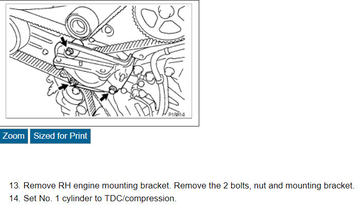

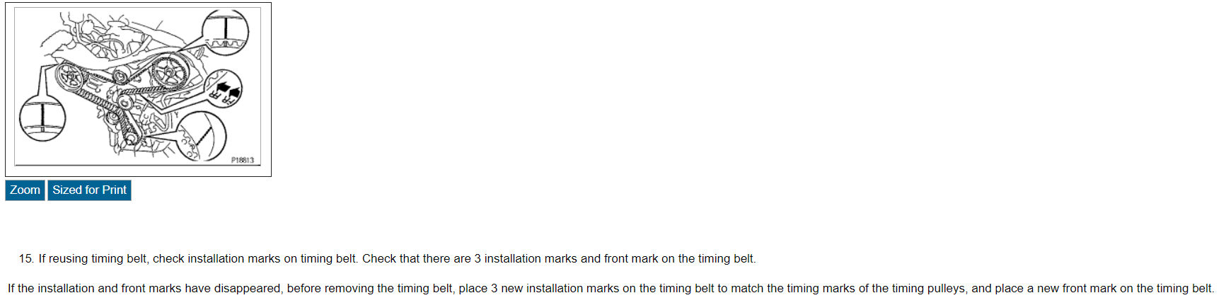

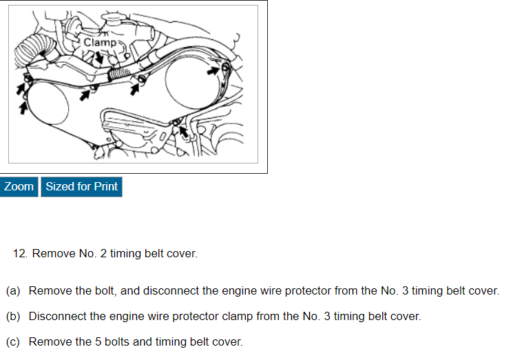

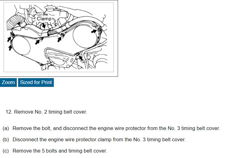

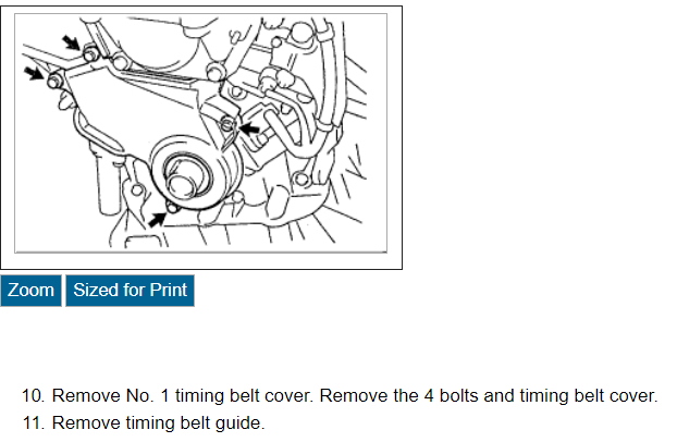

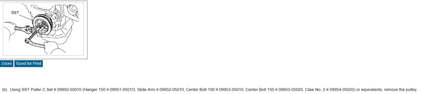

You will need to remove the front balancer. To get started here is a guide that will show you how and the diagrams on how to change the timing belt and tension-er:
https://www.2carpros.com/articles/how-a-harmonic-balancer-works
Monday, June 25th, 2018 AT 11:50 AM
WILLIAM CRABTREE
  • 95 POSTS
I have done the timing belt prior to the first post on this issue. The car was making noise before the timing belt. I installed a new water pump, timing tension-er, and timing idler. Did not do oil pump.

Okay, the long awaited update. I have replaced the trouble motor mount. Still had noise. Took the car to a transmission shop and turns out the flex-plate is bad. So that is going to be a fun repair!
