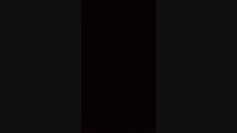

I can change temperature okay hard to tell due to how much air comes out, but it feels okay. It is a dual climate system, and the driver side lets out a little air, the passenger side lets out no air it feels like. I can change the direction of the air fine. The video attached is changing the speed from about 70% to 100%.

Wow, I heard that. That noise isn't one of the actuators. It sounds like the fan is hitting something. If you get under the dash on the passenger side, place your hand of the blower motor and see if you feel a vibration when that sound is heard.

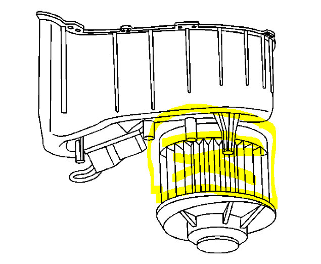

If placing your hand on it lightly caused it to get worse, it sounds like it may be loose. Check to make sure everything is tight. If it is, then remove the blower motor and inspect it to make sure the fan is properly attached to the blower motor shaft.
I attached a pic below and highlighted the fan portion of the unit. Check that to make sure it is okay and check if it is rubbing something in the housing.
See pic below.

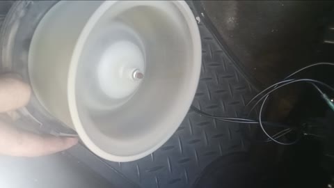

It spins okay not the best. It has a little bit of wobble to it but I'm not sure how much room for error there is in the housing. When I lift or push on it though, it makes a sound similar to what it did. Would it just need tightened?
Wednesday, October 11th, 2023 AT 2:24 PM
  • 110,194 POSTS
The play shown in the video really isn't odd and at this point, isn't a concern. As far as the housing, is there any evidence that it was rubbing?

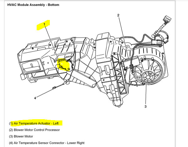

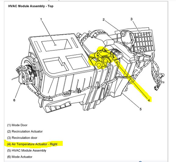

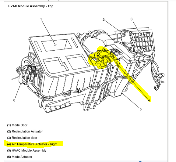

I am leaning towards the actuators, like you mentioned. Since I have a dual climate control, would there be 2? If there is, would one cause the other not to work?
Thursday, October 12th, 2023 AT 8:32 PM
  • 110,194 POSTS

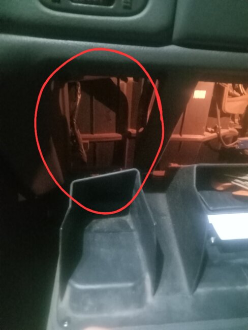

There are two. I attached two pics below showing the location on both sides. Since the noise came from the center, I suspect it could be related to the right-side actuator. Locate the actuator and see if it vibrates when you hear the noise.
Thursday, October 12th, 2023 AT 8:57 PM
JACOB MARINO
  • 45 POSTS
It vibrates right here. It's on the left side behind the glovebox. I haven't had time to check really anywhere else yet but I will keep looking.
Sunday, October 15th, 2023 AT 1:25 PM
  • 110,194 POSTS
If I had to guess, I would think it is one of the actuator motors. They have plastic gears in them that fail. See if you can narrow it down to which one.
Also, that is the area where both are located. One is higher than the other (right is higher). Let me know what you find. Note: If you can't tell the difference in the vibration, disconnect one at a time to see which one eliminates the noise.
Sunday, October 15th, 2023 AT 2:00 PM
