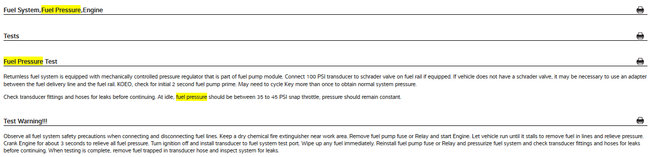

It now randomly shuts off (while driving). It will restart after sitting (no regular time frames noticed to restart). No specific weather noticed. As it shuts off it "bucks" as if downshifting or going to neutral. Sometimes it will start right up or make you wait for hours (although it does crank) I am only getting the "12 and 55" codes. The battery tests good, and has new connectors. No check engine light showed.

Thanks for using 2CarPros. When it's acting up, check the fuel pressure. You can get a fuel pressure test gauge from the local auto parts shop's loan-a-tool program for free. That pump pressure should be at least 34-45 psi when the engine is idling, and 5 or 6 psi higher with the key turned on, engine off.
Chrysler's test is included in the attached image. Ours can be found here: https://www.2carpros.com/articles/how-to-check-fuel-system-pressure-and-regulator
Check the pressure when it's running well and starting the way it's supposed to, and then again when it dies and won't restart. Record pressure for when the key is on and engine off, and when it's idling. I'll bet there's a big difference. If so, we'll go through how to change the fuel pump.
