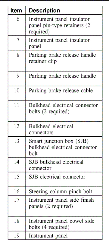

Heater core replacement instructions please?
JANSHE07
  • 2011 FORD TAURUS
  • 10,000 MILES
I have coolant leaking on the floor passenger side and need to replace the heater core can you help?
Wednesday, August 31st, 2016 AT 5:20 PM
11 Replies

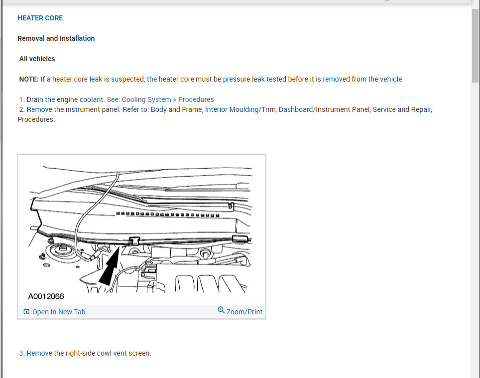

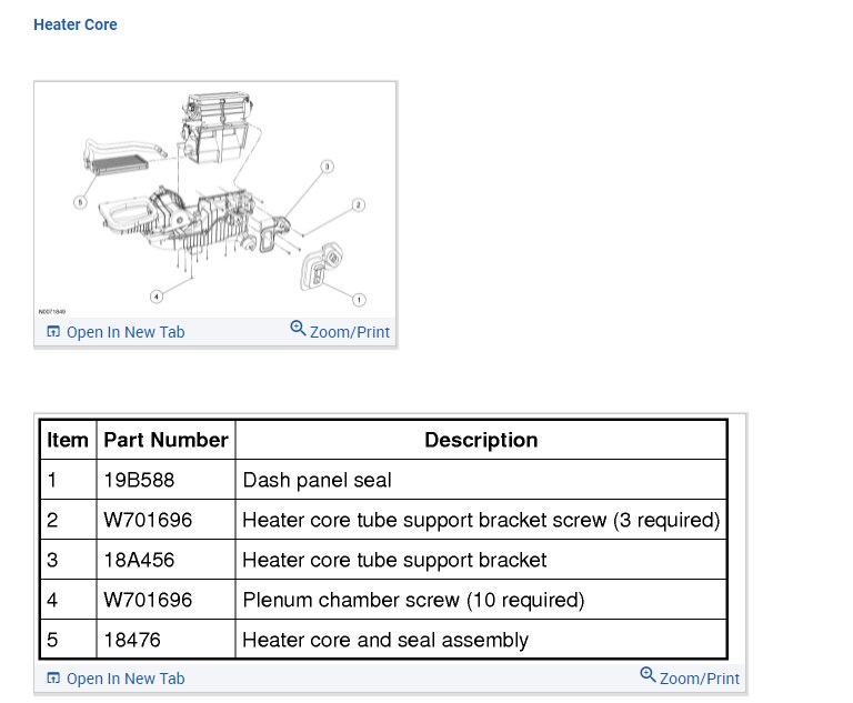

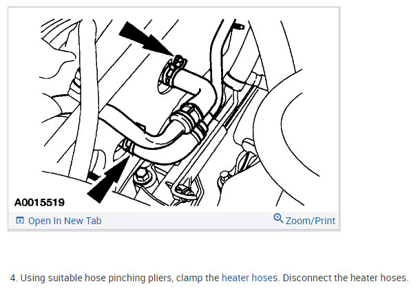

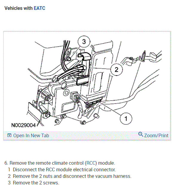

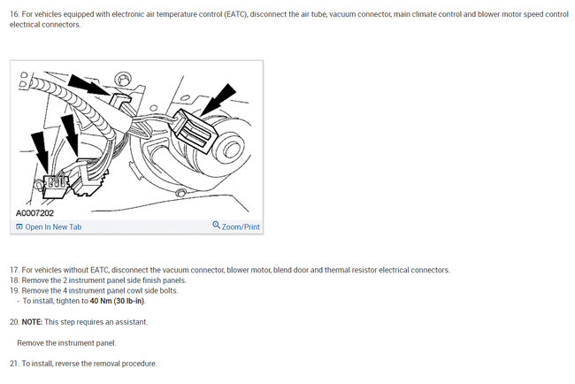

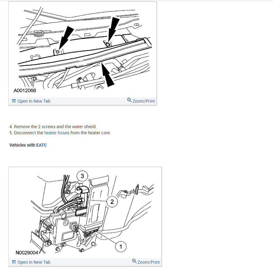

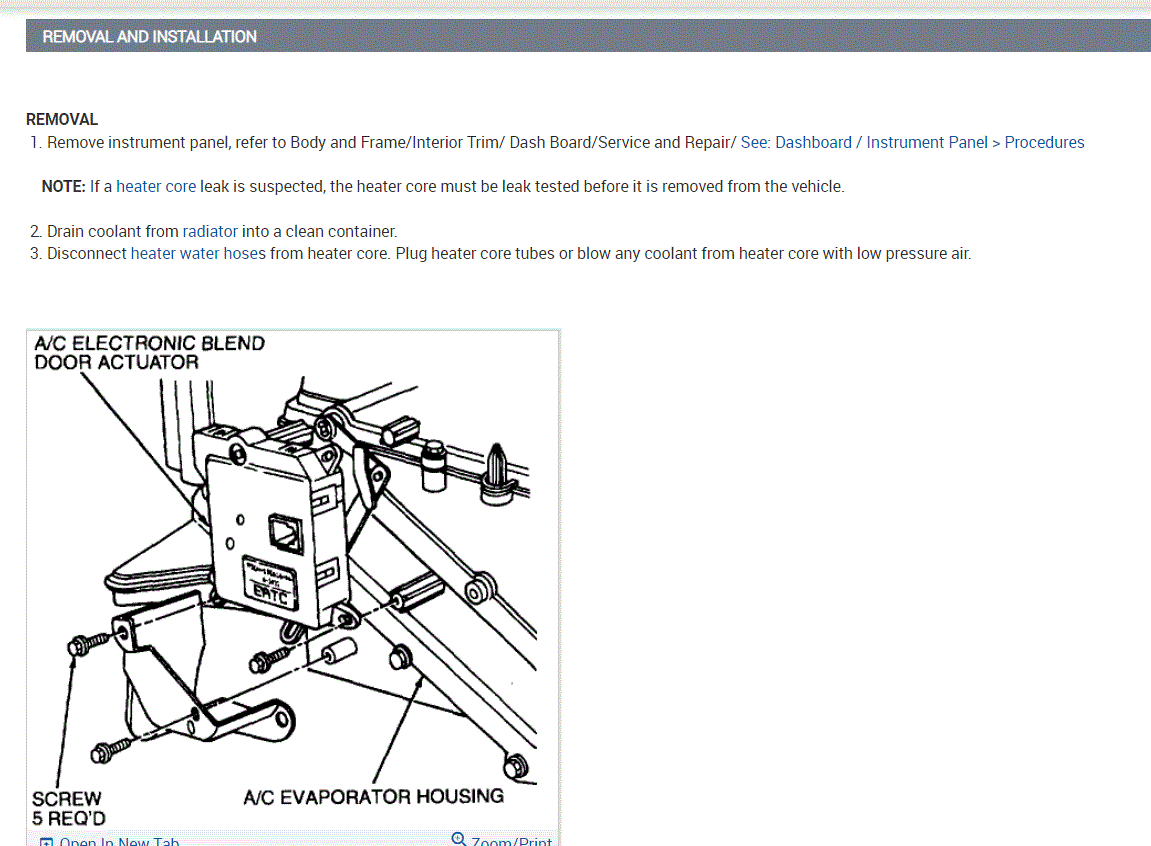

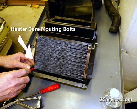

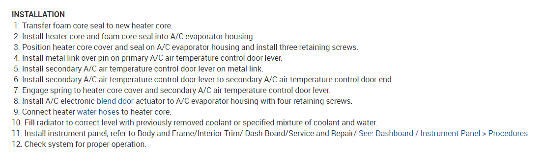

It does sound like the heater core is leaking so I would recommend we replace that. Here is a guide that will help with this:
https://www.2carpros.com/articles/replace-heater-core
Please find the process from the manual below that will help with replacing the heater core. Please run through this material and let us know if there are questions. Thanks

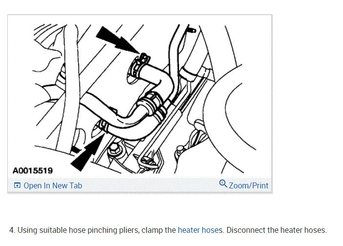

Here is a guide that will help with step by step instructions on this process:
Below is the process from the manual that will give the detail that is needed to replace this.
Please let us know if you have other questions. Thanks

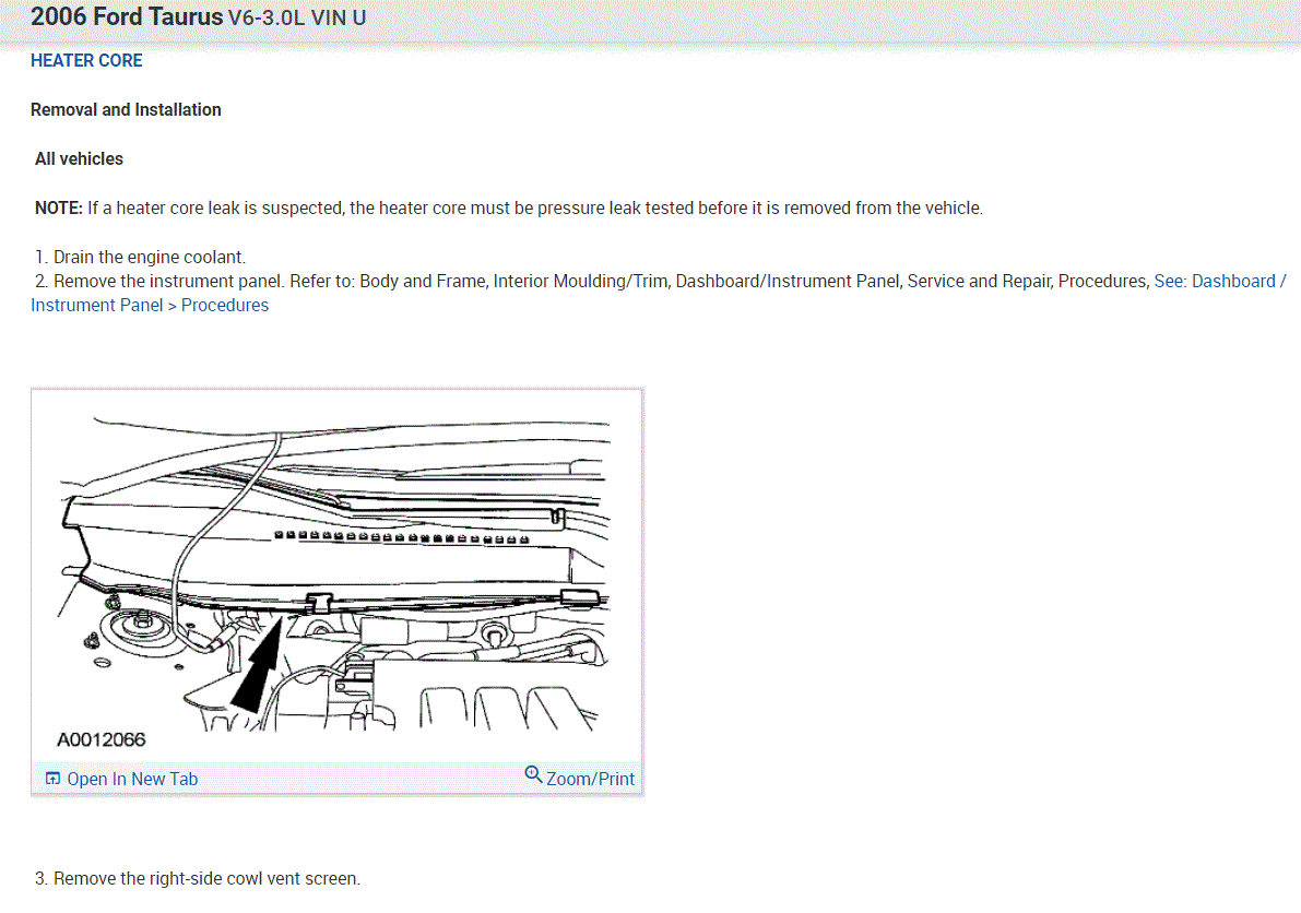

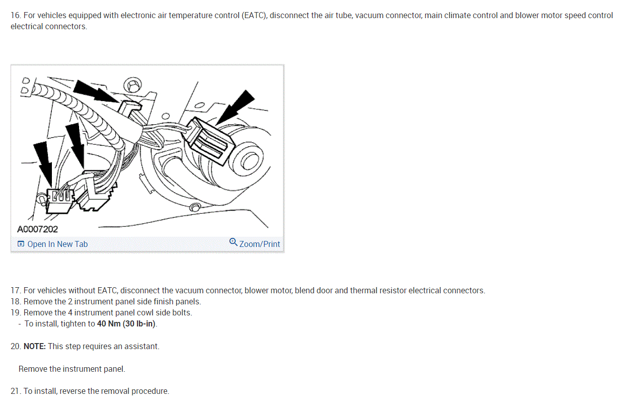

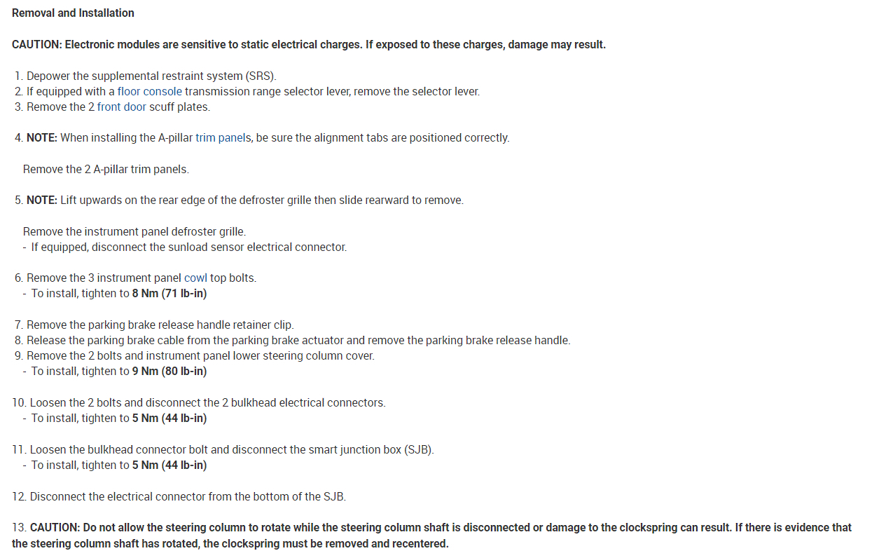

NWALKER30
  • 2006 FORD TAURUS
Recently purchased my 2006 Ford Taurus from a dealership about 7 months ago. In late October I noticed a big puddle of liquid in the passenger side floorboard of my car--we had had 2 days straight of heavy rain (Seattle!) So I figured maybe there was a leak in the hood and water was getting through and leaking into my car--(shows how much I know about cars). Anyways, in the beginning of December the puddle happened again and it had been raining all weekend as well so I thought it was the rain again. But I called a Ford Dealership and inquired and they told me it was the heater core and that my car was not driveable and if I continued to drive it I was going to overheat the car and possibly blow the engine. They also told me it was going to cost over $700.00 to replace. I found a mechanic to disconnect the heater core for me.A temporary solution to a big problem. My dealership warranty ended after 3 months. I am trying to find fault with them. How could a 2006 Ford Taurus with only 30,000 miles (had 30,000 when I purchased it) be needing such a huge repair at this time? I am trying to figure out wear and tear of the heater core and things of that nature.
Thanks so much!
Nyiesha Walker
Wednesday, July 28th, 2021 AT 11:50 AM (Merged)

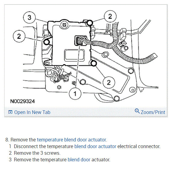

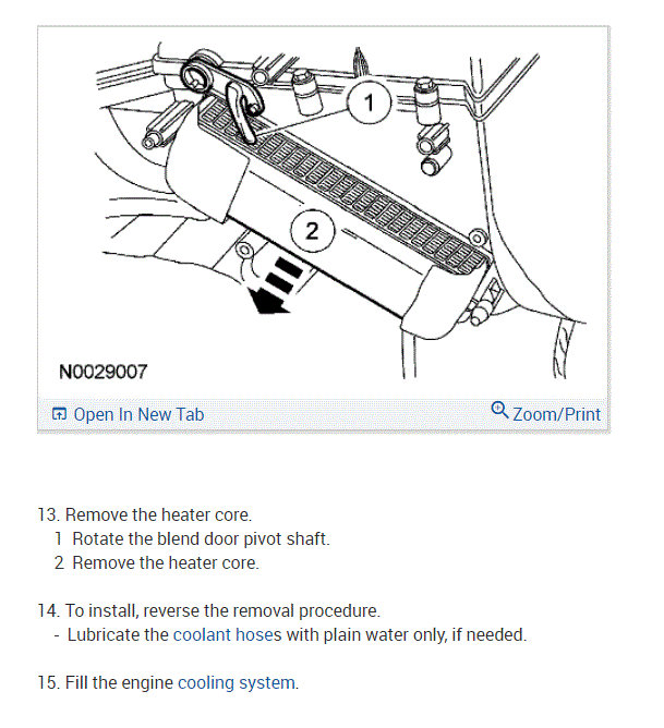

  • 110,189 POSTS

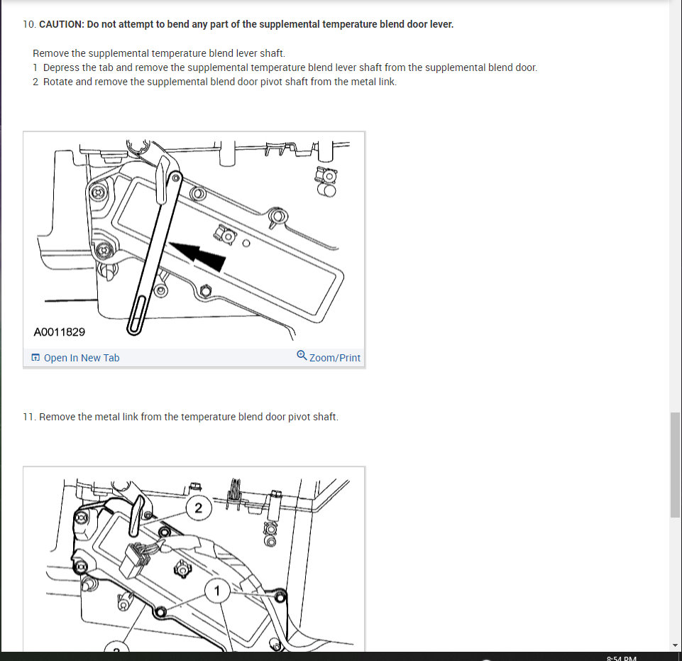

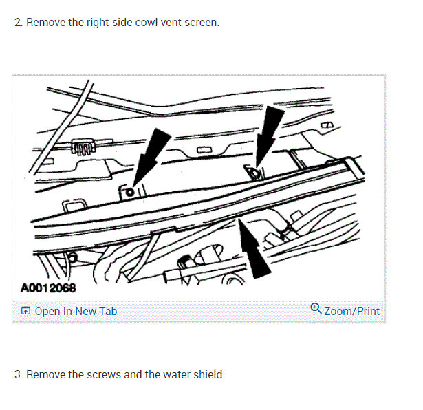

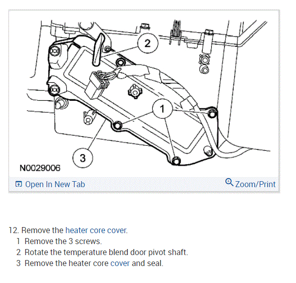

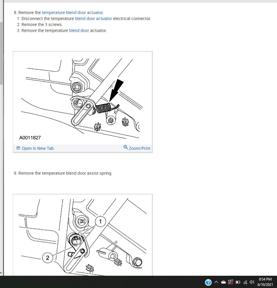

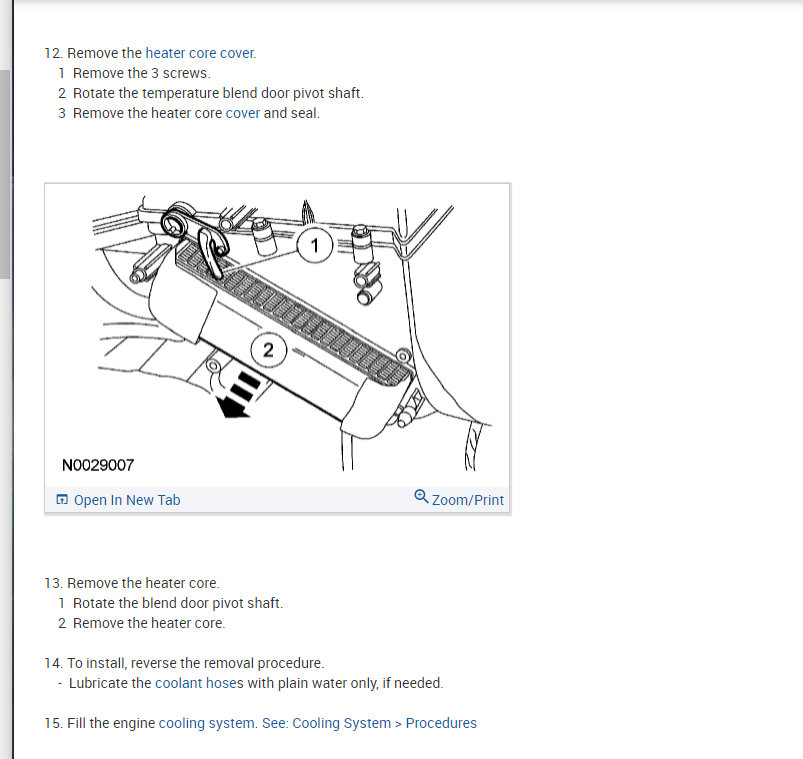

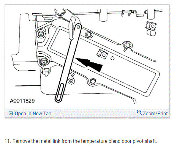

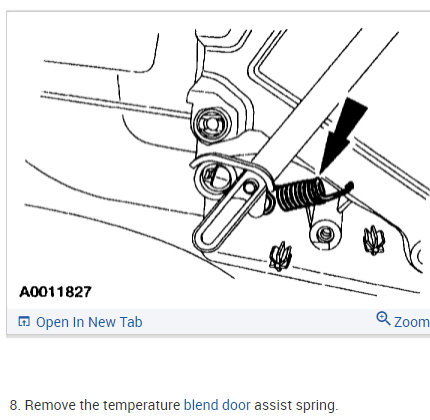

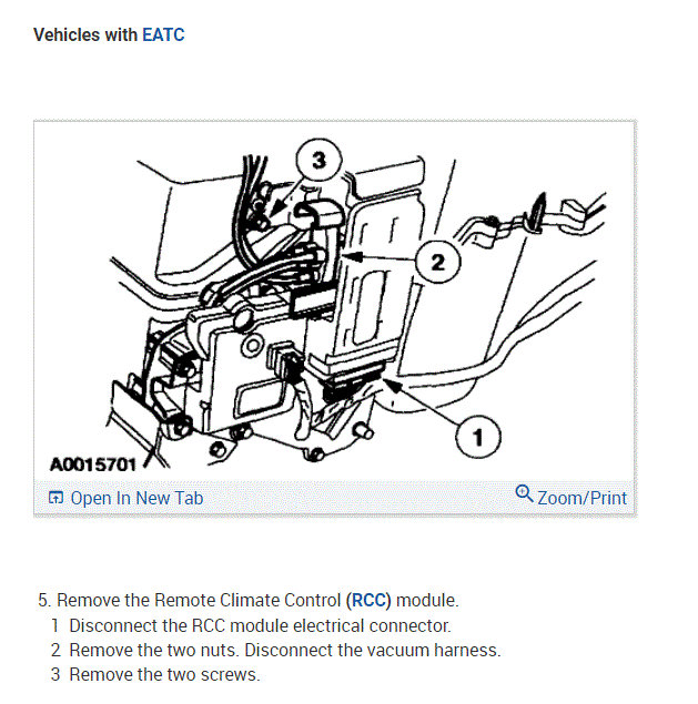

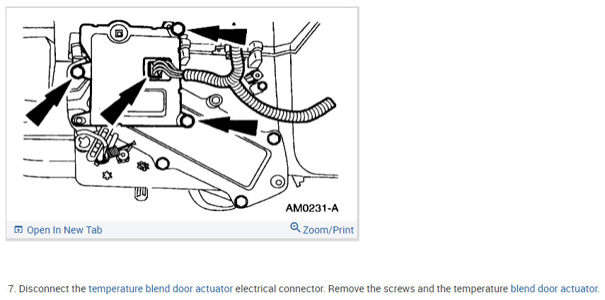

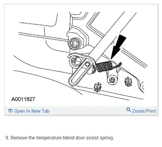

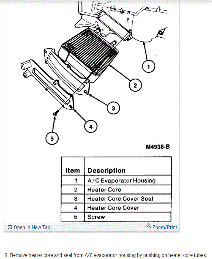

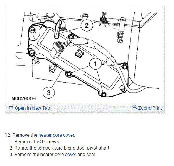

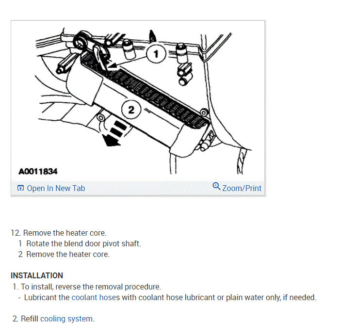

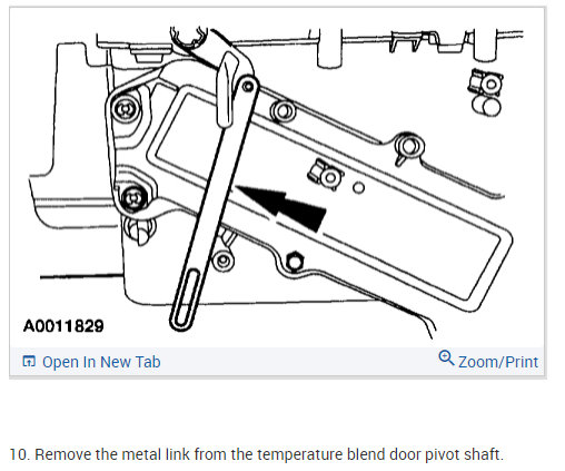

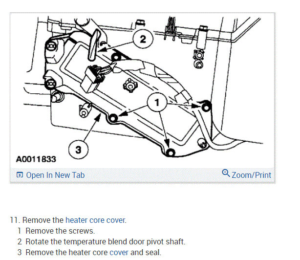

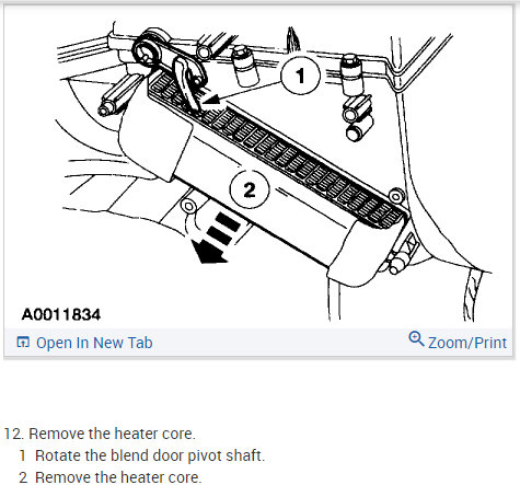

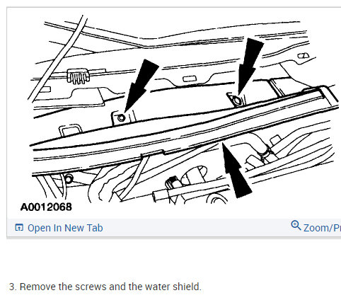

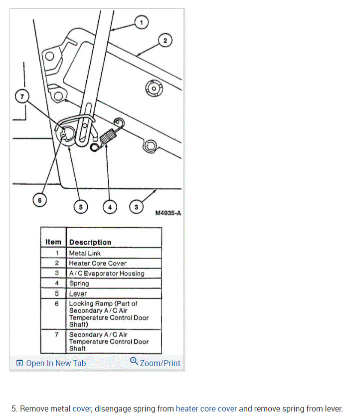

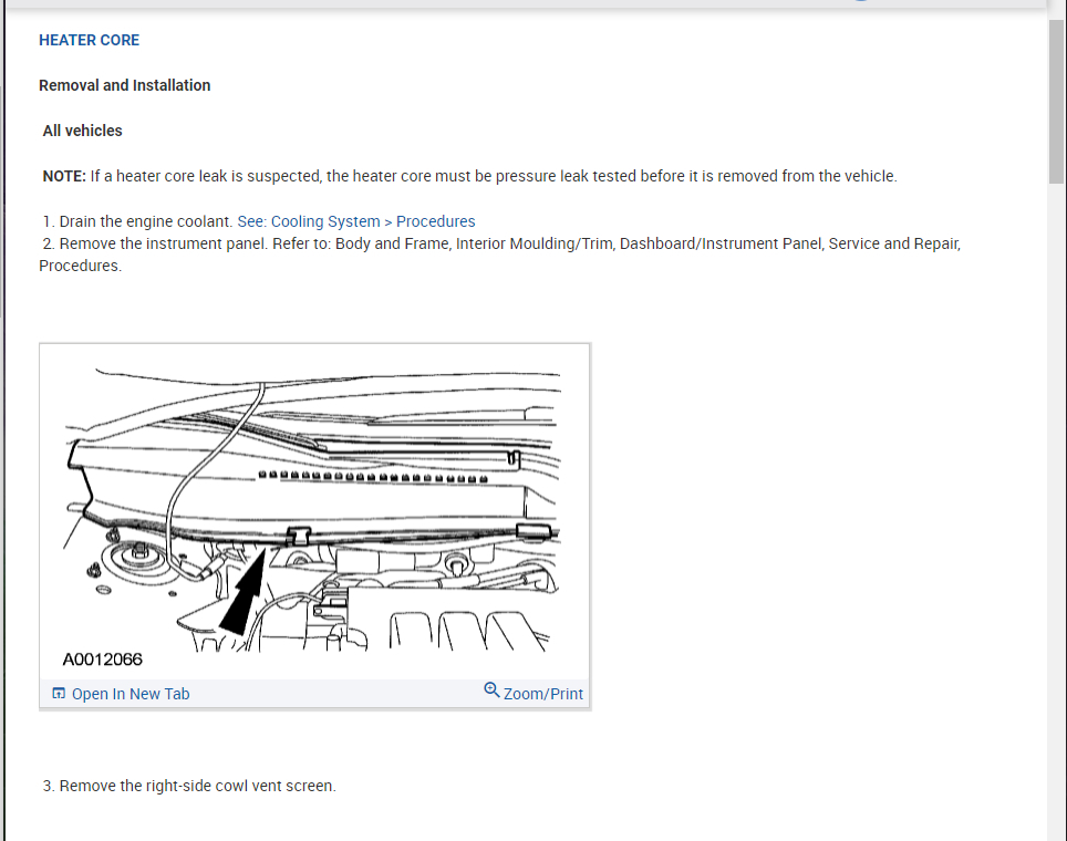

Replacing the heater core on this vehicle is a somewhat big job. However, take your time and follow the directions and you should be fine.
To get you started, here is a link that explains how in general it's done. You can use this as a guide.

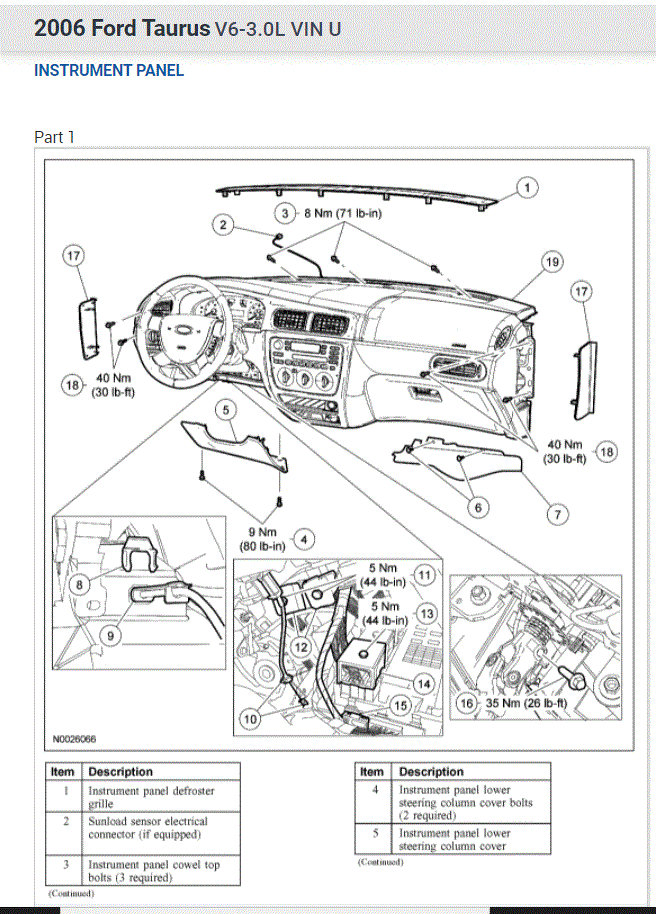

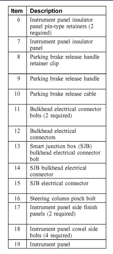

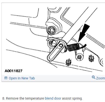

Below, I attached two different sets of directions. The first explains how to remove the instrument panel and the second is specific to the heater core.
-1

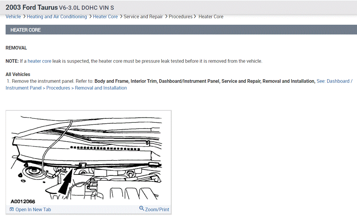

MOJOFAN74
  • 2003 FORD TAURUS
  • 6 CYL
  • 2WD
  • 106,000 MILES
Where is the heater core on this car I need to replace it.
Wednesday, July 28th, 2021 AT 11:51 AM (Merged)

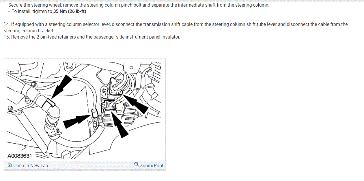

  • 110,189 POSTS

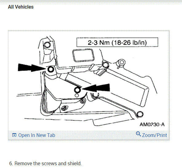

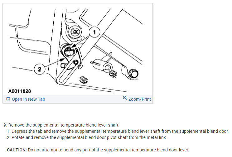

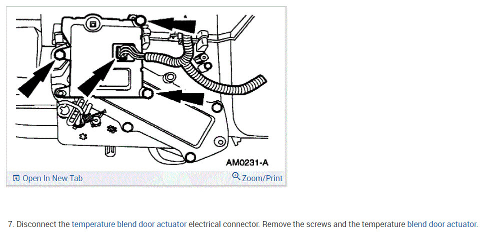

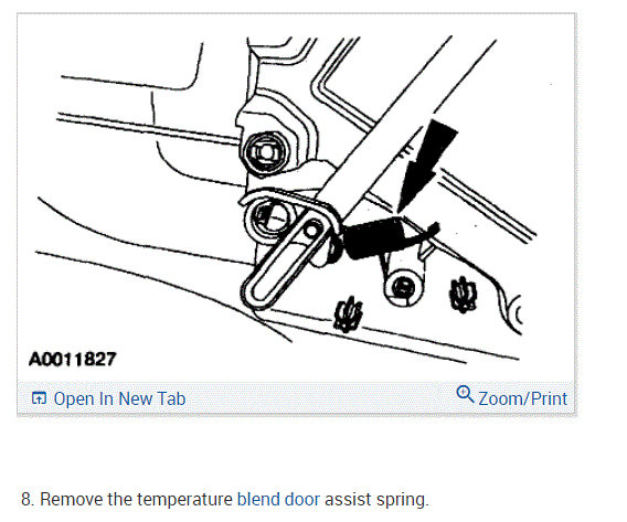

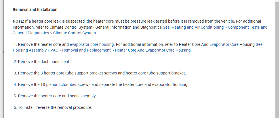

The heater core on this vehicle is located under the dash on the inside of the vehicle. To replace it is a little difficult, but if you take your time and follow the directions, you should be fine.
To get you started, here is a link that explains how in general to replace one. You can use this to help guide the install.
If you look at the attachments below, they include the removal and install directions specific to your vehicle.
Take care.

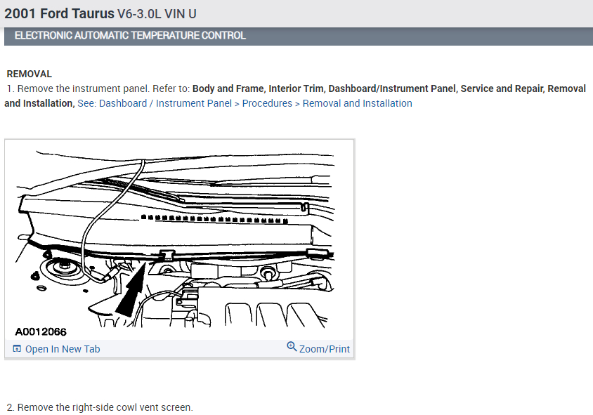

MGMMMA
  • 2001 FORD TAURUS
  • 6 CYL
  • FWD
  • 62,000 MILES

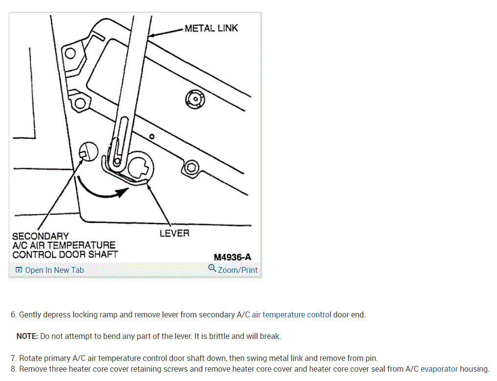

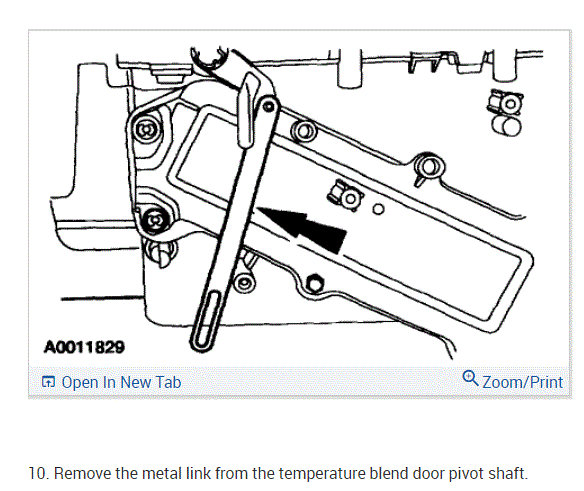

Can not remove heater core from car, we have everthing disconnected and the Heater core hits the dash frame work and I can not find how to get the clearence needed to remove the heater core?

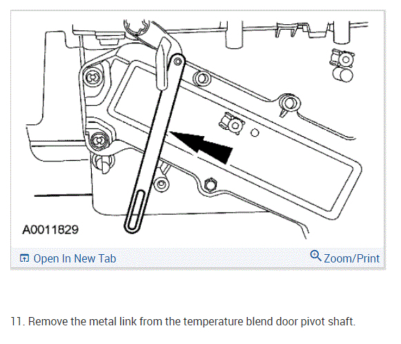

DANNY L
  • 5,648 POSTS
Hello, I'm Danny.

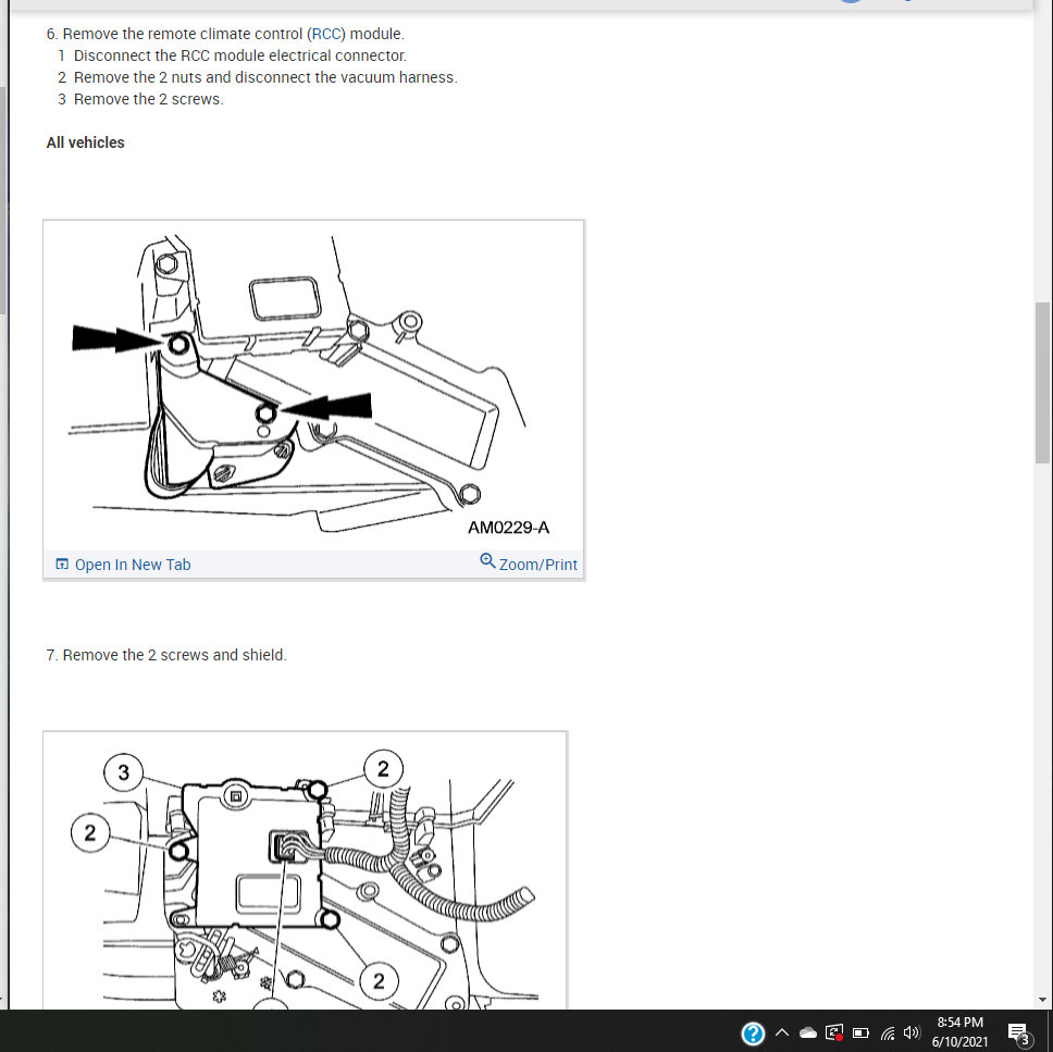

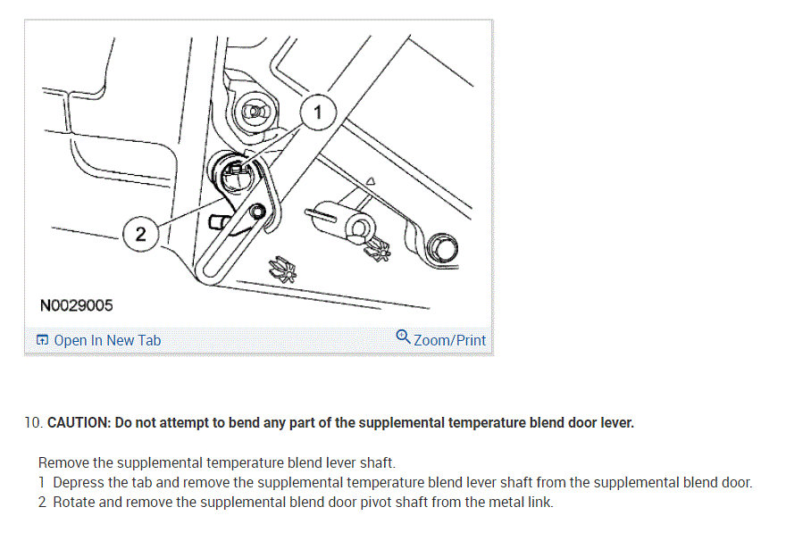

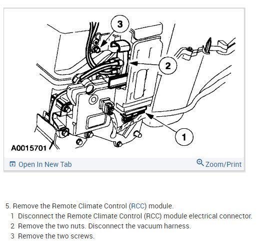

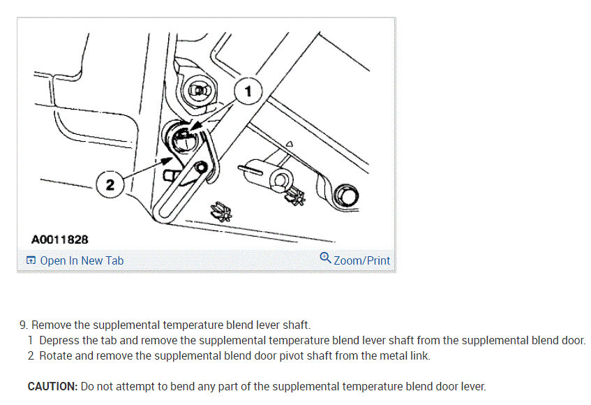

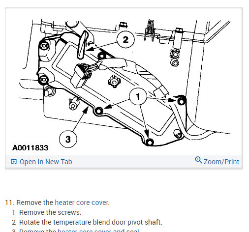

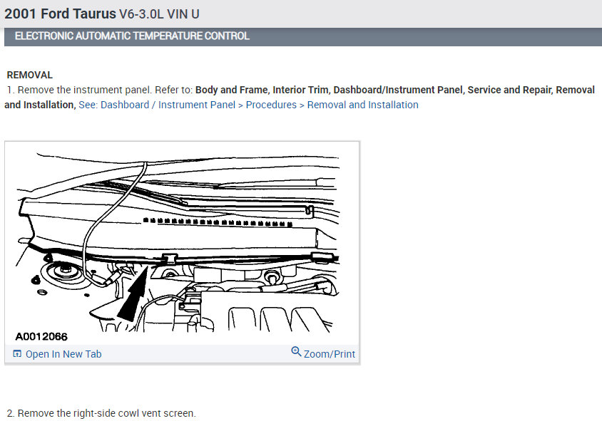

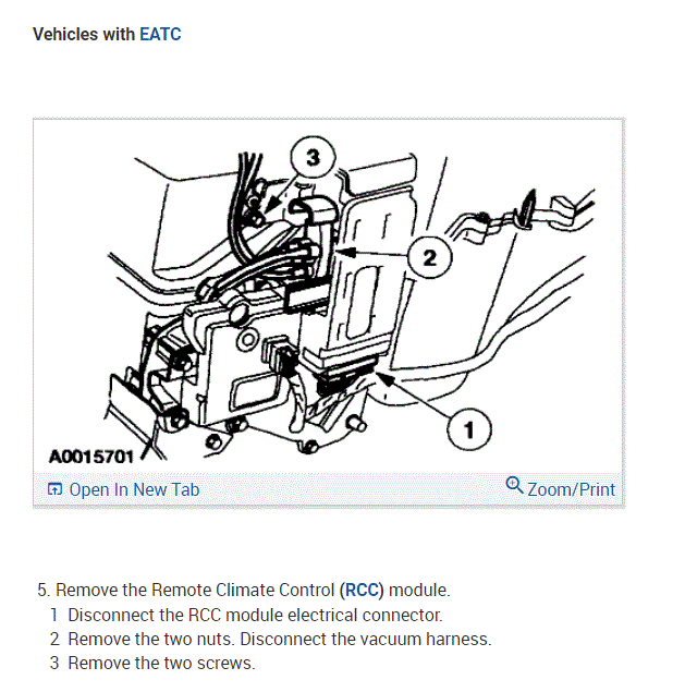

Here is the information you requested. Here is a tutorial for you to view showing how to remove and replace a heater core:
I've attached picture steps below on how to remove and replace the heater core on your car. This for an automatic climate control system. Hope this helps and thanks for using 2CarPros.

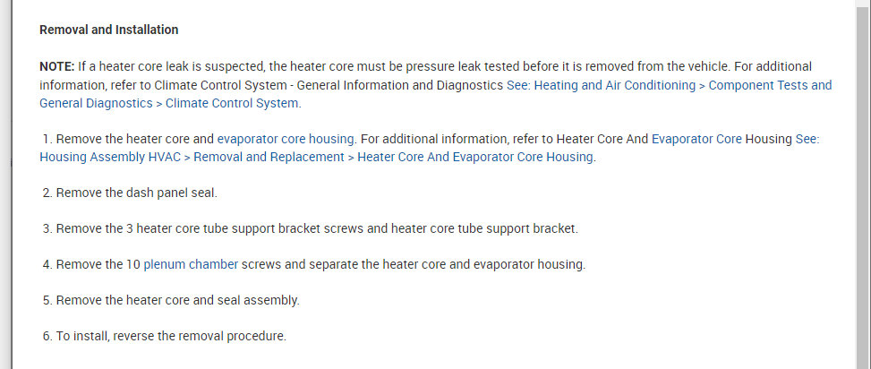

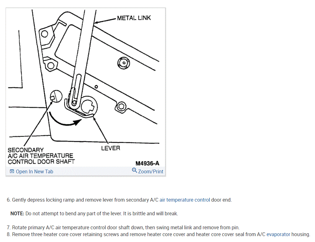

  • 110,189 POSTS

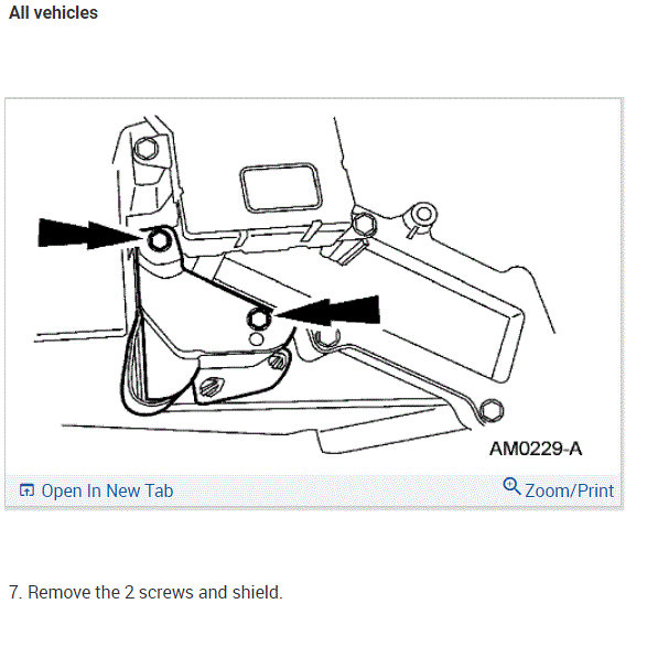

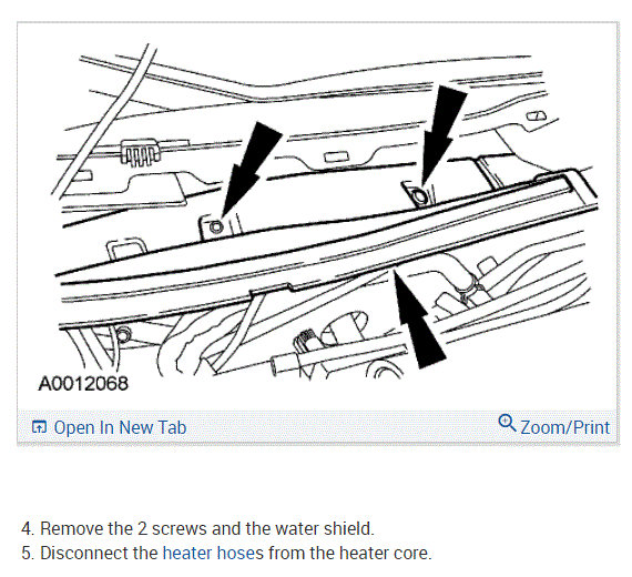

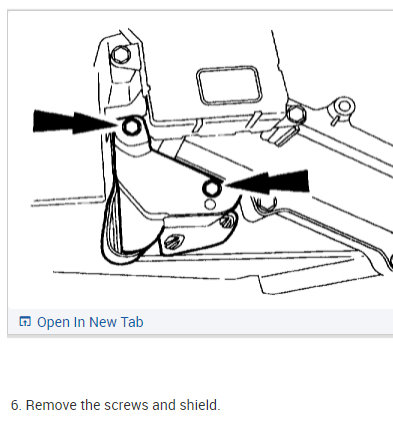

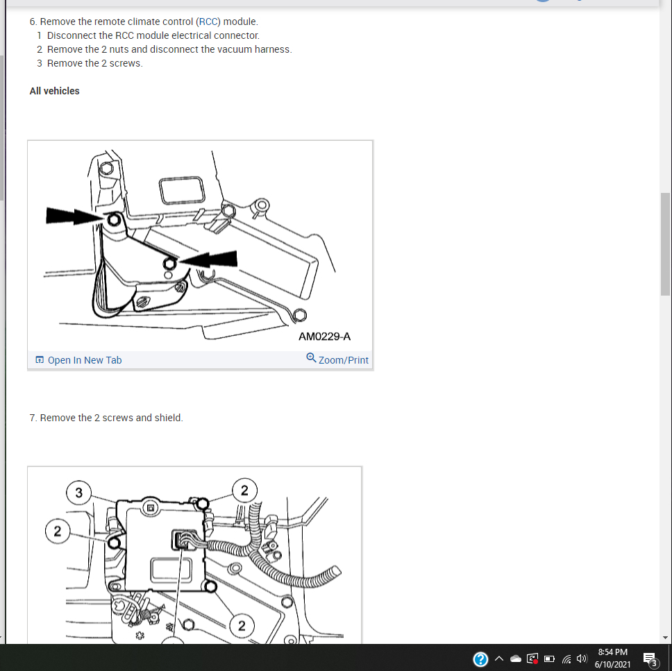

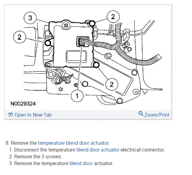

The heater core is located under the dash on the passenger side of the vehicle. Removal is a little involved, but if you take your time, you should be fine.
To get you started, here is a link that explains in general how one is replaced. You can use this as a guide.
If you look at the attachments below, they provide the directions specific to your vehicle for removal and replacement.
