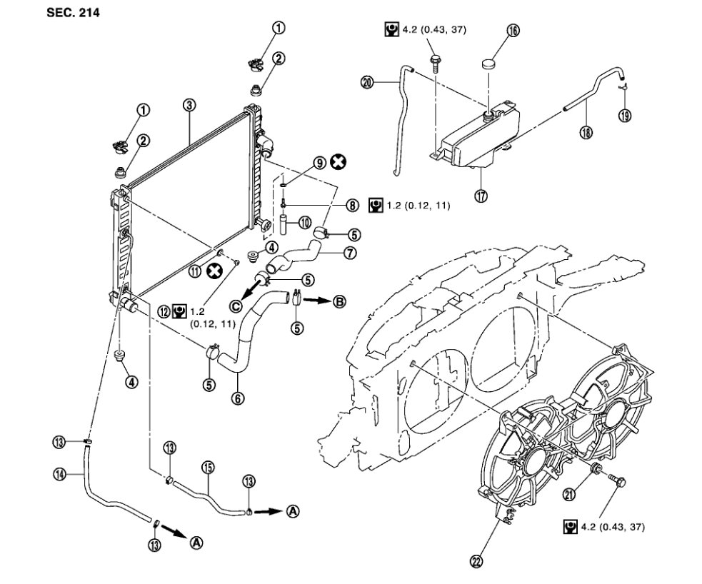

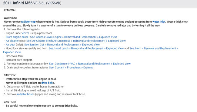

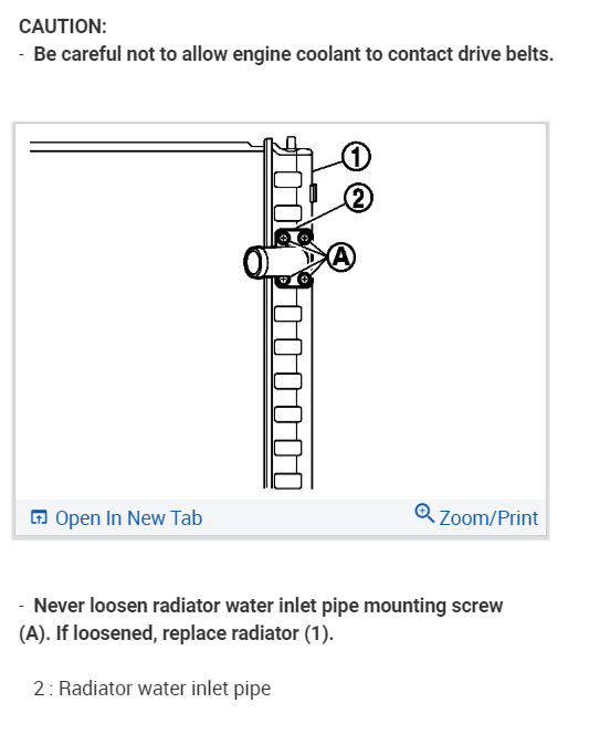

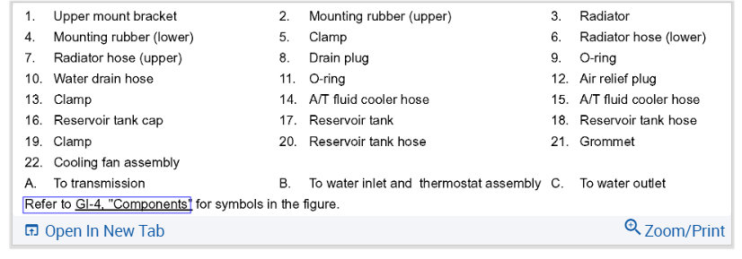

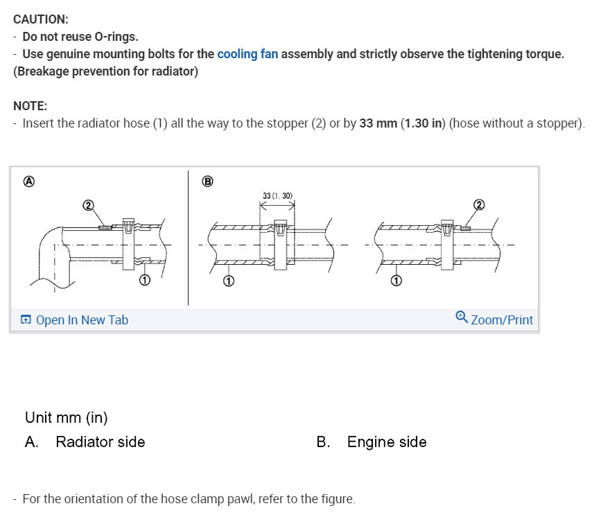

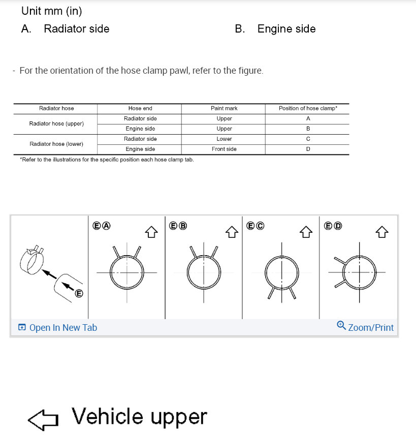

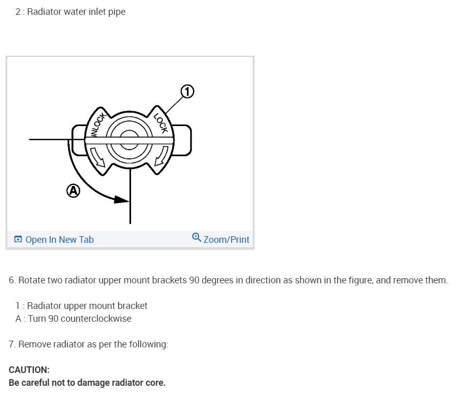

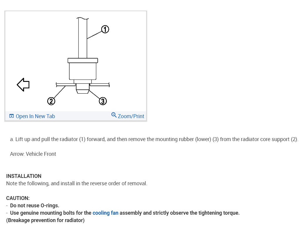

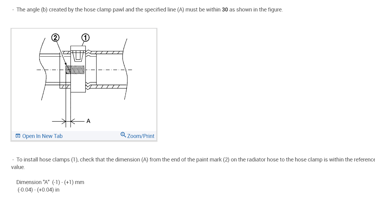

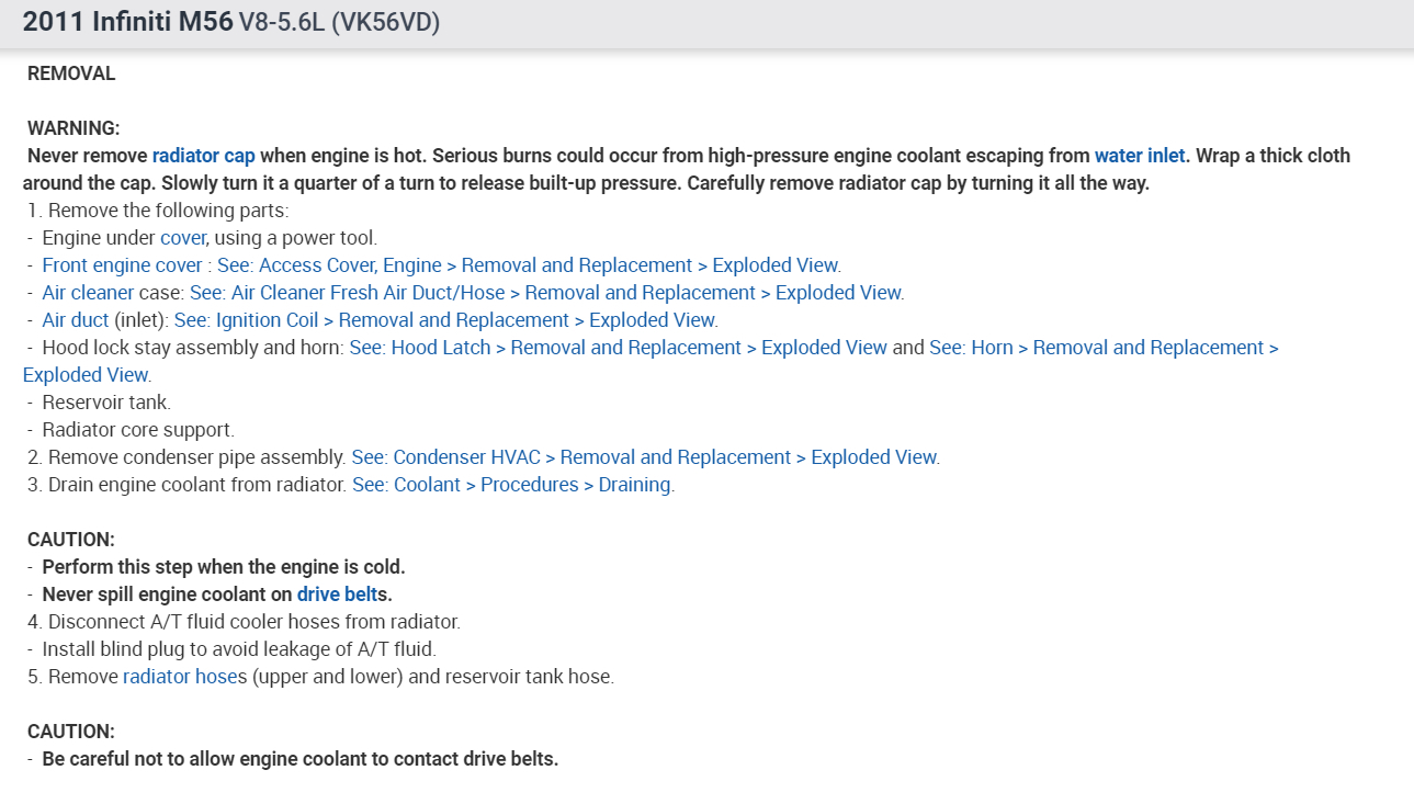

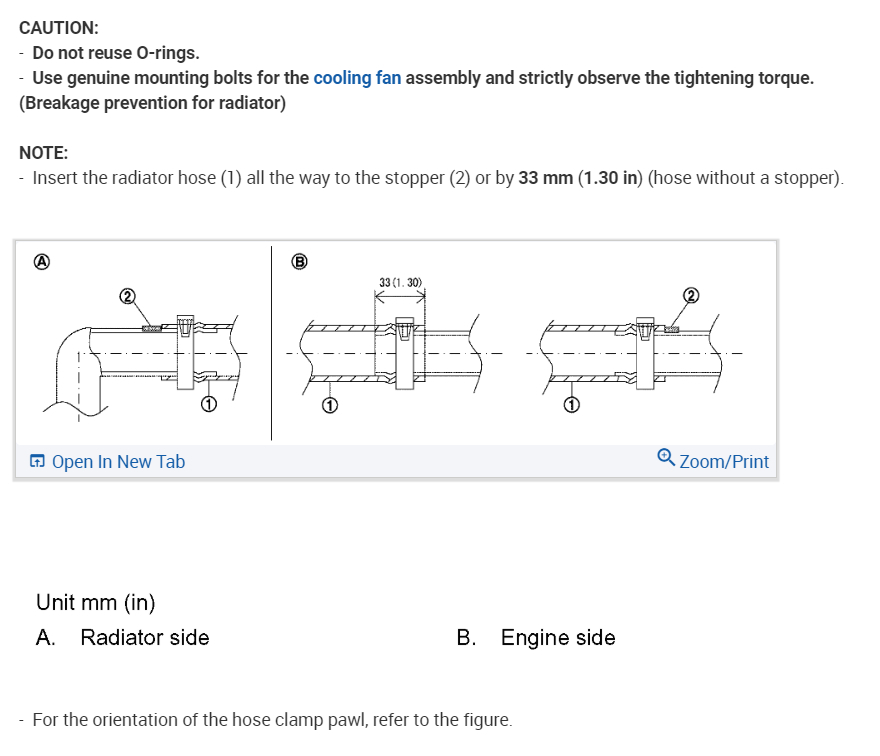

Yep, this is common. here is a guide to help walk you through the repair with instruction in the diagrams below to show you how on your car:
https://www.2carpros.com/articles/how-to-replace-a-car-radiator
They have some pretty specific instruction on how to install the new radiator or it will leak. Check out the diagrams (below). Please let us know what happens.
Wednesday, January 29th, 2020 AT 9:07 AM

Thank you for the diagram.
