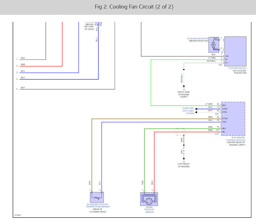

I just found out the car overheated and noticed the fan is not running. i replaced a temperature sensor. It didn't work but unplugged the sensor puts the fan in motion what can be the problem??

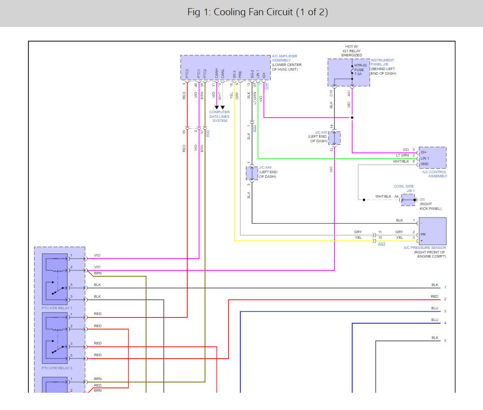

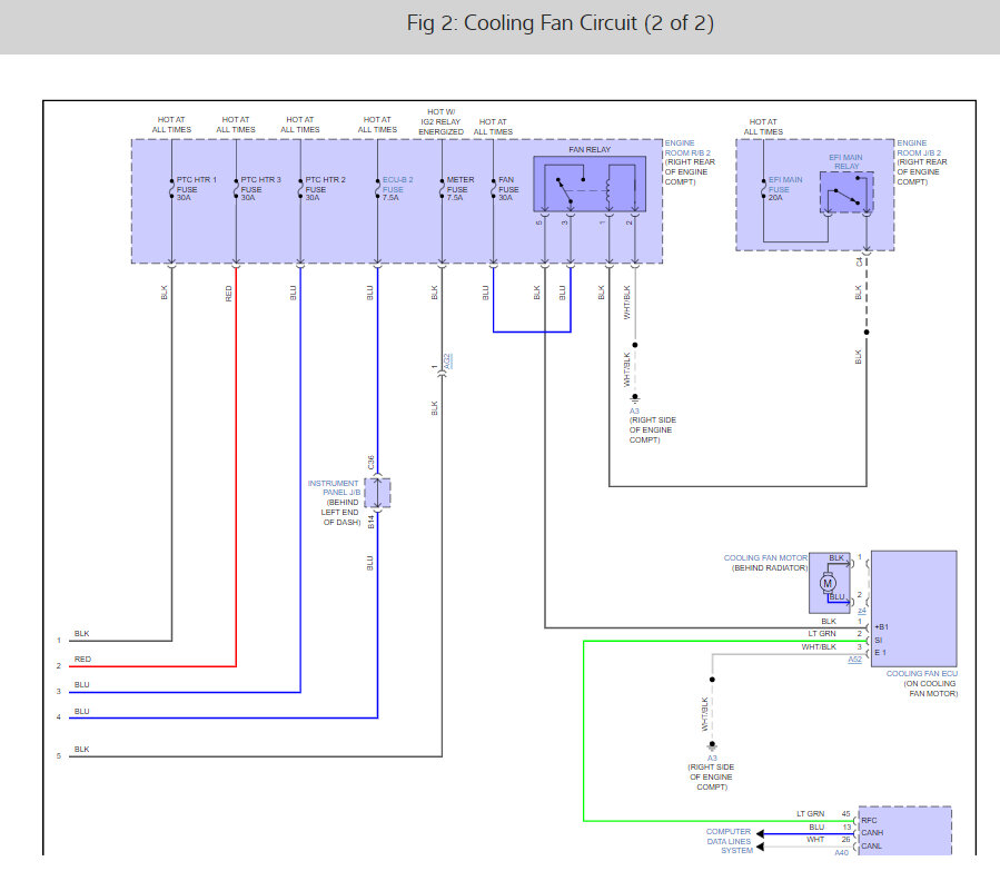

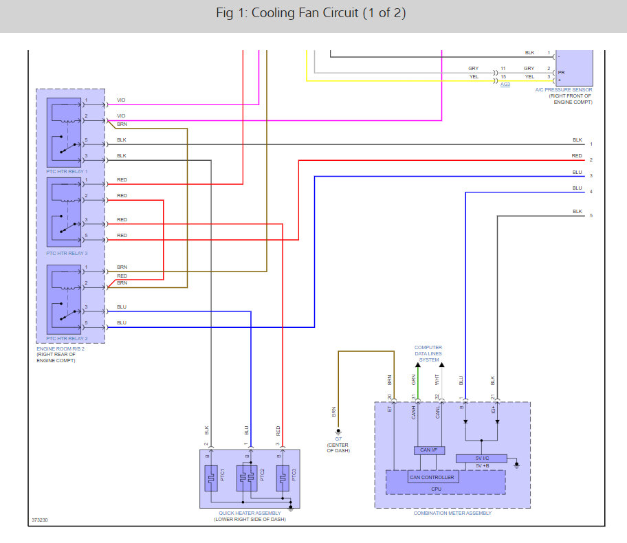

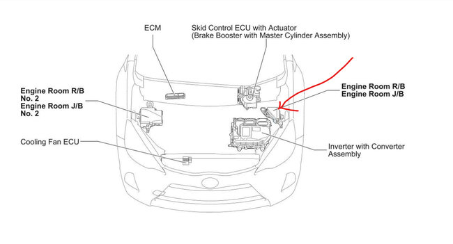

I have seen cool fan control module cause this problem, but first we need to check all fuses in the system (8). here is a guide to help and the fuse locations in the images below. I have included the cooling fan wiring diagrams to help you see which fuses need to be tested and how the system works. Also, have you run the codes to see what comes up? I would do a CAN scan. You can get a CAN scanner (Controller Area Network) from Amazon.

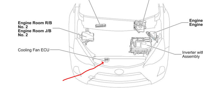

Here is the location of the cooling fan module as well in case you need to change it out. Check out the images (below). Please let us know what you find. We are interested to see what it is.

Hello Ken,
I checked fuses and relays they are all fine. I changed the fan control module with no positive results and changing engine ECU has not help too. But the green wire from engine ECU to fan control module reads zero volts against ground and 12 volts against positive. What could be the problem now? Please help.

It could be the cooling fan relay diode is out and back feeding into the electrical system. here is the location so you can swap it out to see what happens. The only other thing I can think of would be the gauge cluster. Please let us know what you find.

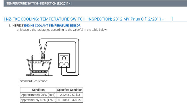

I want to give feedback. I started the car and idled it. The fan came in after a long time and the coolant almost to boil the fan changes speeds then finally it burst into very high-speed follow by engine shutdown. This is happening with or without temperature thermostat now I am confused but there is no signs of head gasket failure because when i unplug the temperature sensor electrical socket fan and water pump are all moving and i can travel any long distance in mountains with no problem i am now suspecting the pump does not function properly when a temperature sensor is connected and i want to know how can i test this temperature sensor with a multimeter to see if they are health?

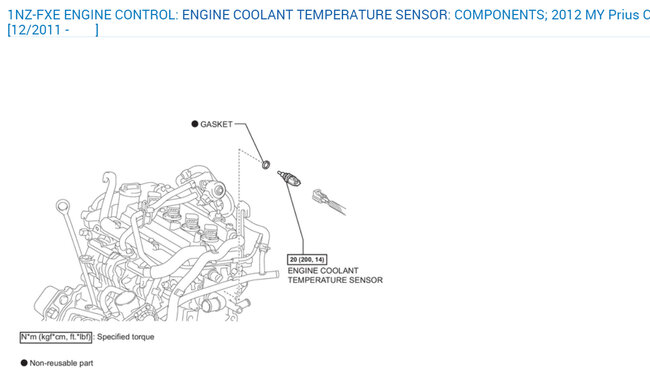

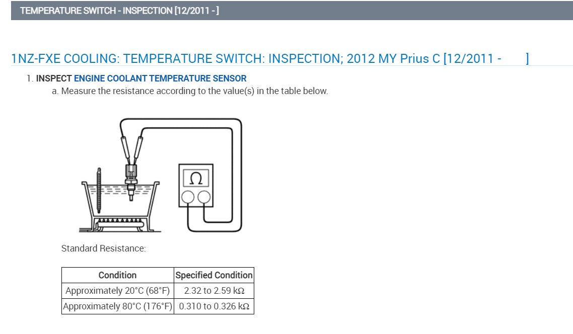

Sure, here is the engine coolant temperature sensor location with how to test it as well. Check out the images (below). Please let us know what you find.

The temperature sensor test results were as good as on the chart you gave me against 20- and 80-degree Celsius but still i don't know what is happening because when i put a sensor on the socket and heat it with candle while the car is on the pump runs and the fan two.

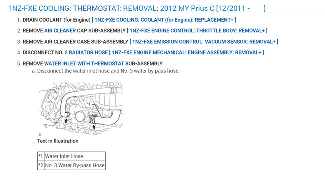

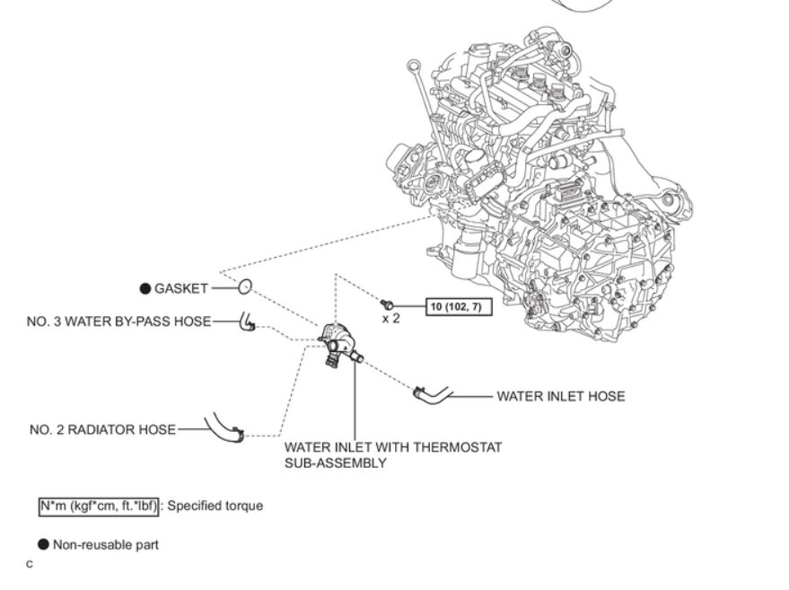

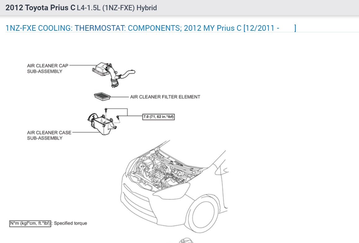

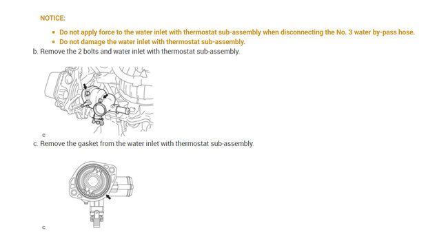

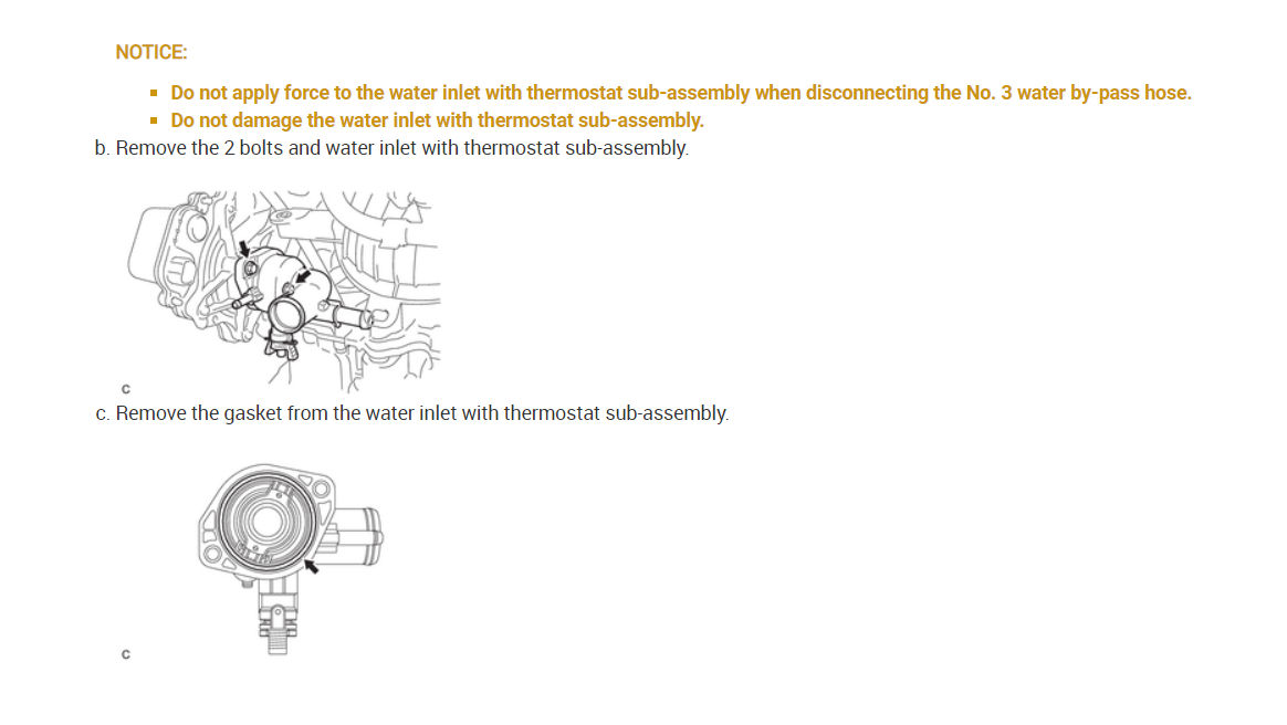

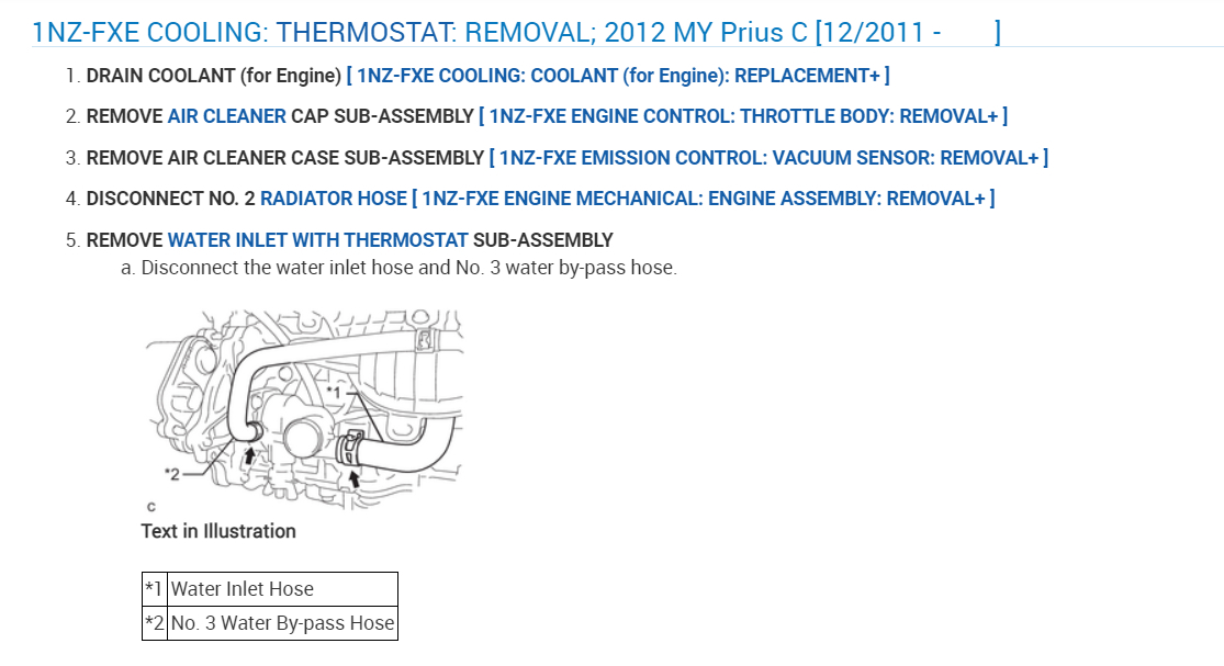

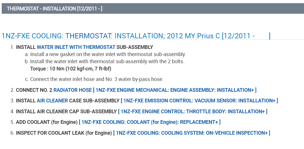

It sounds like the engine cooling system thermostat is stuck. Here is the location so you can check it out or replace it. Here is a generic guide to help walk you through the steps and the instructions to help you do the job on your car in the images below.
Make sure the weep hole in the thermostat is facing upwards. Check out the images (below). Please let us know what happens.

Thanks, you for your assistance after following what you have been sending to me i finally found that coolant pump was fault. it was sometimes run perfectly and got stack the other time so cussing high temperature so i replaced with another one which is running properly and things are normal but still i have some issues with hybrid sytem and check engine warning lights i will send you the picture of multimformation display and the codes generated apon Obd diagonistic. Thank you.
