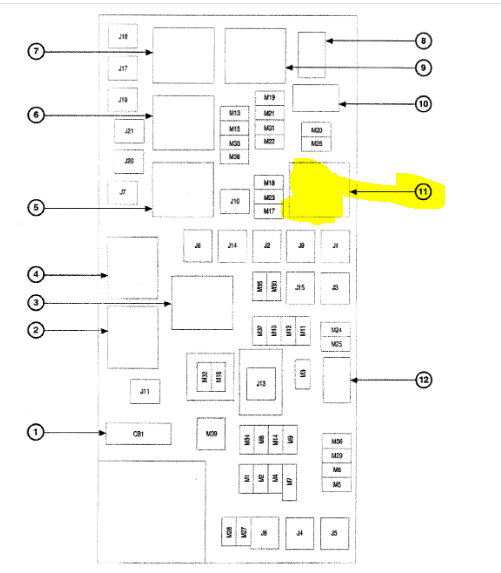

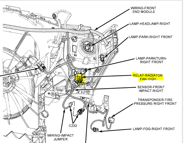

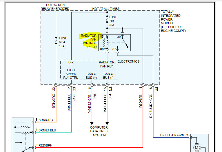

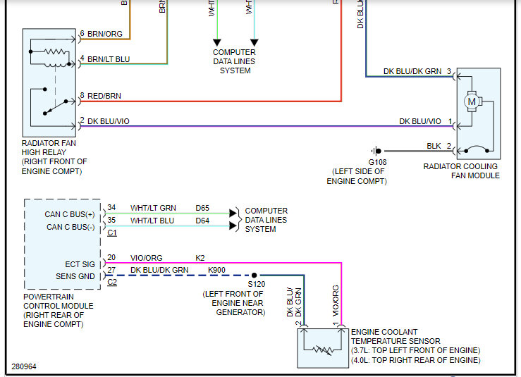

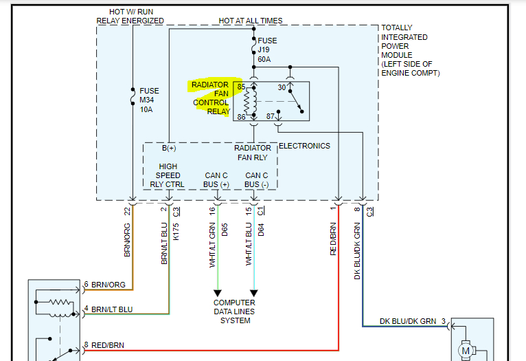

Always running indicates a short to power. This could simply a damaged fan relay. On this vehicle there are two. One is located on the passenger side engine compartment and mounted on the radiator support. The other is in the integrated power module under the hood also.
I attached the wiring schematic below as well as the relay locations. Remove one at a time and shake them to see if anything sounds loose. Also, here is a link that explains how to test a relay and its circuit:
Let me know what you find. Please also note there could be a short in a wire connector at the integrated power module. They are known to corrode, break, or simply stop working.
