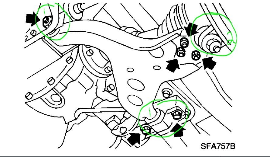

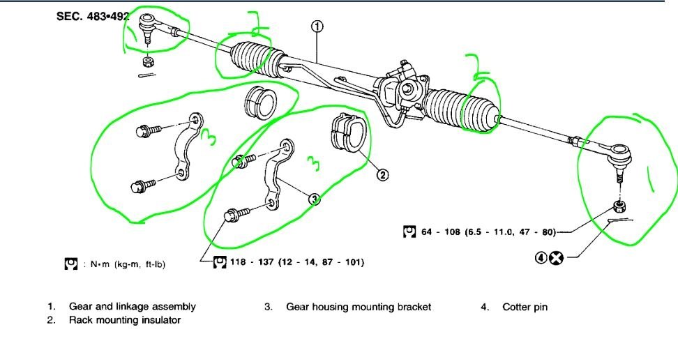

Have you checked all steering components including tie rods, ball joints, wheel bearings, and made sure the steering gear isn't loose? This sounds dangerous. What I need you to do is safely lift the front of the vehicle so one wheel at a time is off the ground. Place your hands at 3 and 9 o'clock and see if you can wiggle what wheel back and forth without the other wheel moving. Next, place your hands at 6 and 12 o'clock and see if there is up and down play in the wheel.
If you look at picture 1, it shows the rack and pinion, tie rods, and mount bushings. I circled everything that needs checked for play. Number 1 represents outer tie rods, number 2 the inner tie rods which are under the rubber boots, and number 3 is the mount and rubber bushings that hold the rack on the vehicle. Check for play in any of those things.
In picture 2, check the areas circled for play. Number 1 shows the control arm bushings. Number 2 in the picture is the lower ball joint. Check for play there when your hands are at the 6 and 12 o'clock positions.
Please note that if everything is tight, check the frame for any rust issues.

Well the bearing are good. No movement in either of the wheels. Ball joint are tight. The control arm bushings are still good. Replaced them about a year ago. On the passenger side the boot over the inner tie rod is ripped and the rack bushing on that side is worn out, and not holding anything. Tie rod ends are good tight.
I didn't see any damage to the inner tie rod, bit don't really know what to look for.

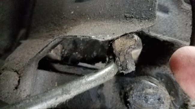

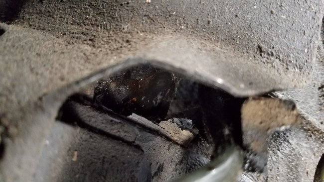

It sounds like you found the cause, the rack bushing. That is what holds the rack in place. If it is able to move, that is most likely the cause. As far as inner tie rods, you will see them move in and out while the other side doesn't move. Also, if you hold your hand on it, you can feel it.
If possible, take a picture of the bushing you are referring to and upload it for me to see. It will help me confirm the issue.

In place.

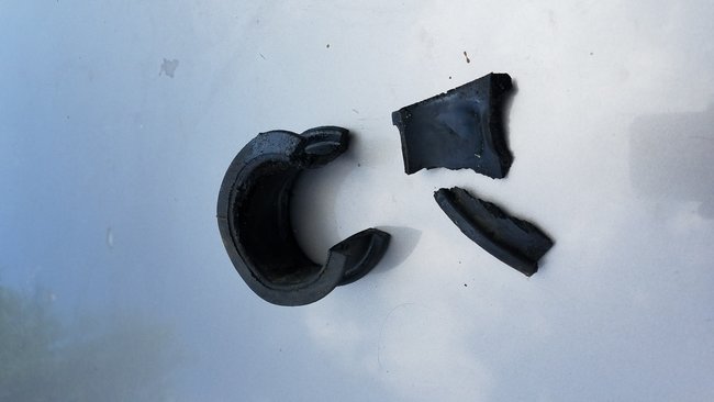

These are the best pics I could get. I got the new bushings. What I need to know is, do I have to remove the rack completely, or can they be changed with the rack in-place?
Sunday, July 7th, 2019 AT 12:15 PM
052361
  • 98 POSTS

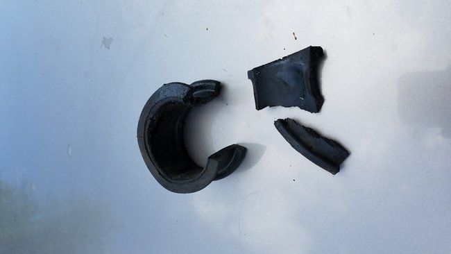

This is the way the bushing came off. The other looked new, after repairs, test drive showed the jerking was gone, and the rocking didn't start until over 65 mph.
Sunday, July 7th, 2019 AT 5:51 PM
  • 110,192 POSTS
Wow! That was bad. Is everything back to normal? That was actually dangerous. I'm glad you spotted it.
Sunday, July 7th, 2019 AT 7:29 PM
052361
  • 98 POSTS
No, it still rocks from side to side. But not at 40mpgs but something else. The bushing was oil soaked and soft and pliable, like foamb rubber instead of hard rubber.
