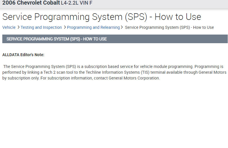

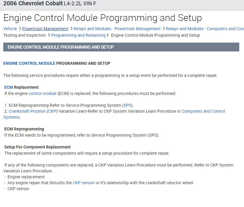

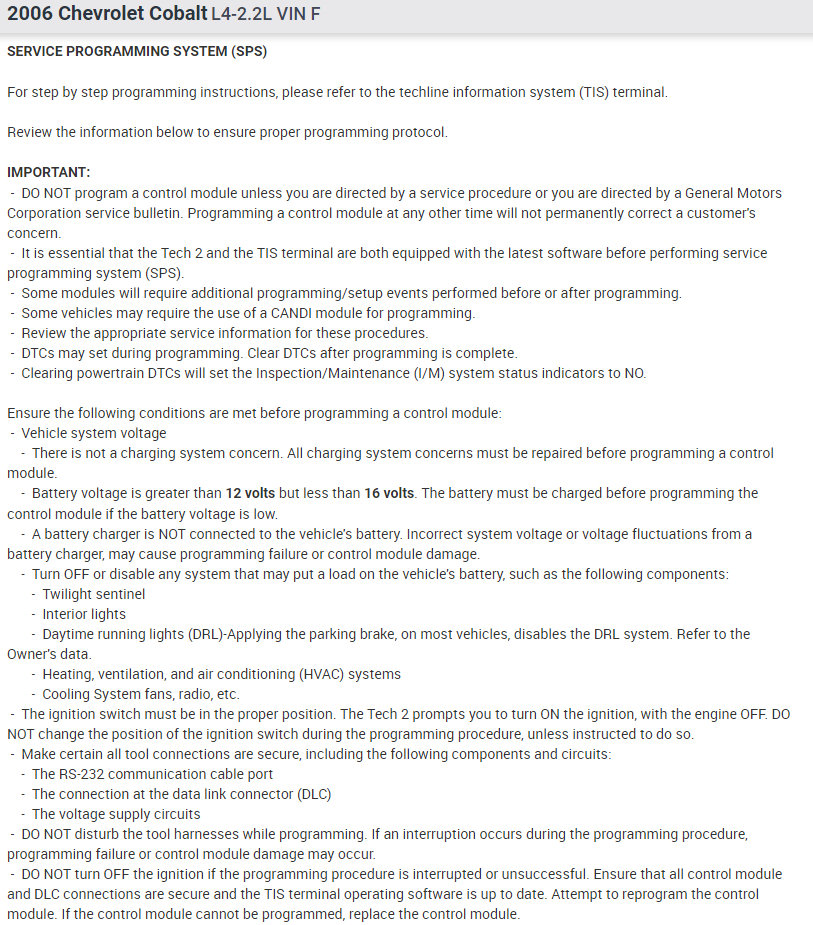

I have attached the programming and relearning procedures for your vehicle. Please note that you will need a Tech 2 Scan tool to perform the steps.
Jul 22, 2021 at 12:40 PM
SQM
  • CAR REPAIR CONTRIBUTOR
  • 6,383 POSTS
Jus saw your follow up question.
The MAP sensor replacement does not require resetting of the ECU.

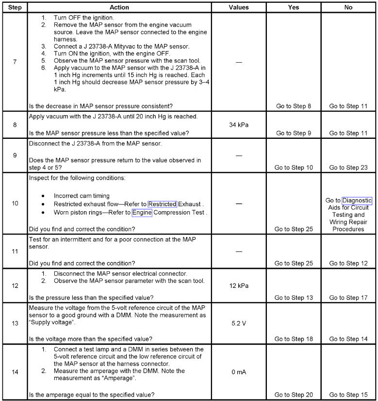

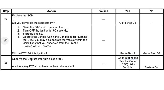

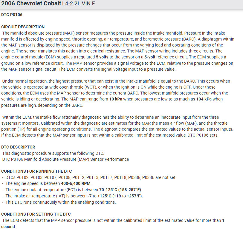

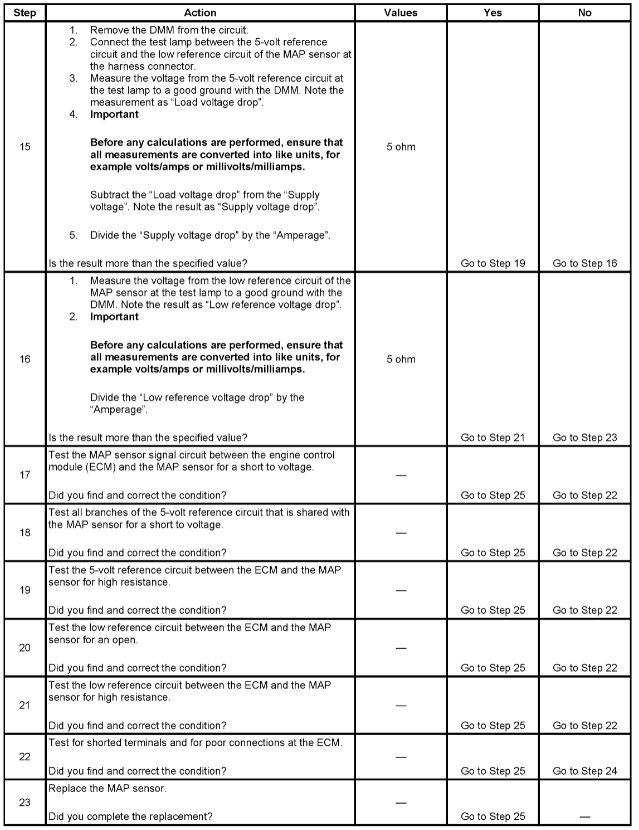

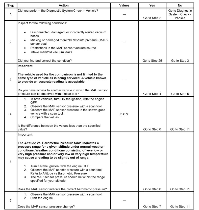

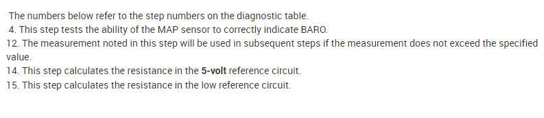

Many times that MAP sensor codes come up for other related issues.

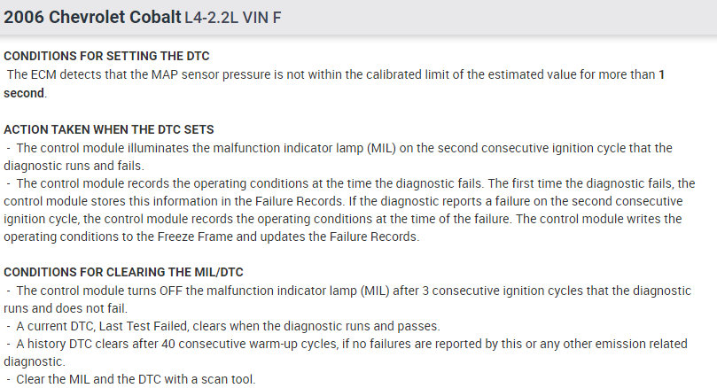

I have attached the complete diagnostics for that code, including step by step guide.
This should help you figure out the issue.
