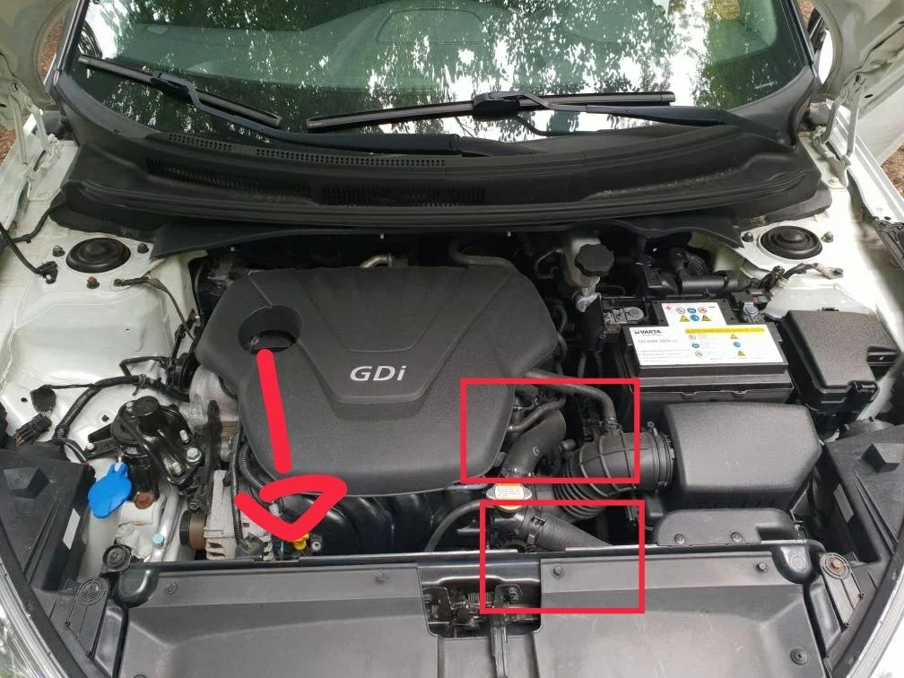

I have a problem, the radiator hoses after getting to normal temperature gets hard you can feel that there is a pressure in them and a bit hard to squeeze the upper and lower one before that I had a temperature rise before the h by one line and I changed the coolant and do a flush using a quicker city radiator flash and distilled water and after that i fielded it up with 50/50 coolant and purged the air from the system and changed the thermostat and the radiator ca. the temperature is okay after doing all of this on the obd2 scanner it gets up to 96c Max and the fan works and get it to 84c. when on load the temperature rise on the obd2 scanner up to almost 97c no load it's okay on the dashboard the temperature gauge is fine and where it is always been with either load or not it's the same. No lose of coolant no smoke form the back no oil and coolant mix, only high pressure in the radiator hoses and you feel it hard, so what may the cause of high pressure in the radiator hoses? And I am a bit scared that due to the pressure the coolant hoses get lose or something. Also when I open the radiator cap when hot no sound of air coming out or anything and when I open the cap and let the car idle no bubbles and nothing only the water rise up and start to spill. One of my friends told me it might be the head gasket or the engine block I don't know.

Thank you very much Alex for keeping up with me. Regarding the thermostat I did read your message and went to test the thermostat.
What I did is this the car is overnight cold I did top up a little bit of the coolant in the tank less than 30ml. I started the car and let it warm up without moving the hoses get hard as usual. I will attach a picture of the hoses the ones with a rectangle are hard and hot after some time the one down with the arrow it's down where the thermostat is connected is hard, but not hot. i lit the car warm up to temperature up to 83c on the obd2 scanner and still the the houses with the rectangle hard and hot and the one down hard but not hot. i did move with the car for a test drive for 3 minutes and parked check the hoses the ones with the rectangle are still hard and hot the one down are hard and hot now. so I don't know but this means the thermostat did open right? And the coolant is flowing right? But still the houses are hard. Let's say that the thermostat is bad or something wouldn't I have a overheating issues? I don't at all after I changed the thermostat and did the flush and changed the coolant and changed the cap I don't have issues with overheating.

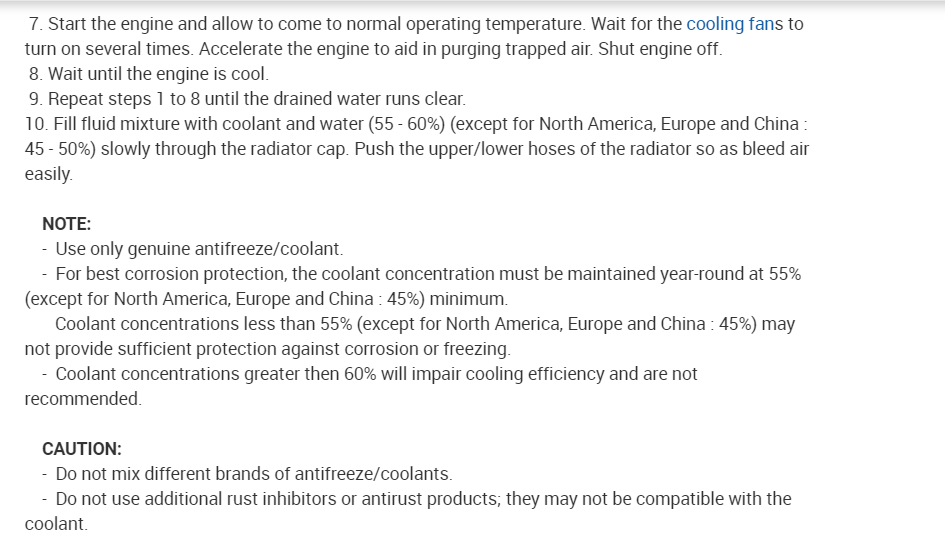

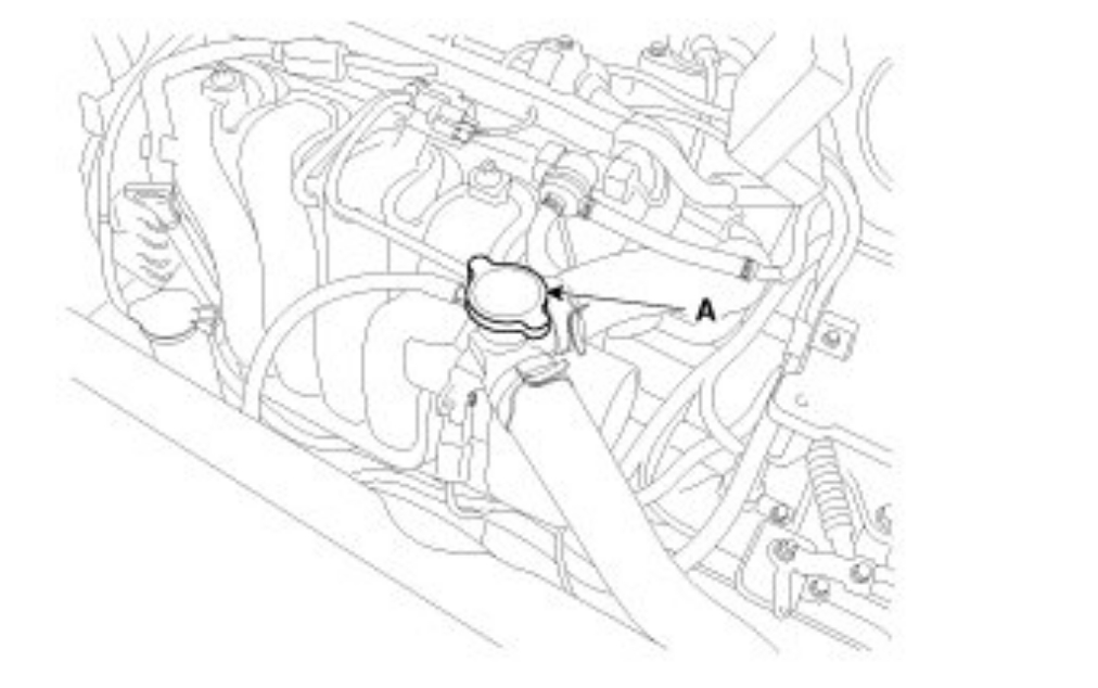

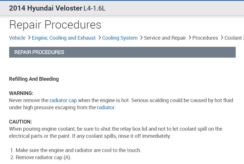

Hello again,

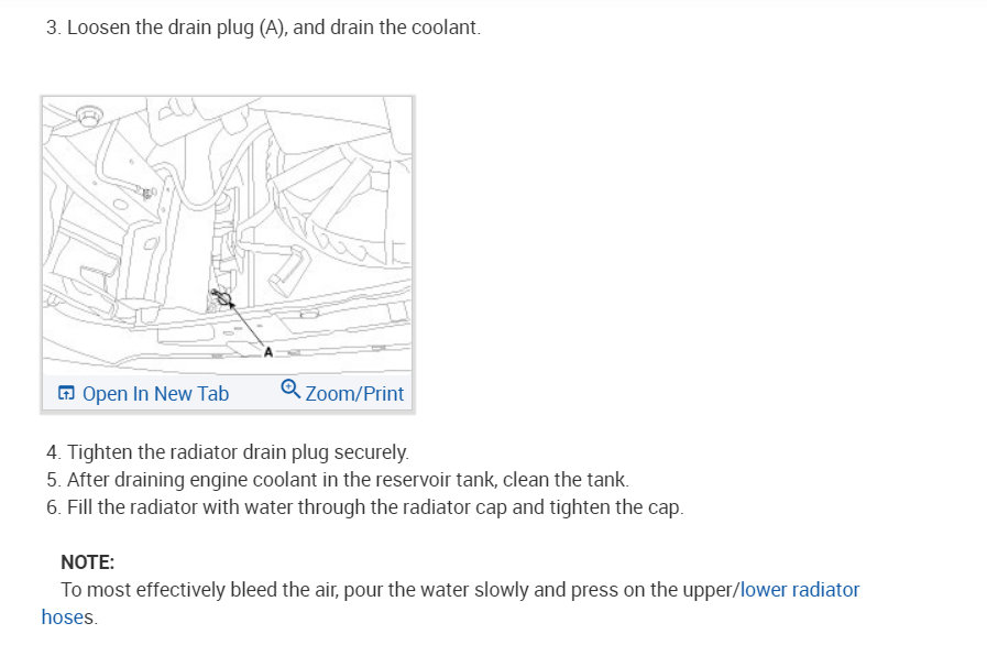

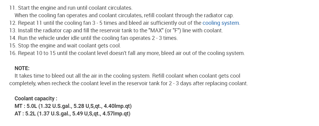

Well it sounds to me like you have done everything that is normally done in the maintenance of a cooling system, save replace the water pump and heater core, but neither of those are the issue. If your vehicle isn't overheating then this might be normal. the only other thing that I could think of was maybe they gave you the wrong pressure for the radiator cap. In the diagrams down below I have included the draining and filling instructions from the factory. You might also want to double check the concentration of the anti freeze. Please go through this guide and get back to us with whaou are able to find out.

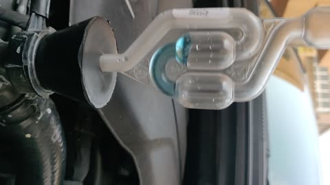

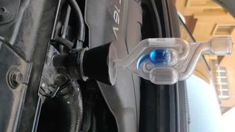

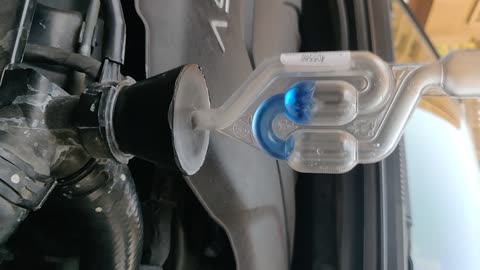

Sorry for the late reply, I was waiting for the tester to arrive. Regarding the points you mentioned, the car it's not overheating at all in city driving, traveling for long distance I don't know if it's going to overheat or not because I didn't travel but in city driving and highway no overheating at all. Regarding the cap I did check and it's the right specs as the old one exactly rated 1.1. Now for the test I didn't buy the one that you guys told me to do because it didn't have an international shipping on it. So I bought another one from eBay and this is the link for it:
https://rover.ebay.com/rover/0/0/0?mpre=https%3A%2F%2Fwww.ebay.co.uk%2Fulk%2Fitm%2F323505216857

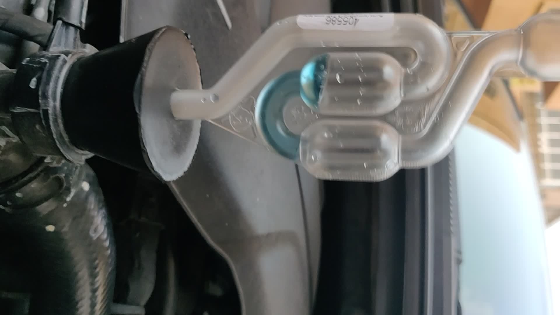

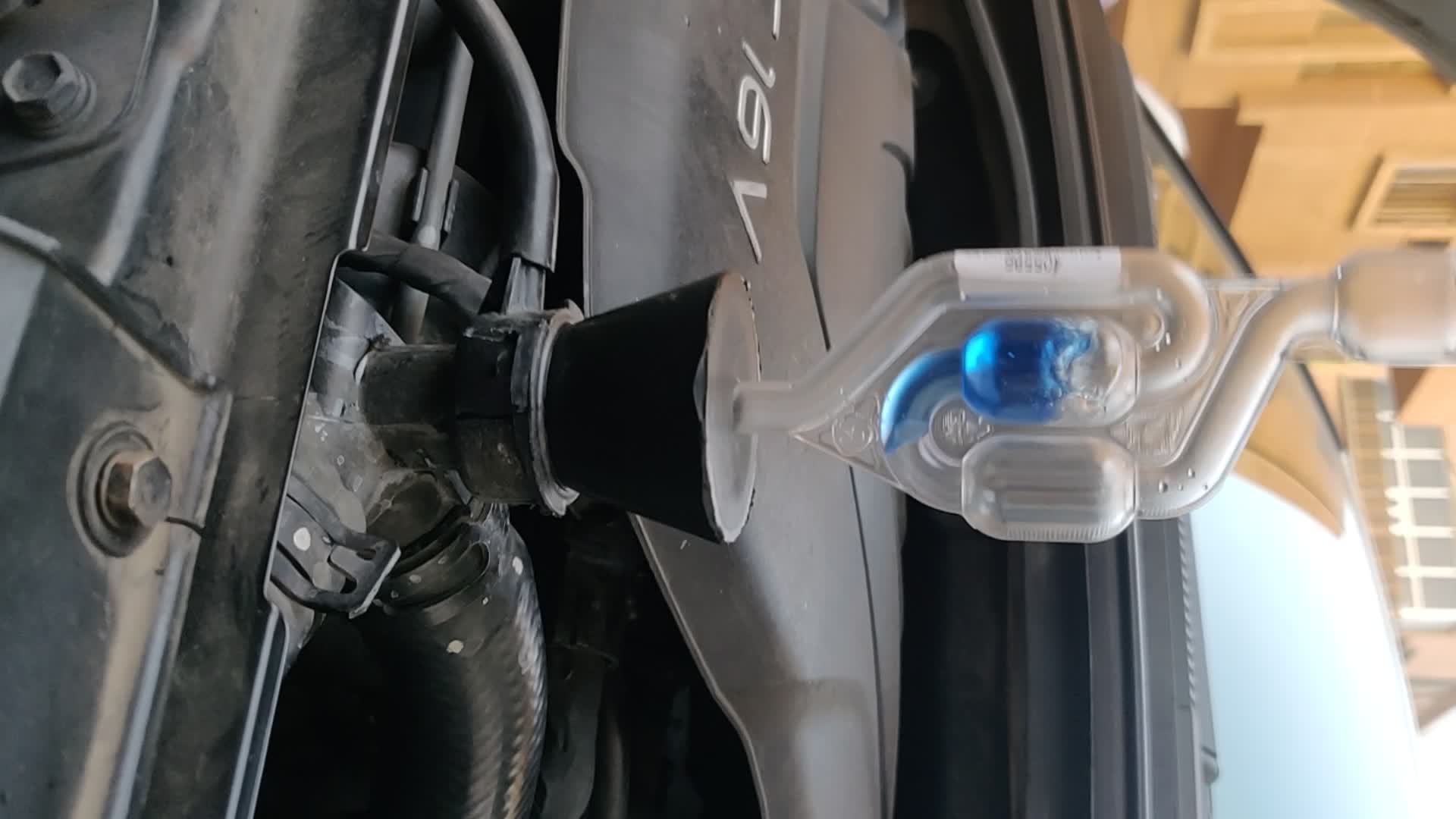

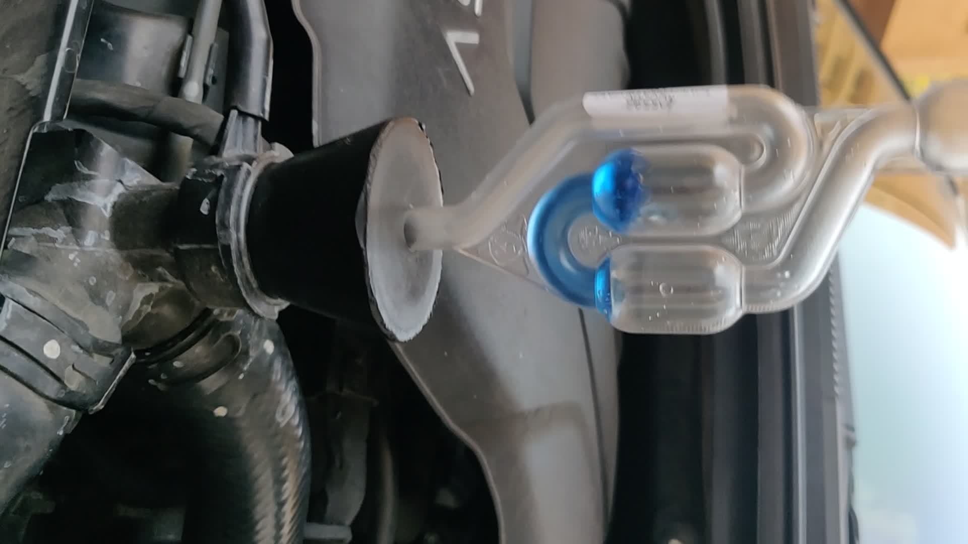

It did arrive and I did the test, the results are, I did the test following the instructions for the first 10 mins the color was dark blue ( same color from of the test fluid ) even with revving the engine couple times, after 10 mins and exactly when I hit the 14 mins mark the fluid color changed to light blue, I don't know what this means, I did test the fluid with the exhaust and the color changed to yellow in less than a minute, so is this means I have a really really small leak or because the fluid was exposed to the air around the engine for long period it changed to light blue I am sure what you guys think about this? And what is the meaning of light blue color?

TIESTO870
  • 23 POSTS
The first video is at the beginning.
The second one at the 9 minutes.
The third one at the 14/15 minutes when the color changed.
And a clear pictures of the color change to bring blue.

SCGRANTURISMO
  • CAR REPAIR CONTRIBUTOR
  • 4,897 POSTS
I'm not sure what it means when it turns blue, but given the fact that it didn't turn yellow and that your vehicle's age isn't that old, you don't have a blown head gasket or cracked cylinder head or block. So you can rule those out. If your vehicle isn't overheating, then this is probably normal behavior for your vehicle.
