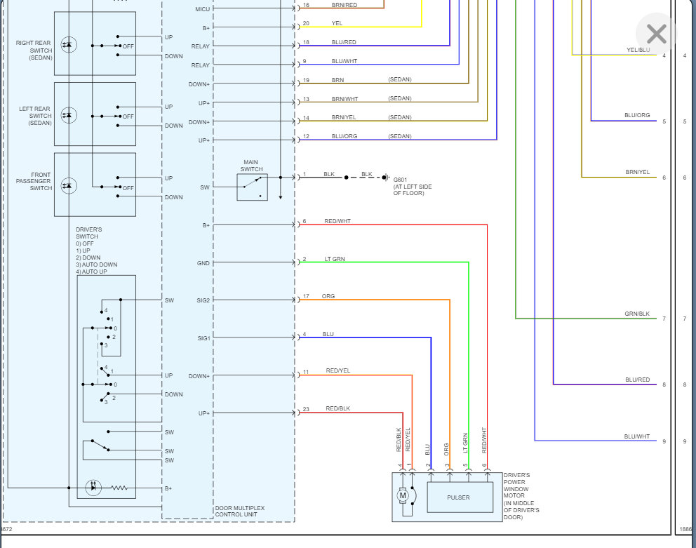

The previous owners stated that they would work sometimes then other times they wouldn't. Can you please tell me how I check the motors, or would it even be possible to be the motors? The driver side master control works everything the window locks mirrors and the passenger side window. When you press the button for the front and rear driver side windows u can hear a clicking sound. I also have a radio issue you can get in the car and turn the key to the on position and power the radio on but there is no sound whatsoever coming from the speakers and the radio is powered on.
Jun 25, 2022 at 11:07 PM
  • CAR REPAIR CONTRIBUTOR

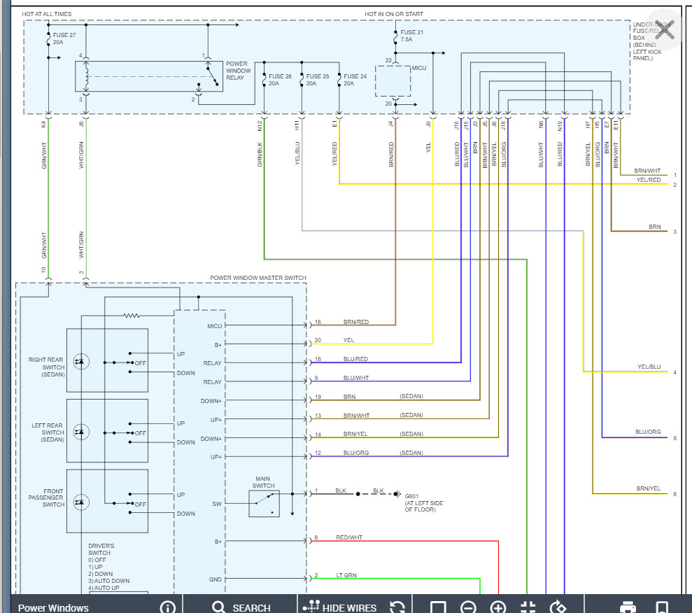

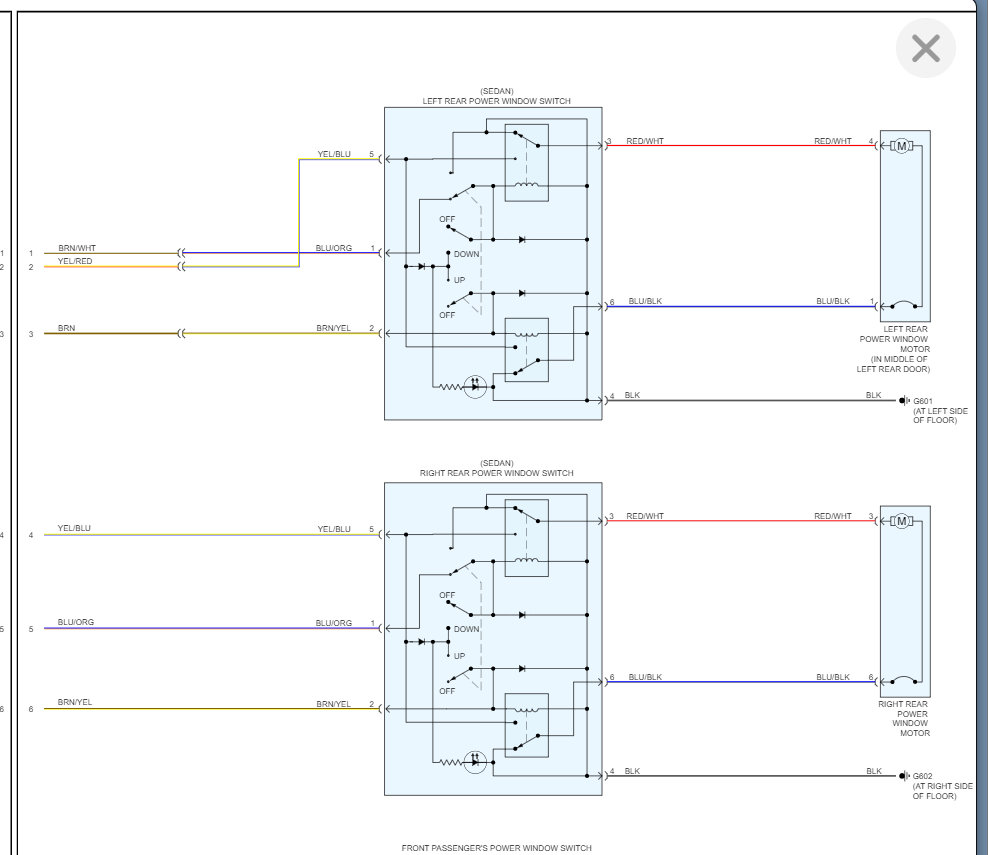

Even though the driver window switch works for everything else, this is still likely a switch issue.
Basically, the switch can fail at times, and it causes the circuits to back feed through the switch and then the relays just click in the rear door or front door.
The way to confirm this is to check the power at the window motor and the rear door switch to find out what we have.
Then we can track the power coming into the switch and if you have it going in but not out then the switch is the issue.
Take a look at the diagrams below and let me know if you have questions but if it were me and you have power going into the driver switch, I would replace it and retest.
