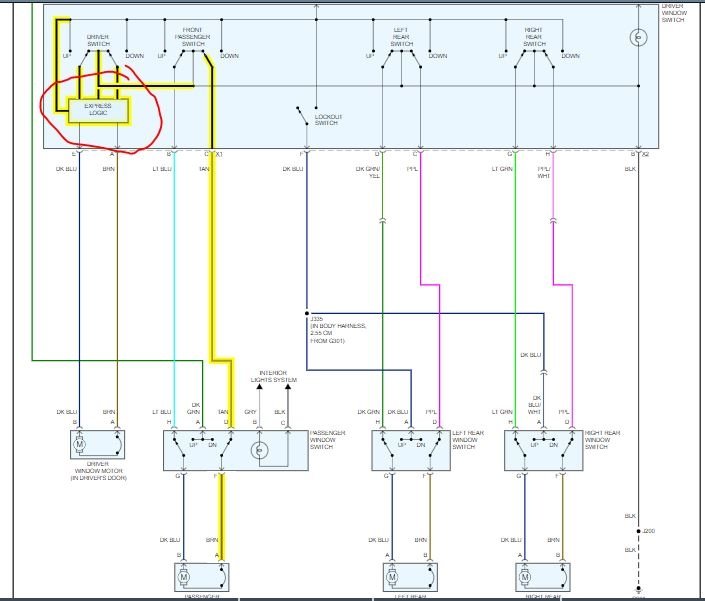

Hi Roy, I'm back. I got a new multi-meter. With the passenger door switch down, the meter reads about 12.22 volts. It does fluctuate a little bit. With the passenger door switch pulled up, the meter reads 0.00. Does this suggest anything to you?

We can test this simply, remove the wiring connector from the motor dark blue and brown wires, then attach a test light between the two. Work the switch both directions does the test light light up in both directions? If so the motor is bad even though it runs on the direct battery I have seen them stop when installed.
Tuesday, August 25th, 2020 AT 4:17 PM
DJMARSOLEK
  • 21 POSTS
Hi Ken, thanks for reaching out. I did as you directed. The test light only goes on when I push the passenger door window switch down. It stays off when I pull that switch up. It also stays off I move the drivers door master switch up or down. This baffles me because that switch still lowers the window.
Wednesday, August 26th, 2020 AT 12:51 PM
Okay, when you command up does the tan wire have power?
If it does, it is not being grounded by the master switch. That would indicate a bad master switch.
Wednesday, August 26th, 2020 AT 1:05 PM
DJMARSOLEK
  • 21 POSTS
Just to be clear, are you talking about the brown wire (looks dark grey to me) that goes to the motor from the passenger door switch? I checked for power there and got nothing when I pull the passenger door switch up. I'm little confused because there is a tan (light brown?) Wire in the bundle of wires that come into the passenger door that goes into the connector for the passenger door switch.
Wednesday, August 26th, 2020 AT 2:26 PM

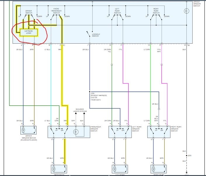

Okay, when you command up, the dark blue wire is hot and the brown is a ground. That brown goes through the switch and turns into the gray wire which goes to the master switch and inside the switch is the solid state set up that spins the motor in the correct rotation based on the command.
I attached that diagram.
Wednesday, August 26th, 2020 AT 2:41 PM
DJMARSOLEK
  • 21 POSTS
So I activated the driver's door switch up (and down) and there is no power at the tan wire that goes into the passenger door switch. I tried the same thing with the light blue wire on the passenger door switch connector. There light blue wire gets power with the driver's door switch pulled up, but not when the switch is pushed down. Is the driver, s door switch the problem? Thanks
Wednesday, August 26th, 2020 AT 3:50 PM
Yes, based on those tests, yes, I agree.

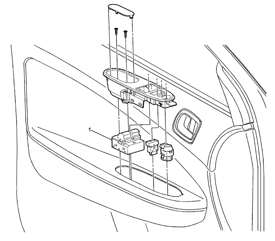

Ok so this was a super helpful thread! As a female a lot I can’t do on my own but I am having the exact same issue! I can’t test it myself I don’t have a meter or anything but every video I have watched points to master switch. Drivers side works fine but passenger only goes down with either switch ( master or using passenger switch) However it won’t go back up. So now it’s stuck 1/3 of the way down. Anyway, that was my burning question before I ordered a new switch. So even if both sides work going down and not up that the problem still lies in the master switch

Yes, that is completely possible because the main power for the system comes from the main switch. Here is how to change the main window switch out. Check out the images (below). Let us know if you need anything else.
