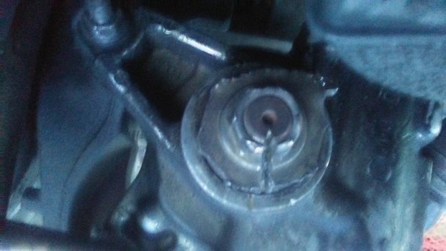

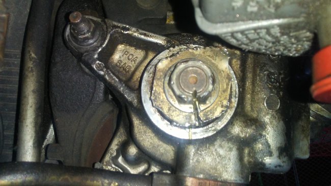

My power steering pump pulley snapped while I was driving and now I have no idea how to get it off. Please any suggestions are needed. Here are a couple pictures for visual:

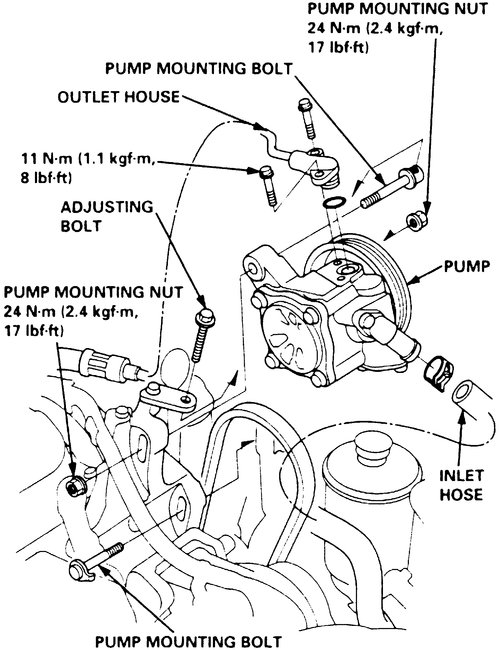

Here are the directions specific to your vehicle for removal and replacement of the pump. The attached picture correlates with the directions.
_________________________
1996 Honda Accord Sedan L4-2.2L SOHC (16 Valve)
Removal and Installation
Vehicle Steering and Suspension Steering Power Steering Power Steering Pump Service and Repair Removal and Replacement Removal and Installation
REMOVAL AND INSTALLATION
1. Drain power steering fluid from reservoir.
2. Loosen power steering pump adjusting bolt, mounting bolts and nuts, then remove power steering belt.
3. Cover alternator with shop towels to prevent damage from spilled power steering fluid, then disconnect inlet and outlet hoses from power steering pump and plug hoses. Take care not to spill fluid on body or parts. Wipe off any spilled fluid at once.
Fig. 6 Power Steering Pump Removal
Pic 1
4. Remove power steering pump mounting bolt, then remove power steering pump, Fig. 6. Do not turn steering wheel with pump removed.

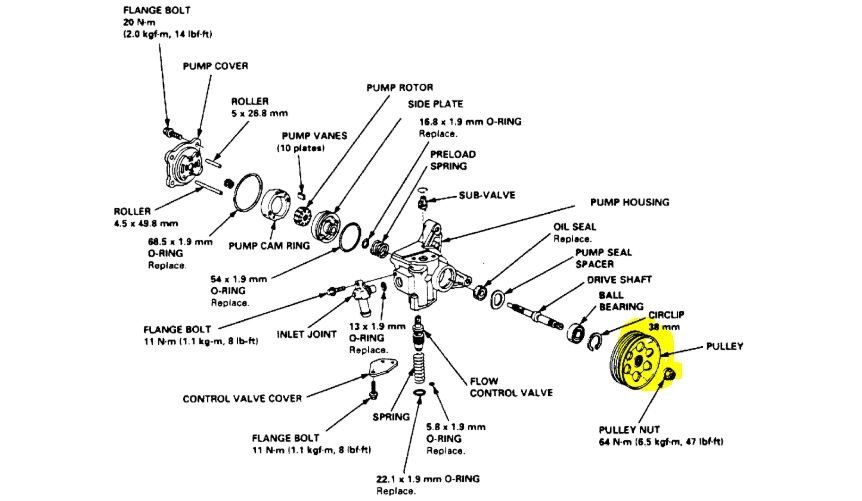

All you need to do is remove the nut at the end of the pump shaft. The remains of the pulley should come off. If it doesn't, you will need to get a puller to remove it. Then simply reinstall the new pulley, and tighten the nut to the specs listed in the picture. See picture 1.
Now because there is really no way to prevent the shaft from turning, you may have to use an impact gun to remove the nut, which is going to be hard with it still on the vehicle. Also, see if this link is at all helpful:
https://www.2carpros.com/articles/remove-reinstall-power-steering-pulley
Sunday, July 7th, 2019 AT 9:26 PM

Okay, so if I were to cut the nut and split off or would that hurt something?
Sunday, July 7th, 2019 AT 9:51 PM
  • 110,194 POSTS
Welcome back:
Sorry, I didn't get back sooner. As far as the nut, if you have a nut splitter, it shouldn't hurt anything. Just make sure not to damage the shaft.

No problem. The pulley just slips over the shaft which has splines on it. Align the splins and then simply replace the nut and tighten.
Here are the specs for tightening:
POWER STEERING PULLEY NUT
64 N.M (6.5 kgf-m, 47 lbf-ft)
Pulley Nut Torque Specification
Let me know if that helps. If not, please upload a pic of what you are having trouble with.
