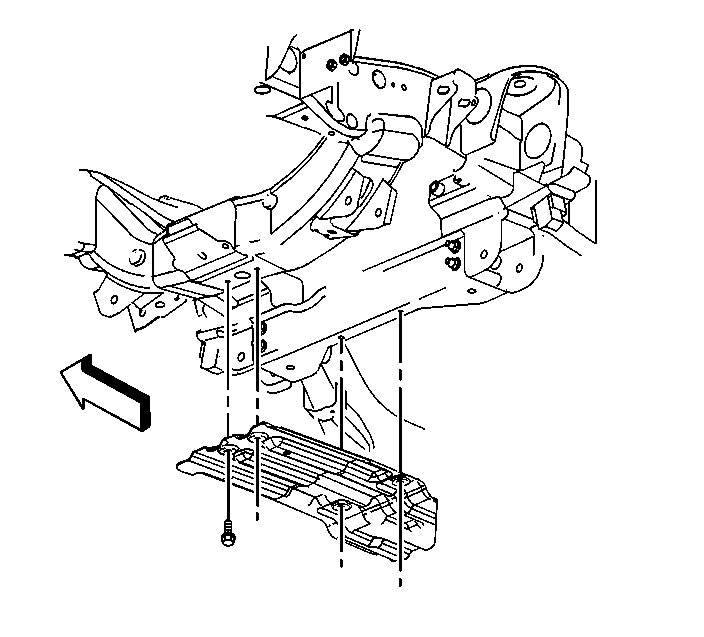

1. Remove the power steering pulley.
2. Raise the vehicle.
pic 1
3. Remove the oil pan skid plate bolts.
4. Remove the oil pan skid plate from the vehicle, if equipped.
5. Place a drain pan under the vehicle.
pic 2

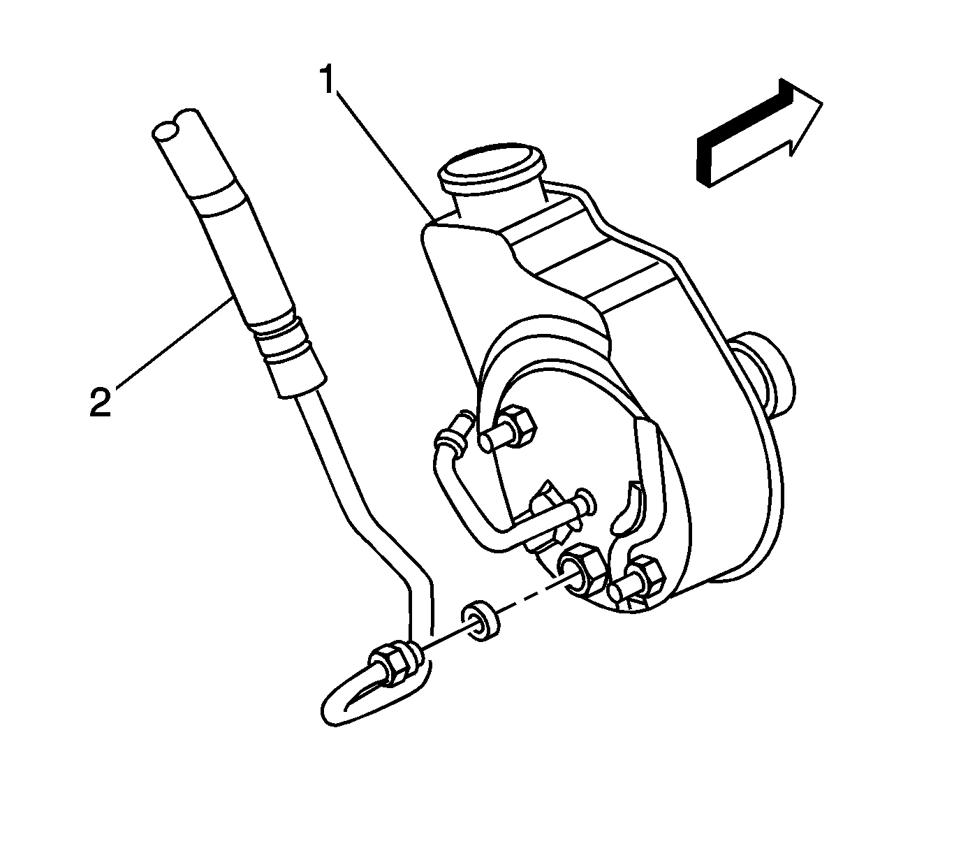

6. Remove the power steering pressure hose (2) from the power steering pump from underneath the vehicle.
7. Lower the vehicle.
pic 3

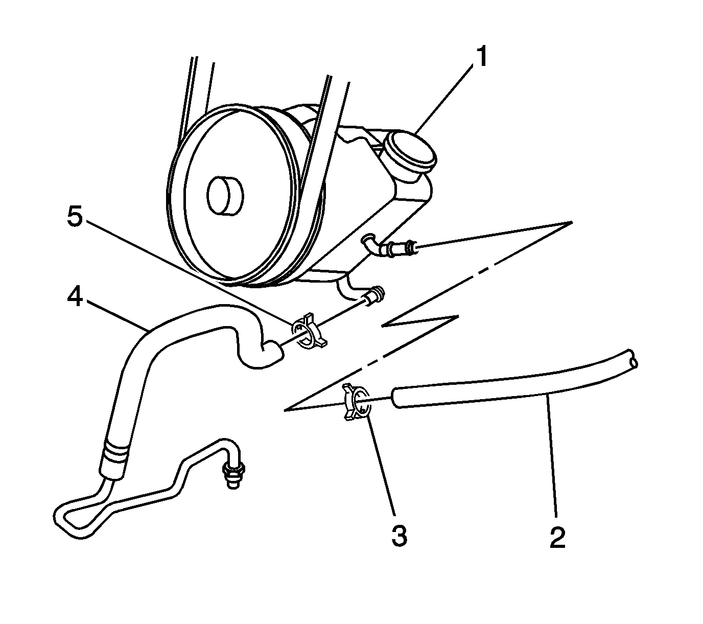

8. Remove the clamps (3,5) retaining the power steering return hoses to the power steering pump and remove the hoses.
9. Remove the lower intermediate shaft from the steering gear.
pic 4

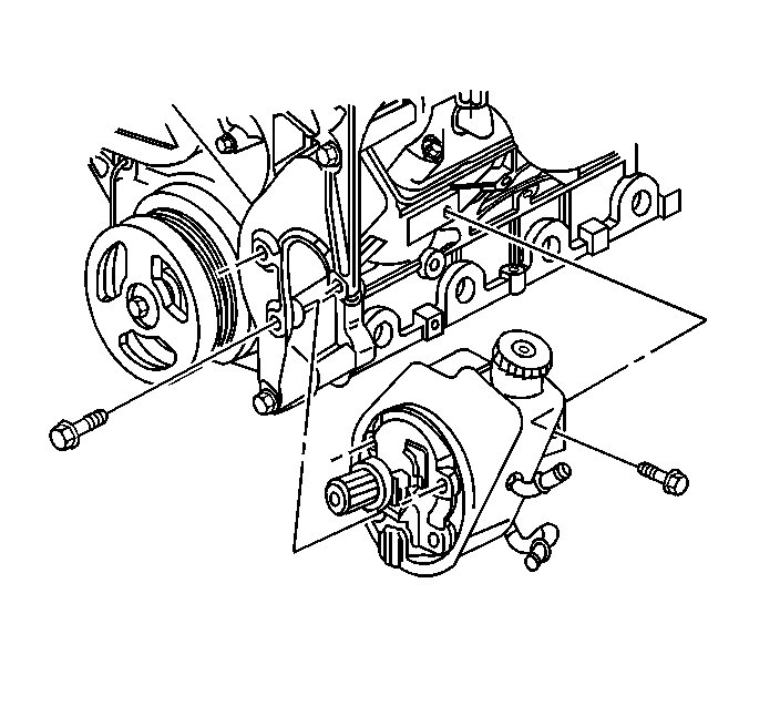

10. Remove the bolt retaining the rear bracket to the engine.
11. Remove the bolts from the front of the pump.
12. Remove the pump from the vehicle.
pic 5

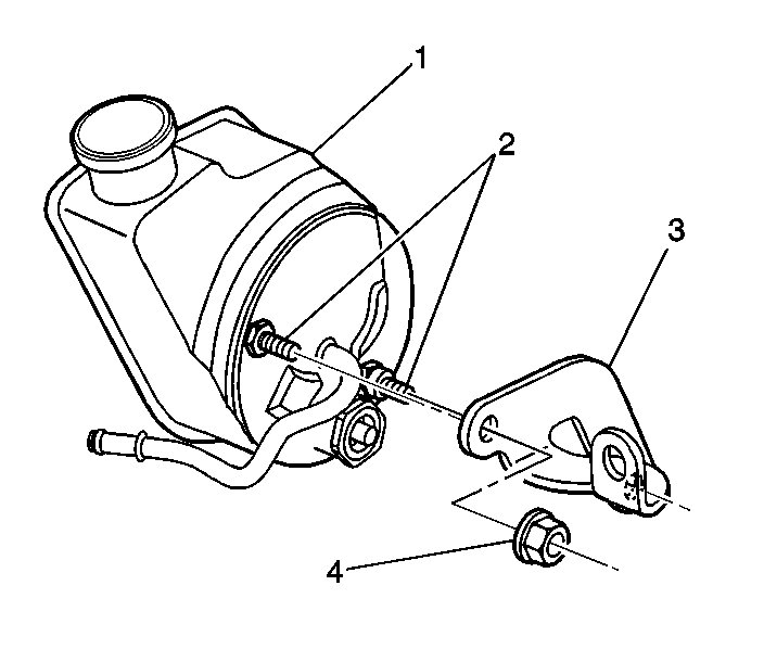

13. Remove the bracket (3) from the rear of the pump (1).
Installation Procedure
pic 6
1. Install the bracket (3) to the rear of the pump (1).
^ Tighten the rear bracket retaining nuts to 50 Nm (37 ft. lbs.).
Notice: Refer to Fastener Notice in Service Precautions.
