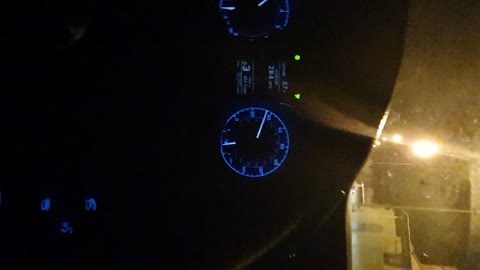

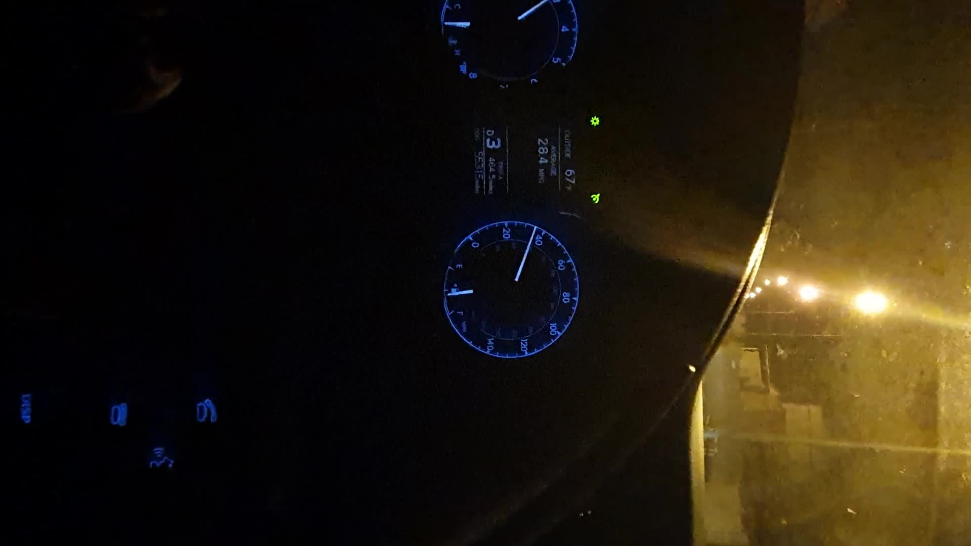

Hello Ken, sorry but this is the best I could do but I think the sound of the pop is clear. It popped after the first down shift, that was considered a light one to, sometimes it pops louder and more than one pop, like two to three pops at once.
Let me know if you need another video, I'll try to get one from outside the cabin.
Monday, November 25th, 2019 AT 7:50 AM

I thought I would Chime in here. Can you tell me if this vehicle always did this or has it slowly developed this sound over time? Quite honestly to me its sounds like a little unburnt fuel making it into the exhaust system and finding enough air to cause it to combust making that popping sound.

Ah I see now! okay then! Actually then (to me as a performance guy) I see this a lot and quite frankly most performance guys out there actually want this sound! It is quite normal really. I suspect that since you started using the paddle shifters you began noticing this because the automatic downshifting of the transmission was preventing that from happening.
Here is a video of some other vehicles making this noise (only more prominent):
https://www.youtube.com/watch?v=IYpdoOsD8_Y
Does this sound more like what you are hearing?

Yes, it's normal. Fuel consumption? If you drive a little sportier, you'll use a little more fuel, but you'll have fun with it. :)
