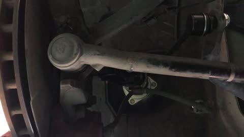

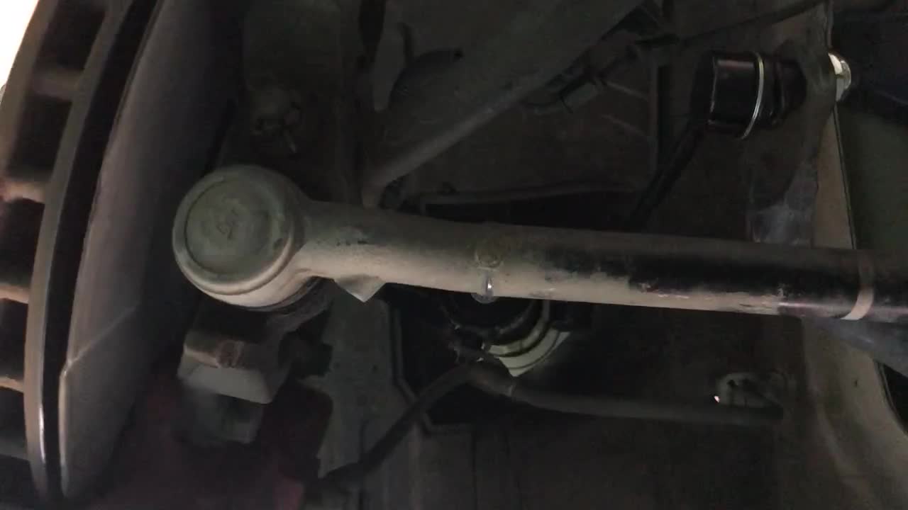

I recently lowered my car on new coil-overs and I replaced my drivers side tie rod (inner and outer) because it was no good anymore (tire place said they couldn’t align it until I swapped it out). After all that I took it in for a wheel alignment and almost immediately after that (like the next day) I could hear a popping noise from the passengers side wheel area but only when turning hard (like backing into a spot) so I took it back to them and they checked everything over and said it was all safe and that they weren’t able to replicate the noise. Over the next week or so it has been getting a lot worse and now it makes that noise constantly even when driving straight. The only time it isn’t making the constant popping noises is when I’m at freeway speeds, if the road is super smooth or if I am stationary. I’ve tried to replicate the noise on jack stands to try and figure out where it is coming from but no luck. I can’t find anything obvious that is wrong or loose. Any suggestions on what to check?

I have it on stands right now (on the frame itself) and when I spin the steering wheel back and forth (full to one side then the other) I can occasionally hear that same noise. I got someone else to spin the wheel while I was next to the area that the sounds is coming from and I am almost certain that it is something to do with the coil-over strut, but I cannot see anything wrong with it.

That pop sound right at the beginning of the video (right when the wheels get straight) is what I’m hearing while driving but extremely frequently on semi uneven roads and corners mostly at lower speeds like 40-50km/h. I’m not sure if that video helps or not though.

I appreciate the long reply, lots of useful information in there. My friend is a mechanic and I got him over to help me diagnose it. We went for a drive as it happens almost constantly while driving around. His best guess just from the noises made during the drive was a bad end link. He said he’s going to have me come over hopefully this week to take it apart and look it all over and figure it out. His brother has the same car as me And same coil-overs and his is practically scraping on flat pavement it’s so low and he hasn’t run into any issues yet. Fingers crossed on a fix soon.

Clearly that is a little hard to tell but if you can get it to do it on jack stands just turning the wheel then I would agree with what your friend is saying. However, I am wondering if you put the jack stand on the lower control arm if the noise would be louder while testing it like this. The reason is, when you have the jack stand on the frame, the suspension is unloaded and "hanging" down. When you put the jack stand under the control arm you are putting the load/weight of the vehicle on the suspension as if it were sitting on the ground.
Does this make sense? Either way, let us know what you find this weekend. Thanks

Hey, so I swapped my end-links (put the driver side to passenger and vice versa) to see if the sound would switch sides also (meaning that the end link would be the problem if so) and after swapping them and going for a test drive around town the noise is gone. Now I’m not sure if it’s permanently gone or not yet I’m going to give it a few days and see if it returns before I celebrate too much, but if it doesn’t then maybe it was something simple like the end link wasn’t properly installed the first time? I’m not really sure to be honest but I will keep and eye on it and if it comes back I’ll make another comment. I appreciate all the help!
Thursday, July 23rd, 2020 AT 9:04 PM
So the choice is yours at this point. Either replace them or leave it until there is an issue. I would normally just leave it be if there is no issues and when there is one to address, you can address it then. That is just me and I agree that most likely it was not installed properly.
