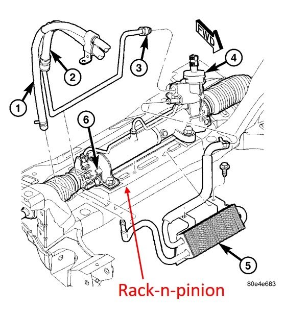

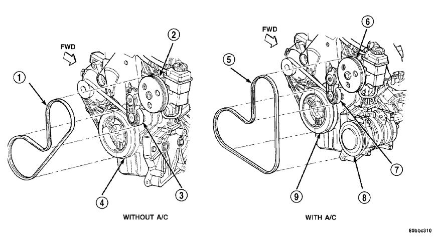

Driving home from work this morning my car made a pop sound then the steering became difficult to turn. What could it be? It was making a humming sound on start up and a popping sound on a left turn.

The belt that drives the power steering also drives the AC. So unless you were running the AC this time of year or turned it on that would be an indication. The best way is to look. I attached a picture of the belt and the water pump is number two and six depending on if you have AC.
If there is no leak then it may not be a blown hose. Another possibility with the miles you have is internal failure of the rack-n-pinion. I attached a picture showing it is number six.
I hope that helps, without a visual I am only guessing. I also do not want to be doom and gloom, but those are the possibilities based on what you have said.

If the AC was working same belt drives the power steering. The pump could be out of fluid even though you said no leak, it could be very low. If the belt is making noise it could be slipping due to the belt tensioner, that would not be too expensive.
