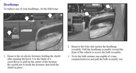

how do I replace the headlight bulbs in my car

My info shows this. Your owners manual should have some info on this?
