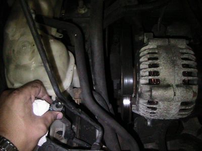

So, i've inspected the car again carrefully, i managed to get it started, the problem seems to be that the fan is not working now. it used to work, i recently checked it so now it didn't even crossed my mind that that could be the problem. i think it should be an electrical problem because it looks good, no dust and stuff, and it worked for almost 2000 miles great, so i don't know what happend all from the sudden to break it. i'll have to check in to it somehow :) i have like a small cable that's unplugged but i don't know if it should be or something because i don't see any plug. i've attached a photo of it in cas that i'm wrong.
https://www.2carpros.com/forum/automotive_pictures/219754_IMG_0335_1.jpg

Might want to investigate the coolant temperature sensor test it out cold and hot. Also if it has an engine temperature gauge switch. Could be that the computer is not receiving the signal and not energizing the fan relay or the fan itself is defective.

I haven't got coolant at all because my water evaporated somehow and the tank was empty. I don't have a coolant temperature sensor and neither an engine temperature gauge switch. I'm gonna buy some coolant and wait for it to get where it has to, maybe that will fix my problem. I can't understant though why it broke at first time and why I lost my coolant. I may have a tank problem or something like that, but there's no leak. I'm thinking about going to a mecanic and have him check it out, if the coolant won't do the trick. If u know any other solution or if can sugest anything else i'm "all ears ". I was also thinking about buying a motor for the fan, maybe it broke. I don't know though.
