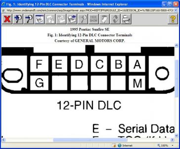

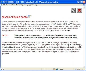

SATURNTECH9
  • 30,869 POSTS
https://www.2carpros.com/forum/automotive_pictures/416332_1995_pontaic_sunfire_DLC_1.jpg
https://www.2carpros.com/forum/automotive_pictures/416332_1995_pontaic_sunfire_DLC_part2_1.jpg
I posted how to get your code's without a scanner just jump terminal A to B and follow the instruction's.I also emailed you the instruction's.
